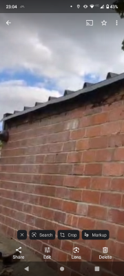

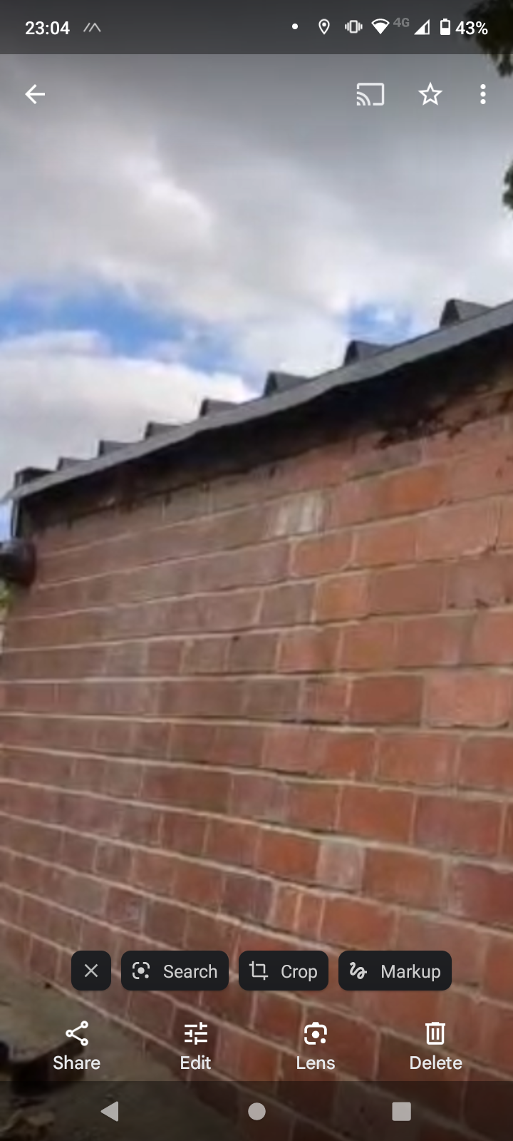

Well my dad cleaned out his garage gutters yesterday and the gutter fell off :lol: the barge board and "joist" that ties the roof sheets to the wall has rotted to the point you could see into the garage from the outside .. so that's this weekends task. :roll: ...
Old woods removed exposing the total (I'll self censor) :shock: flipping lash up done by a so called roofer about 7 years ago... .. new wooden joist fixed into place tonight and bonded to the brickwork (usually id screw it but thatd need the whole roof off) itll get some wall ties fitted in next week ..So tomorrow it's a 20 mile drive to a big roofing depot we use at work to get the correct components and put the mess right for him glad I'm reasonably handy :mrgreen:

Well a busy 24 hours
Last night resulted in 2x visits to b&q. Initially for 3x2.4m of 2x3 CLS treated dry graded this was cut to fit then bedded on pu foam adhesive to thr brick work as i couldn't fix from above / sideways.. short of stripping the complete roof....
My dad had already removed the pvcu facia and gutter we ripped the okd wood out ..
Quick measure we got some 3/4*3" to bring the gutter brackets out a bit...
£70 in wood and adhesive
Then this morning was a 40 minute drive to Stockton on Forrest to Jackson's roofing suppliers .. got some folded steel *drip" from the bargain bin £12 for 3m ...the last monkey to attempt to fit the roof had completely FUBAR this step and cut the important bits away leading to water getting between the roof sheet and the joists ..
got some 6" flanged strip 4 1/2" under with a 1 1/2" strip drip after a 30° ish down Turn into the gutter
So today we re fitted the uPVC board and gutter brackets to the new timber the shoved the new flashing up having added 2x beads of sealer .. cut new foam triangles for the ridges using a camping stove and wall paper scraper..(hot blade) and refixed the roofing sheet and drip to the beam and finally refitted the guttering..
I worked the past few years at work helping put up tin industrial buildings made of the same steel sheets for once my dad bowed down to my knowledge and let me crack on without questioning :lol: :lol: got to the roofing shop name dropped who i work for now scored a discount :mrgreen: still came to £140.. :shock: (sheet / screws / stitchers / caps / sealant/adhesive...
Hopefully that's a big job out the way. Dad's happy ... Mums happy I saved him from stress / falling off the ladders ...
