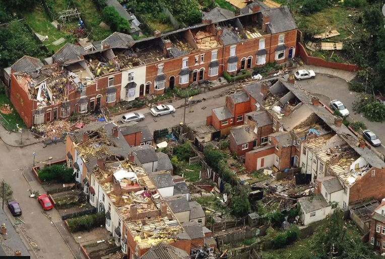

yep i could just place it at ground level its nice and easy but i want it as a safe haven, first tornado that happens past will just pick it up and toss it around like a match box........ and yes we do get tornados in the uk, google tornado kings heath birmingham, not a mile away from me, ripped rooves off and and threw cars about like confetti
