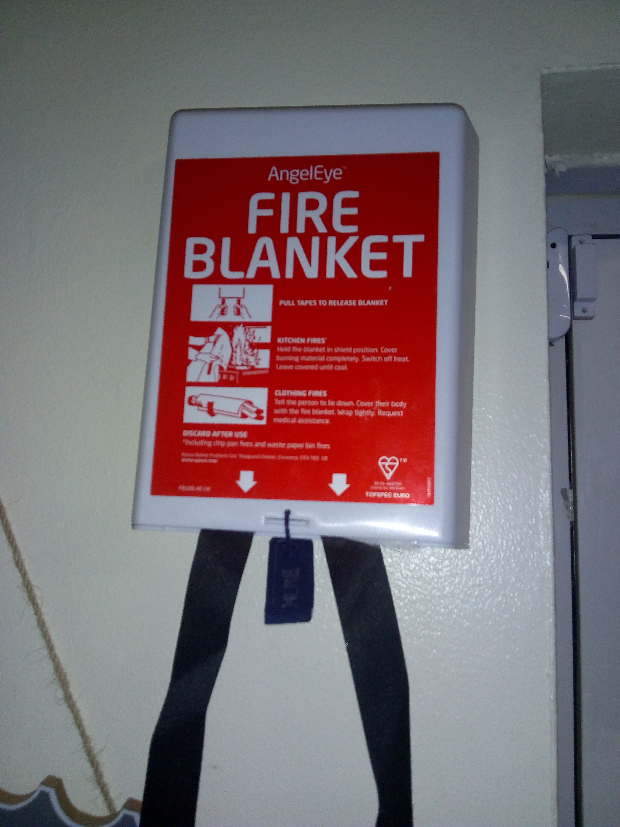

Well might as well share our homes precautions might give some members ideas likewise some might point my weeknesses.....
House is a "2 down 3 bed terrace" with small hallway and bathroom

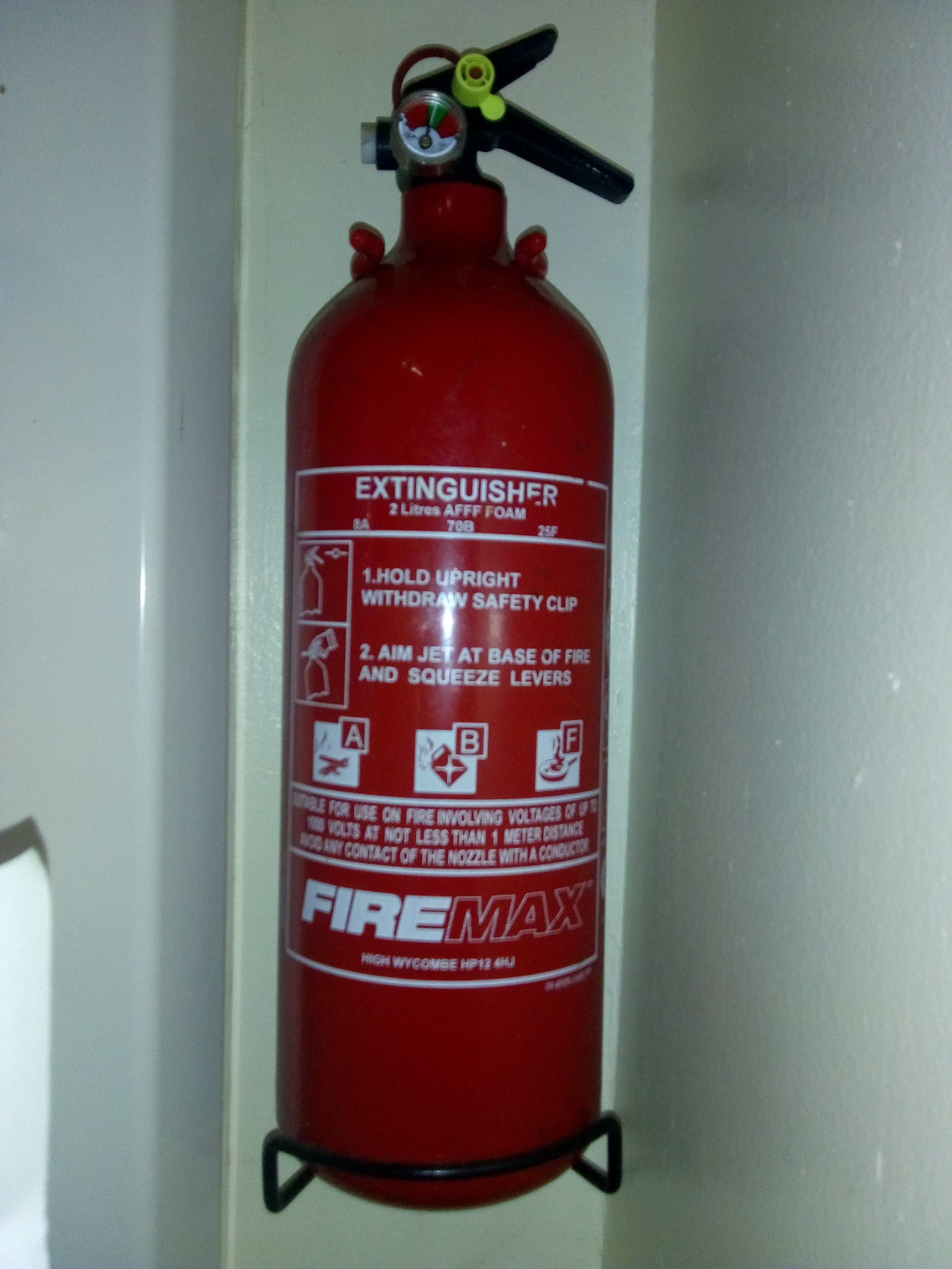

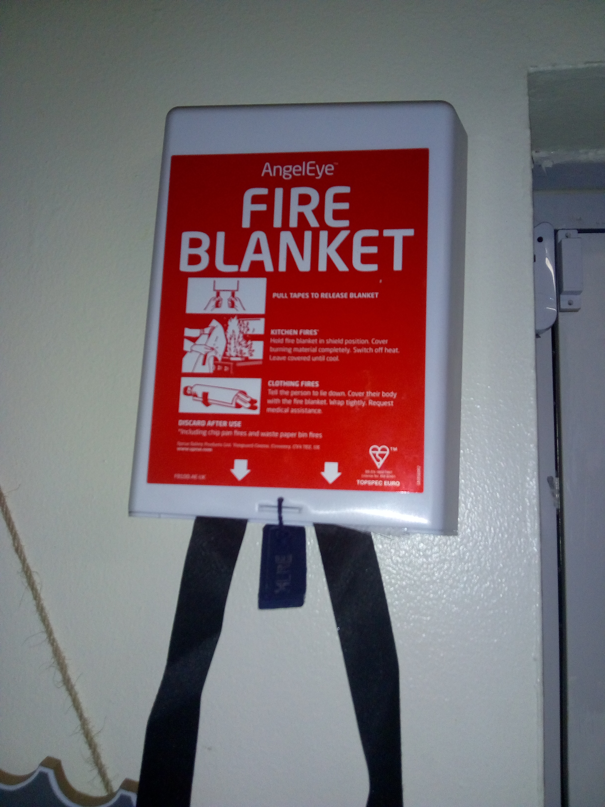

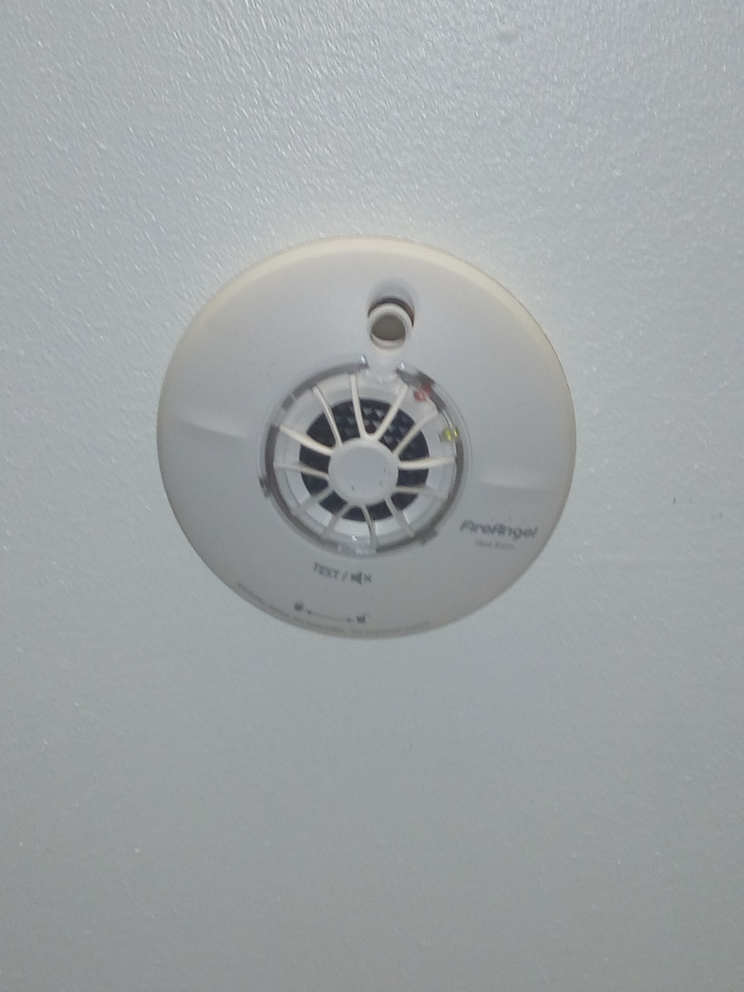

Kitchen
Bsi 1m square fire blanket

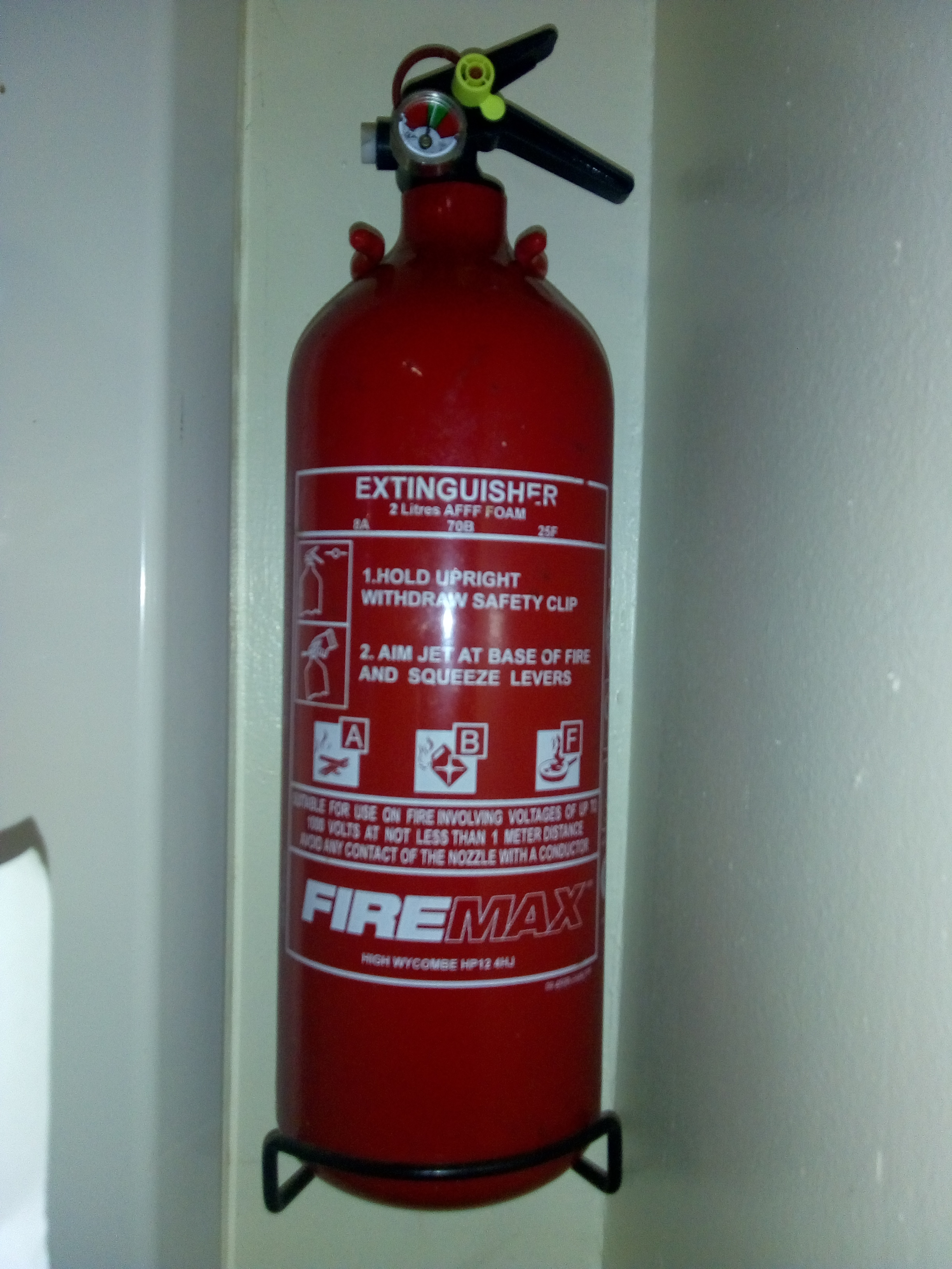

2l afff class ABF (CHIP PAN) fire extinguisher

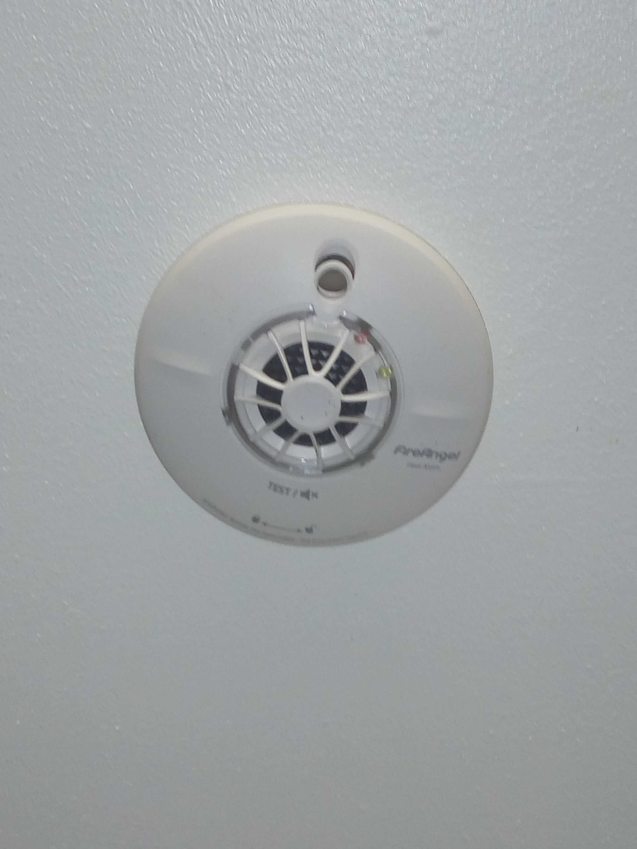

And a heat alarm

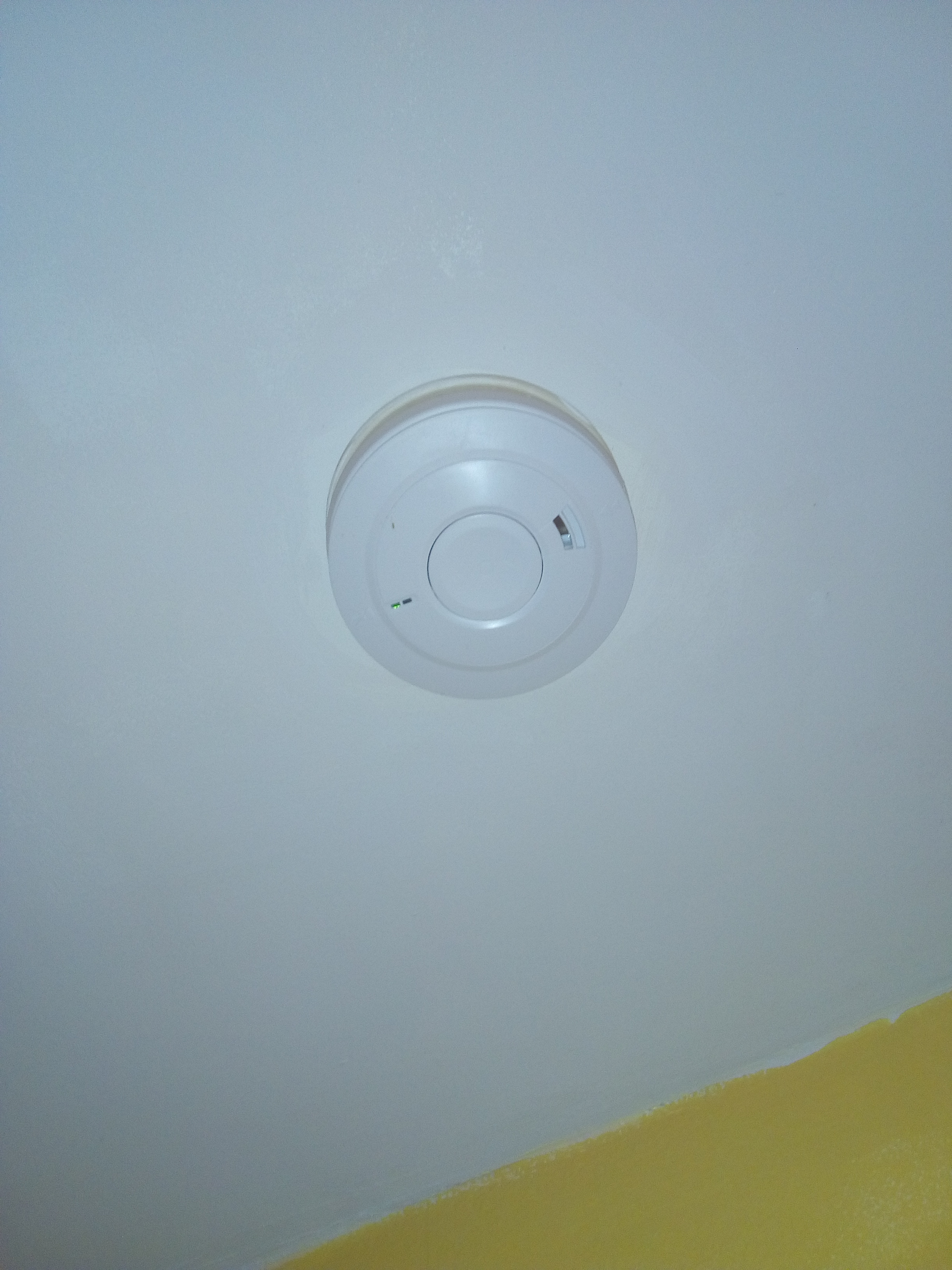

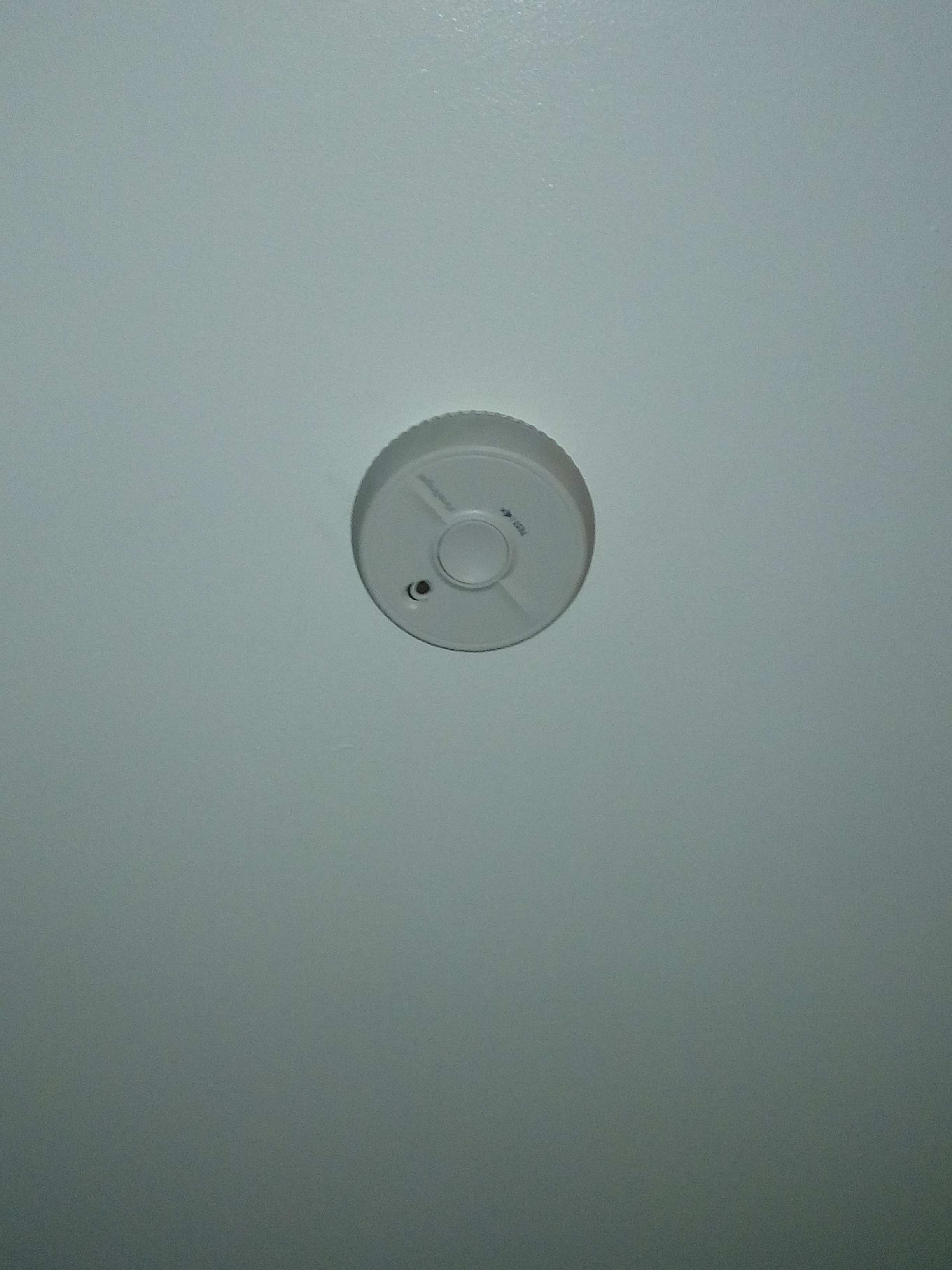

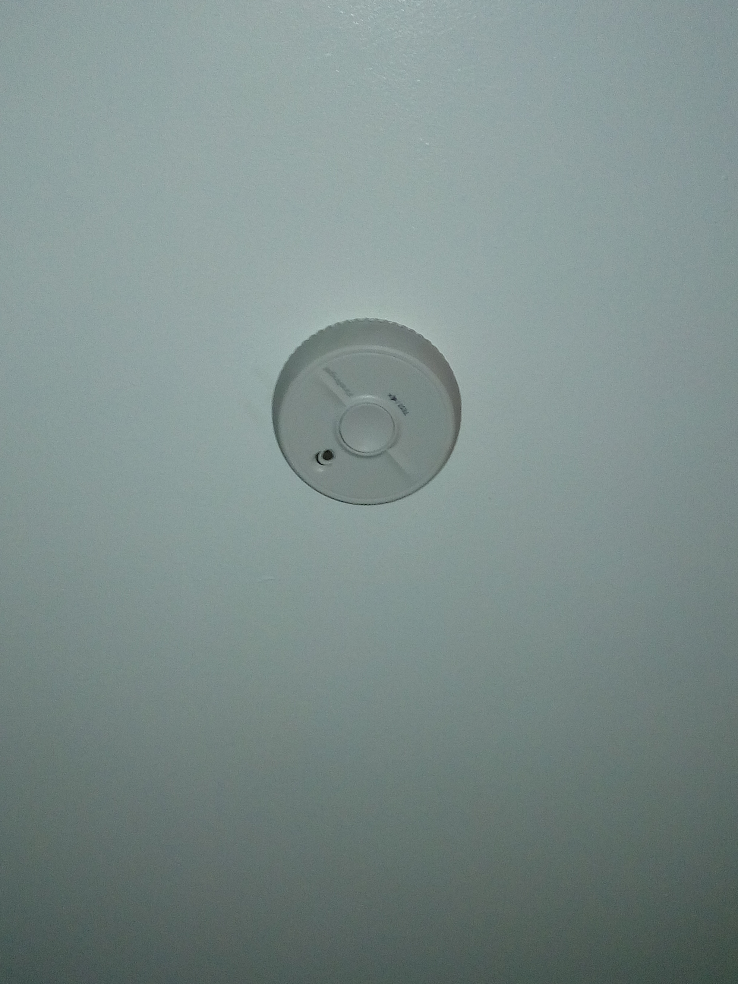

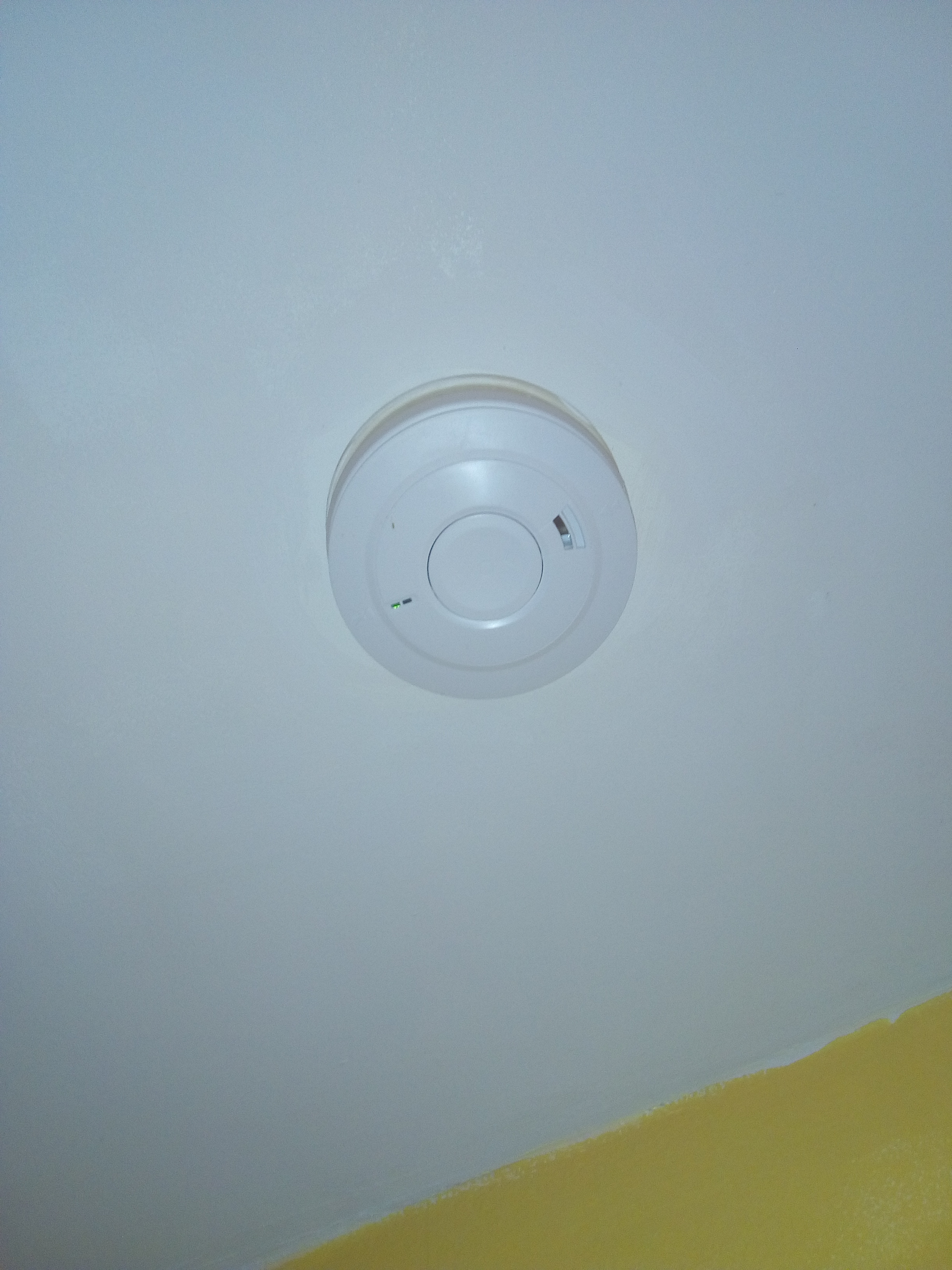

In the lounge there is a standard optical mains alarm with one on the landing upstairs which are interconnected

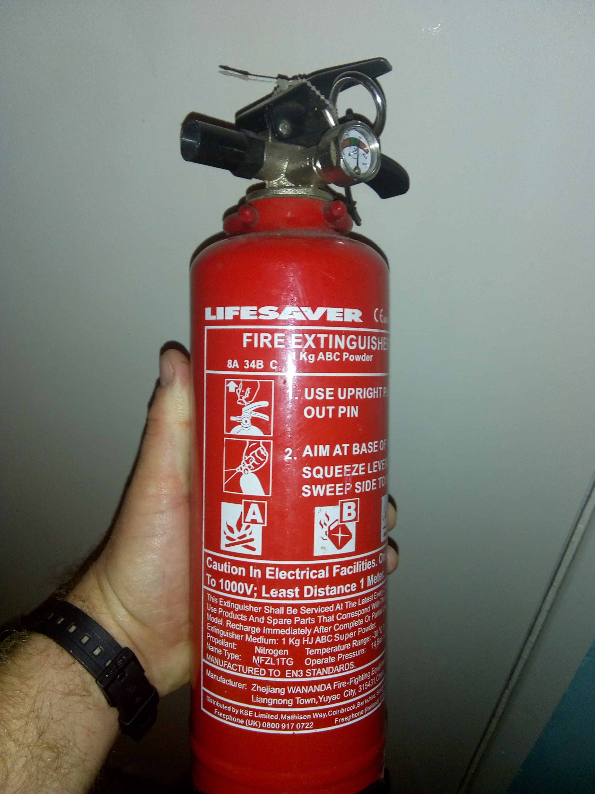

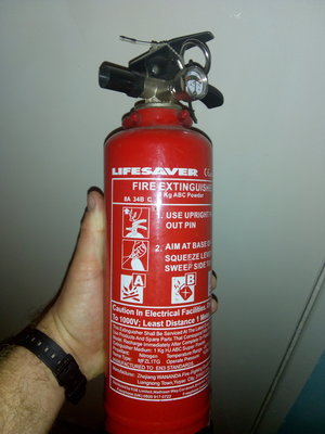

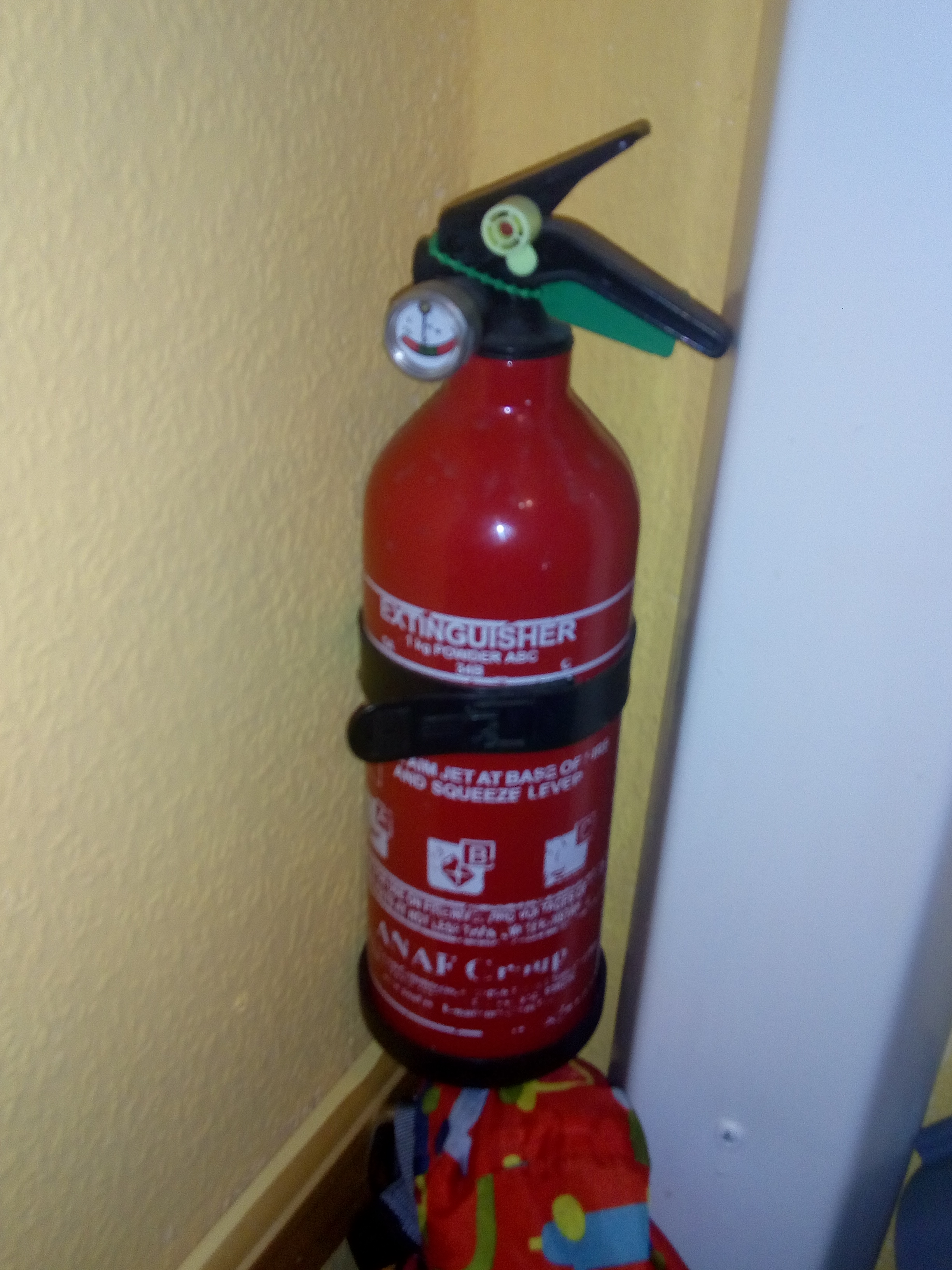

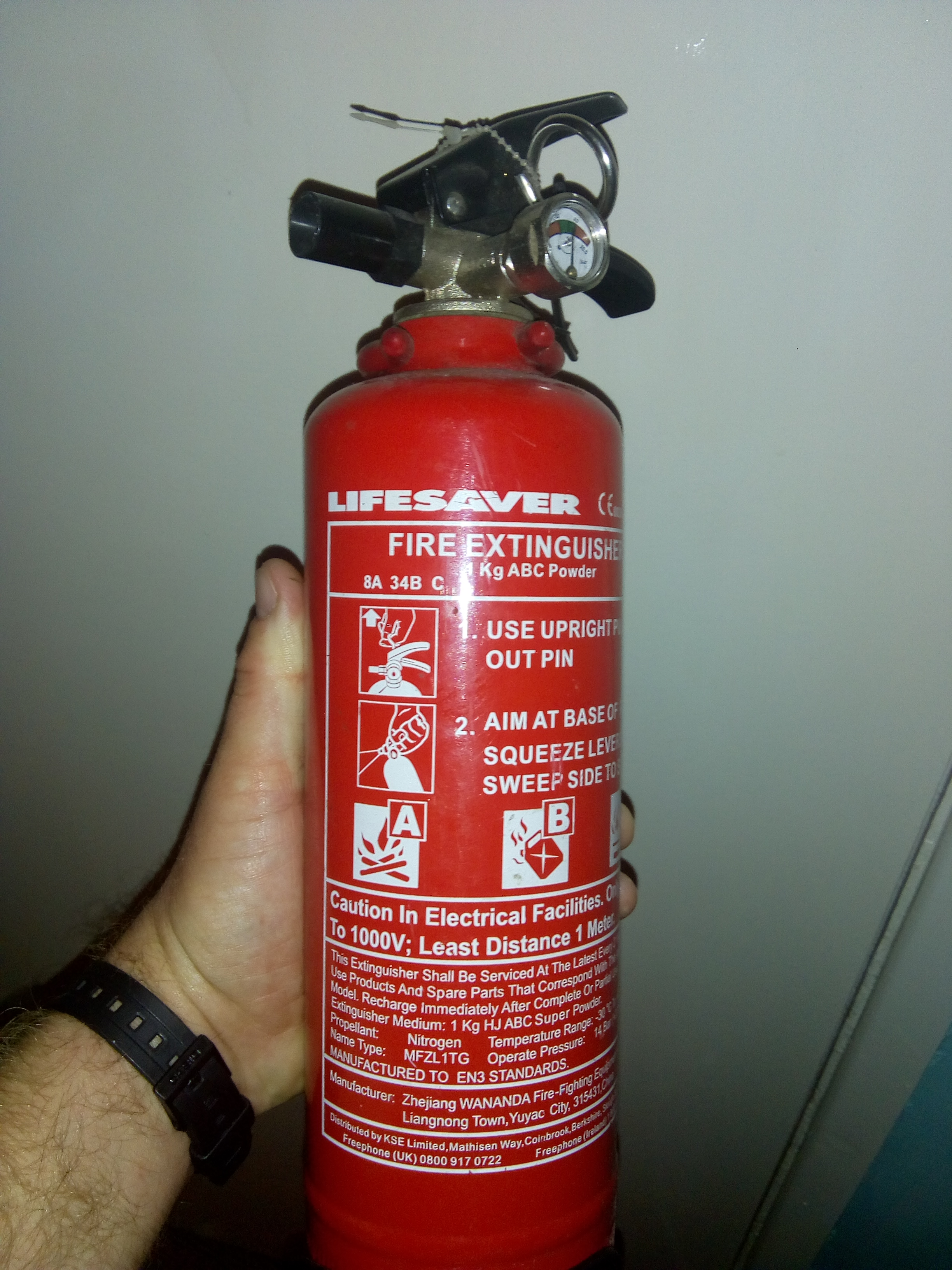

And in the hall there's a 1kg ABC powder

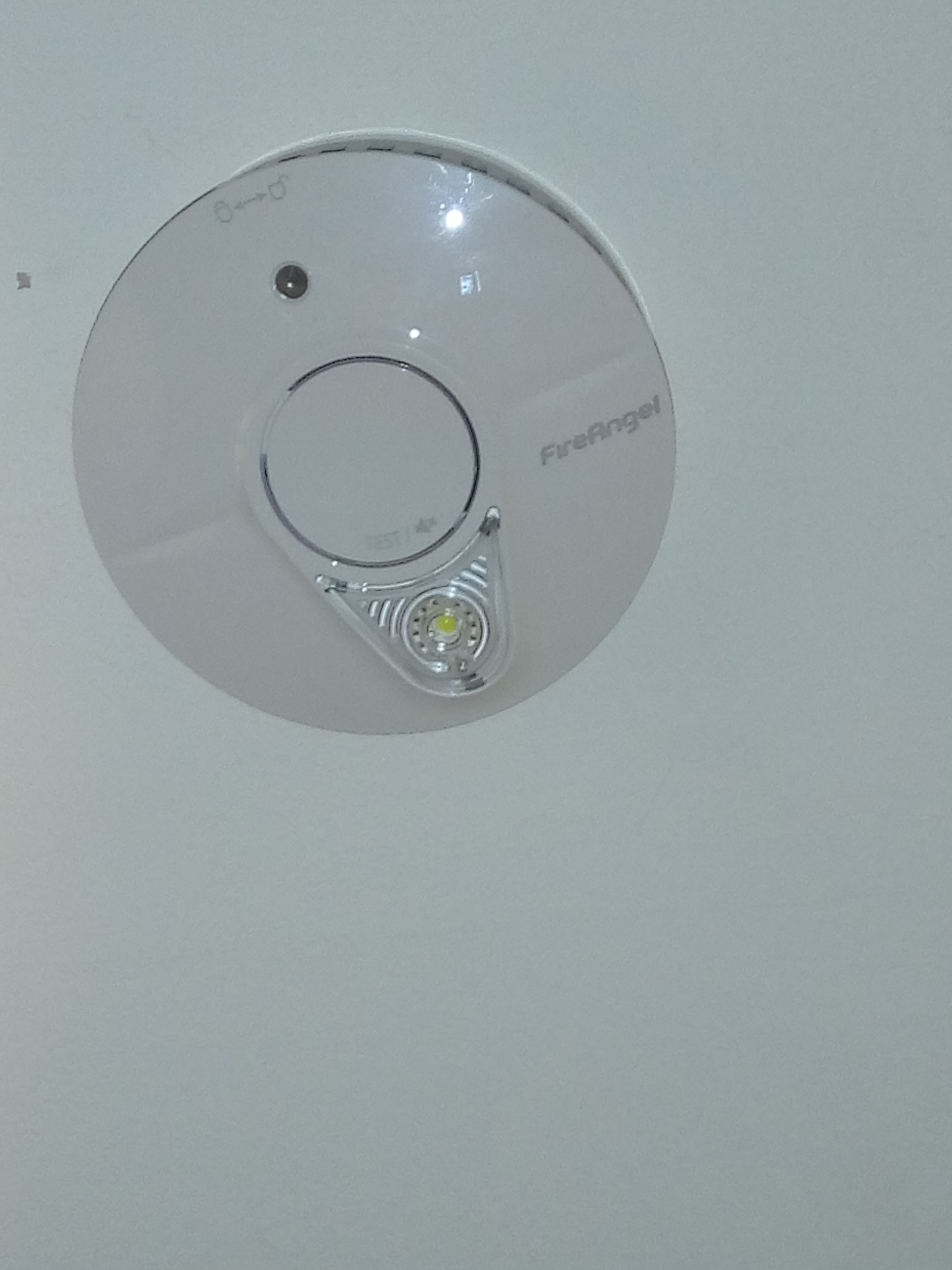

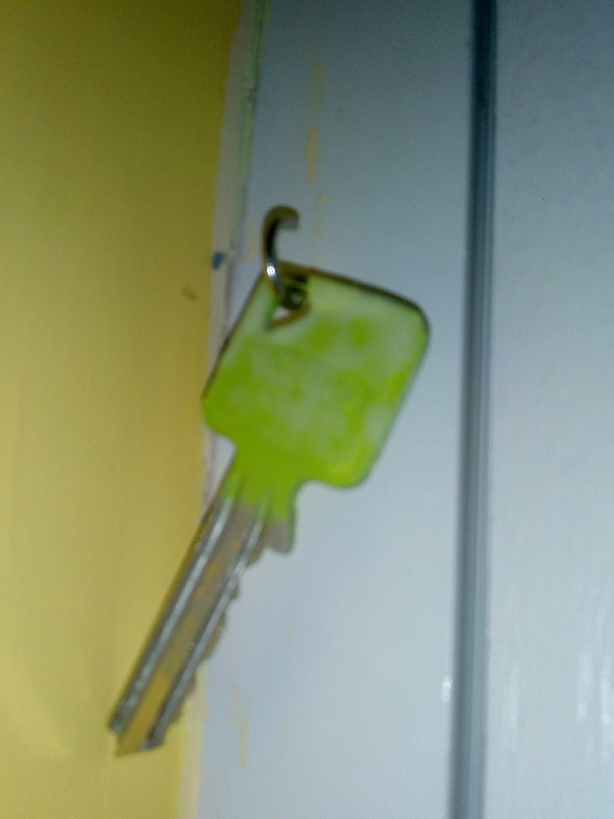

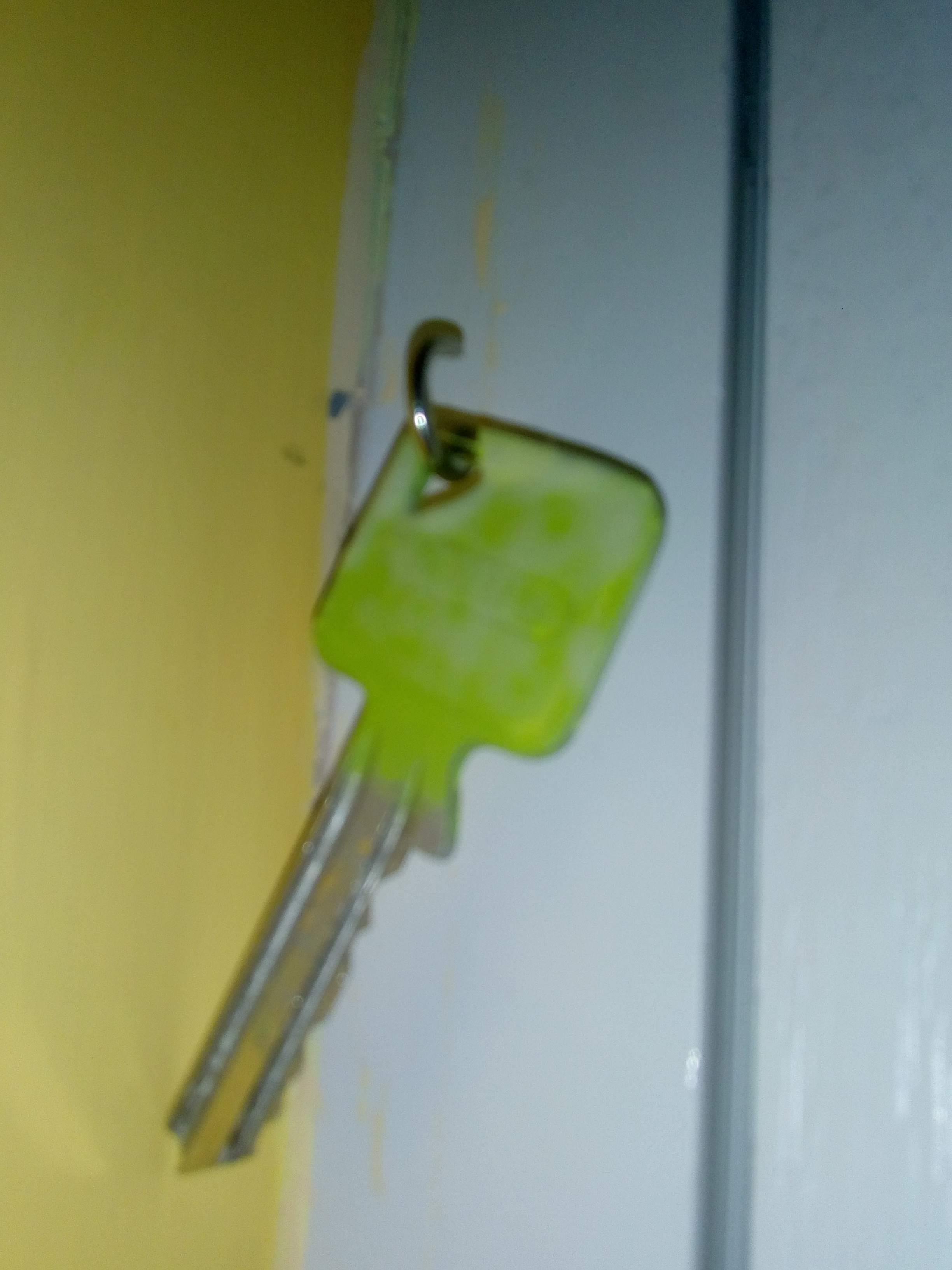

A smoke alarm with a bright led light and a key on a hook by the door which I've sprayed with glow in the dark paint...

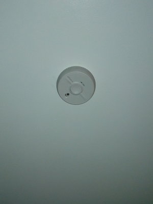

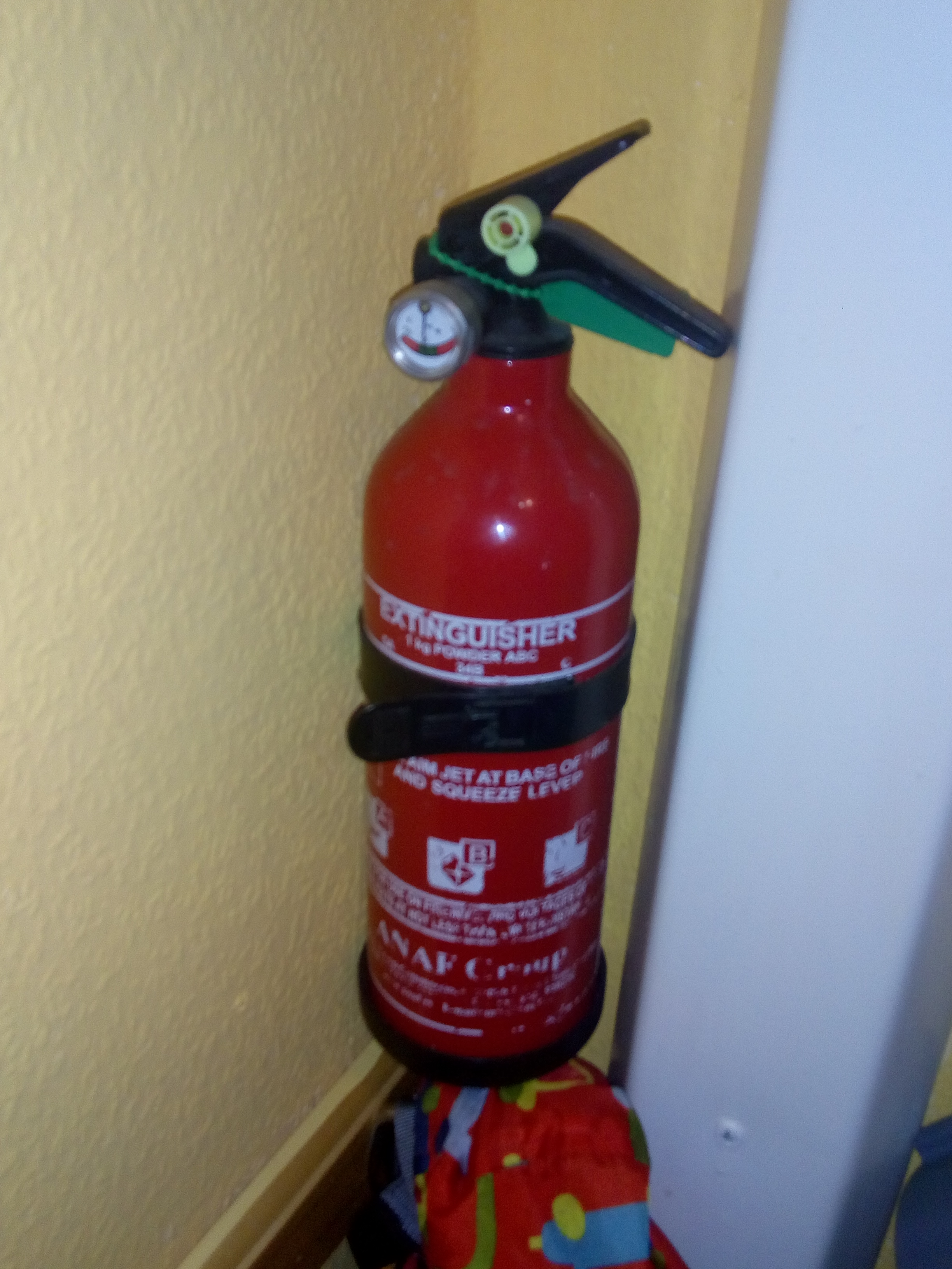

Landing has the other interconnected alarm and a 1kg powder
Each bedroom has a mini optical alarm

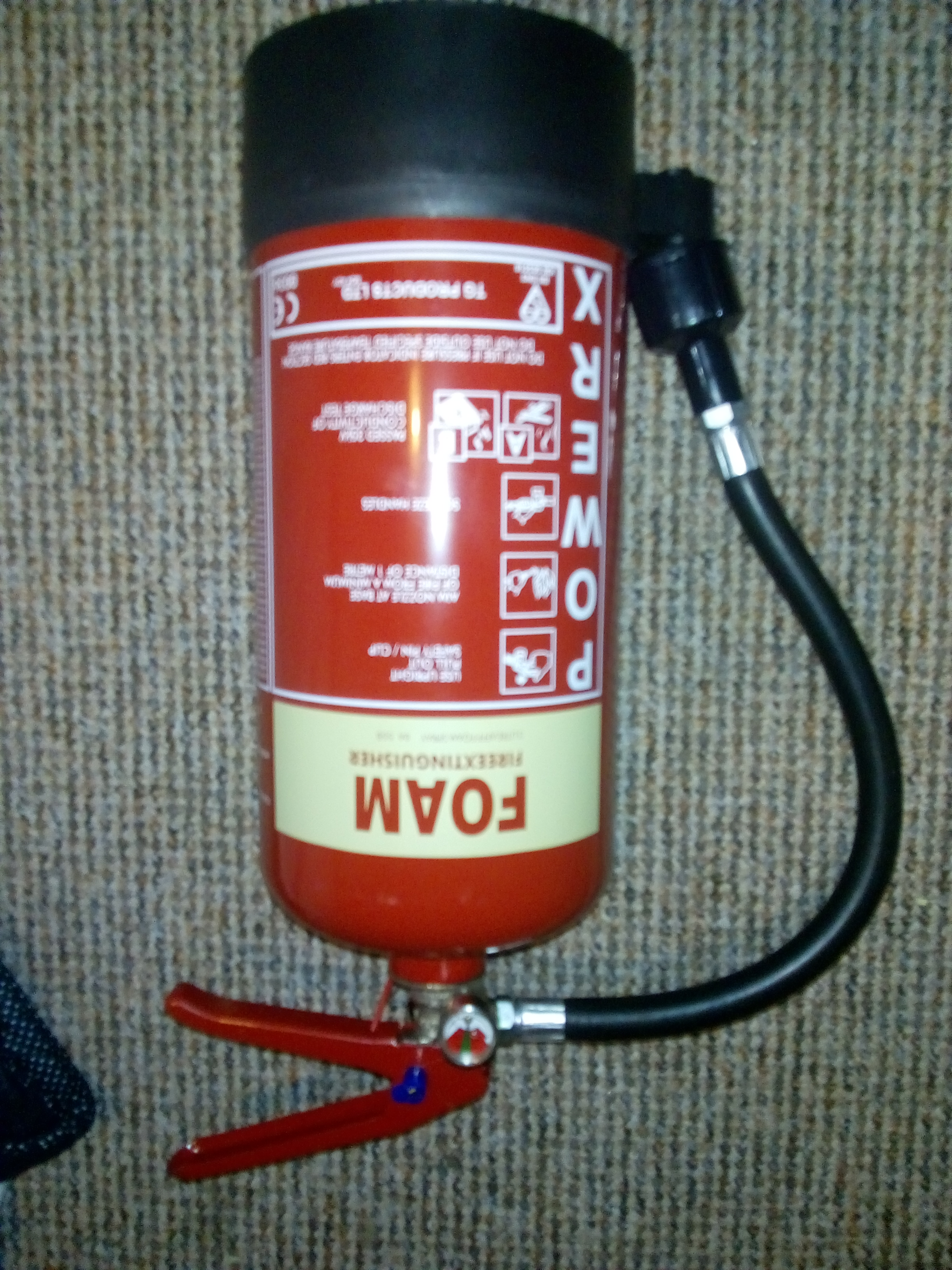

Then the master bedroom is our RV at night if the alarms go off.....

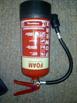

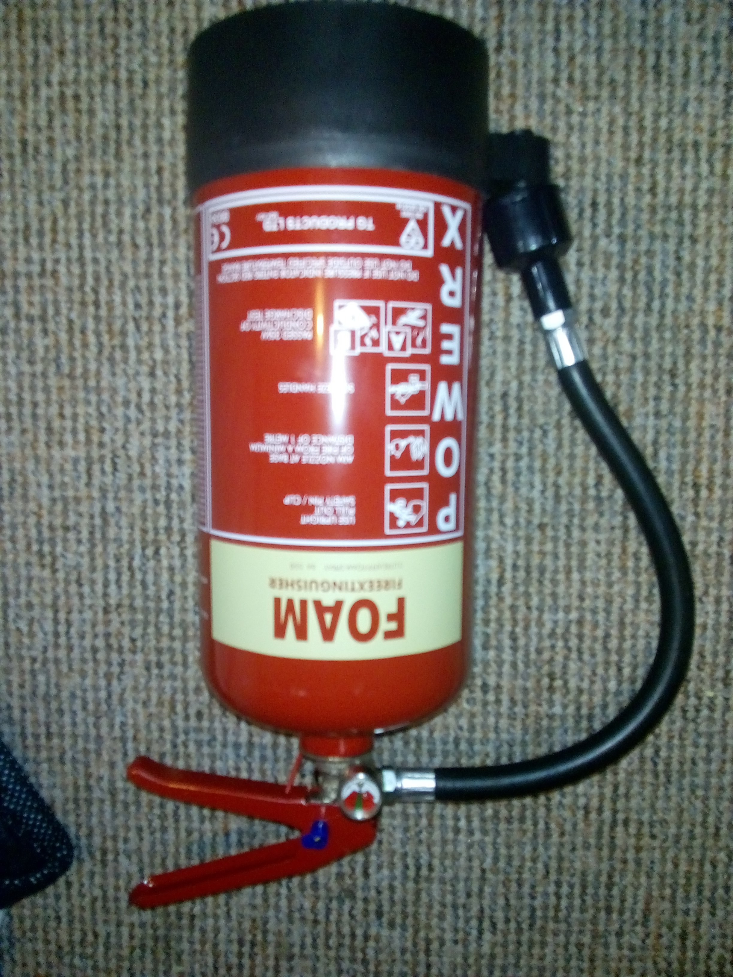

Got a 3l afff foam unit which is kept upside down ;)

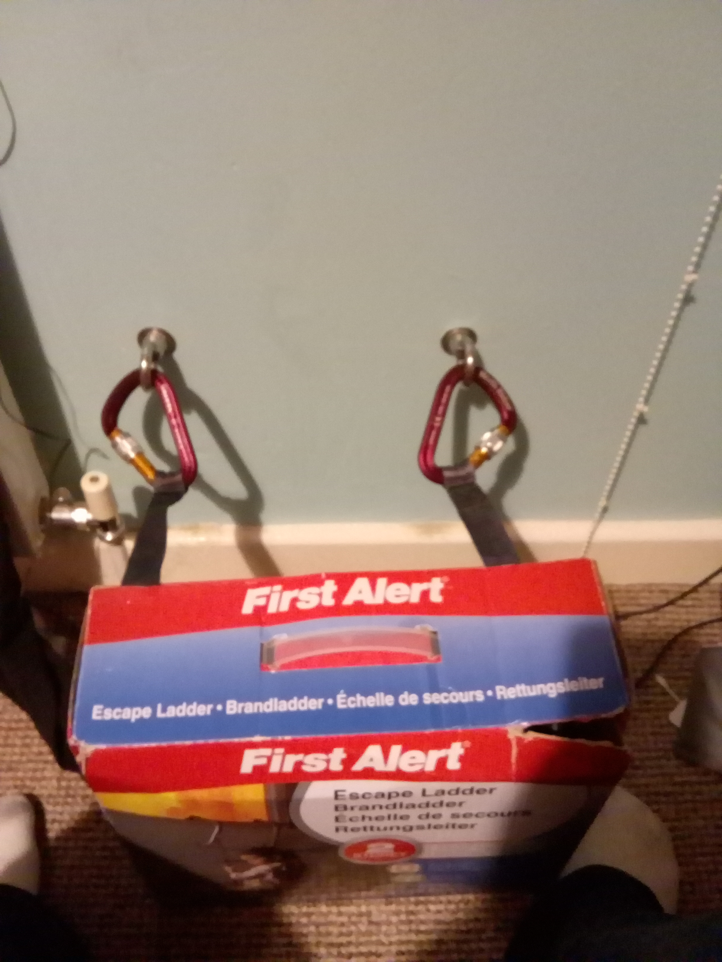

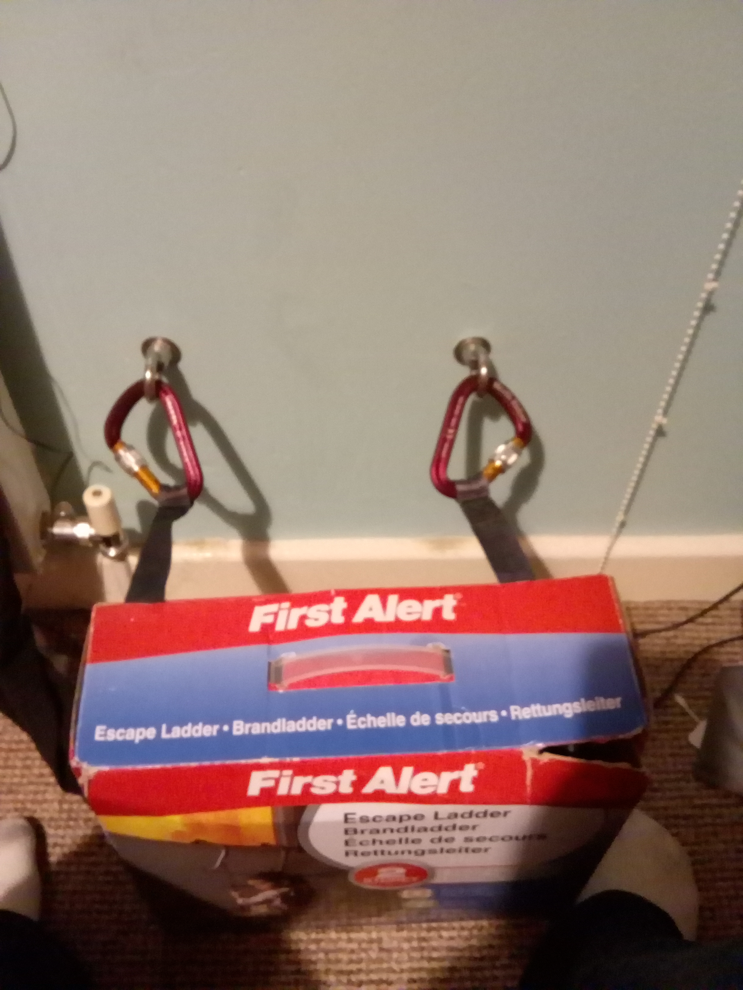

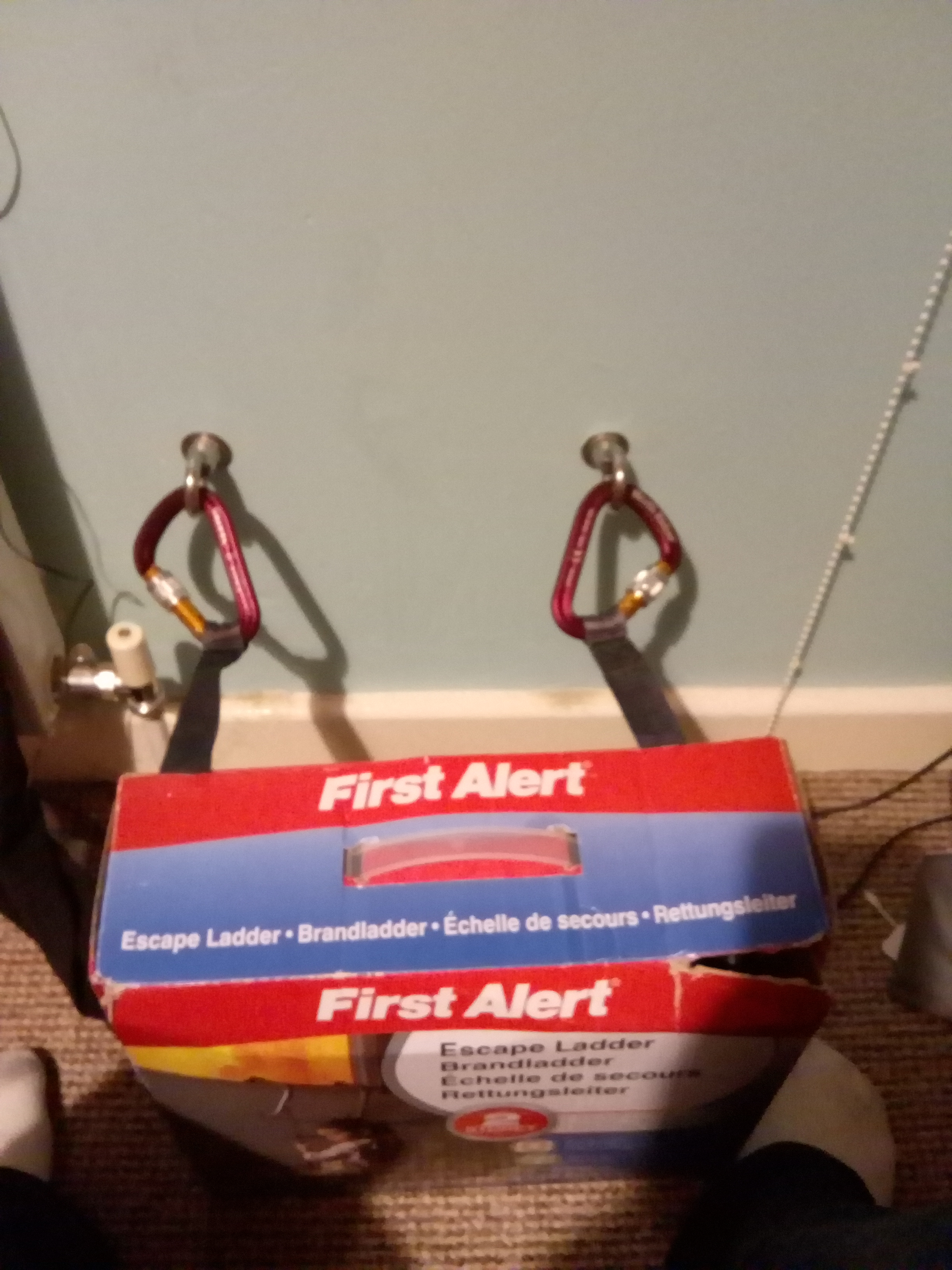

And a last resort tf we can't use the stairs ive had a tow rope out the window and swung on each bolt with no issue so 2 together is nice and secure :)

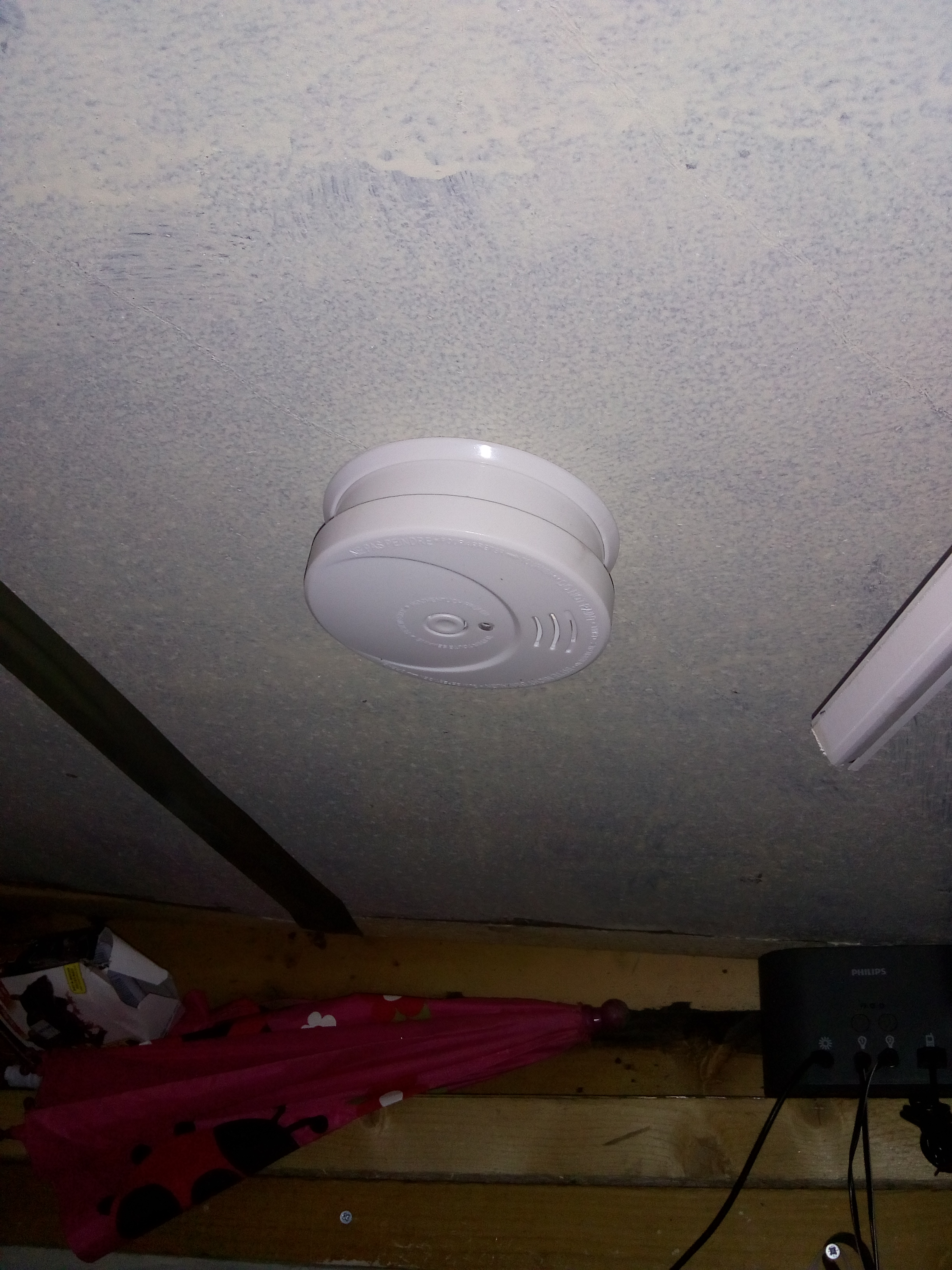

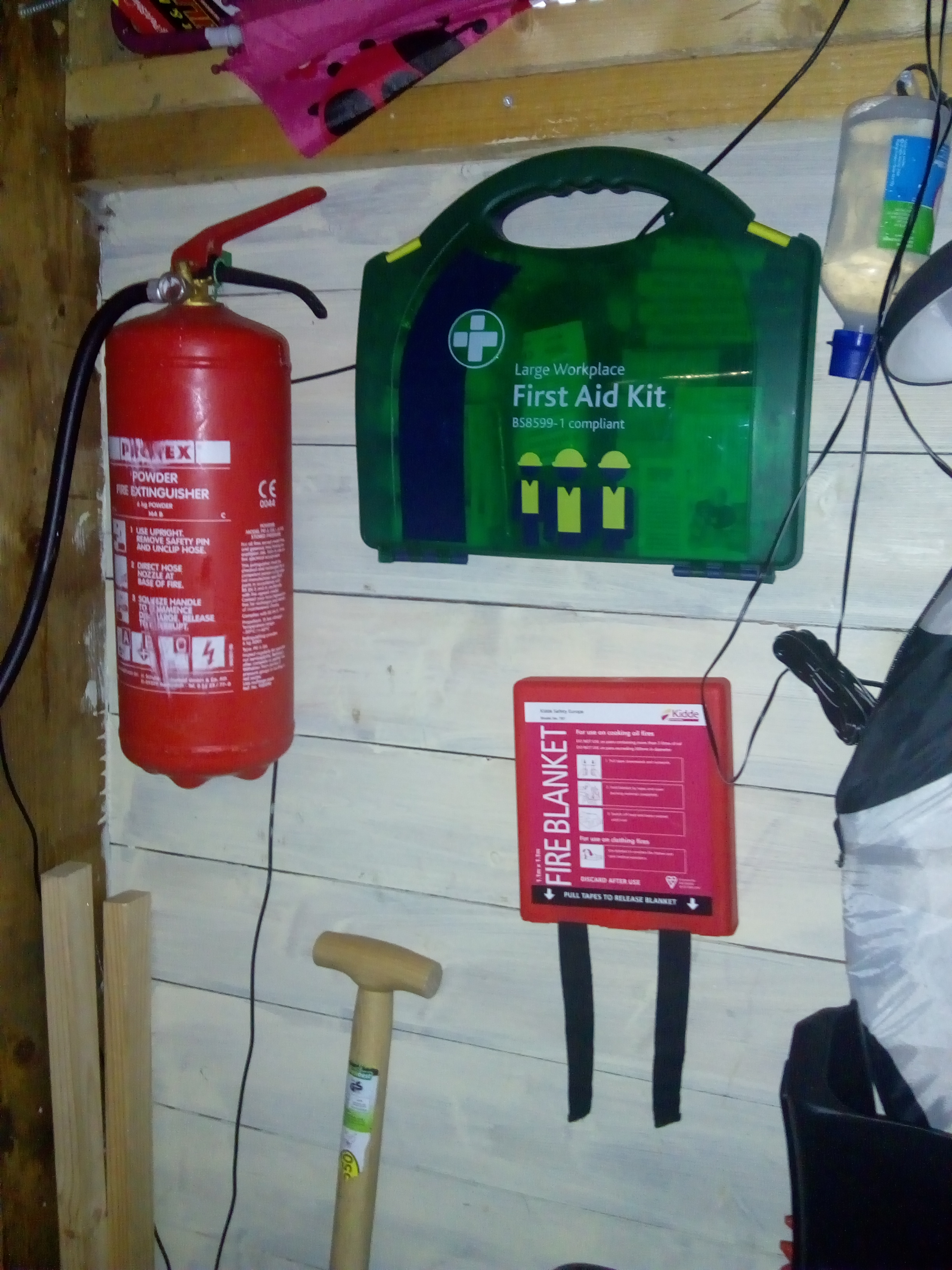

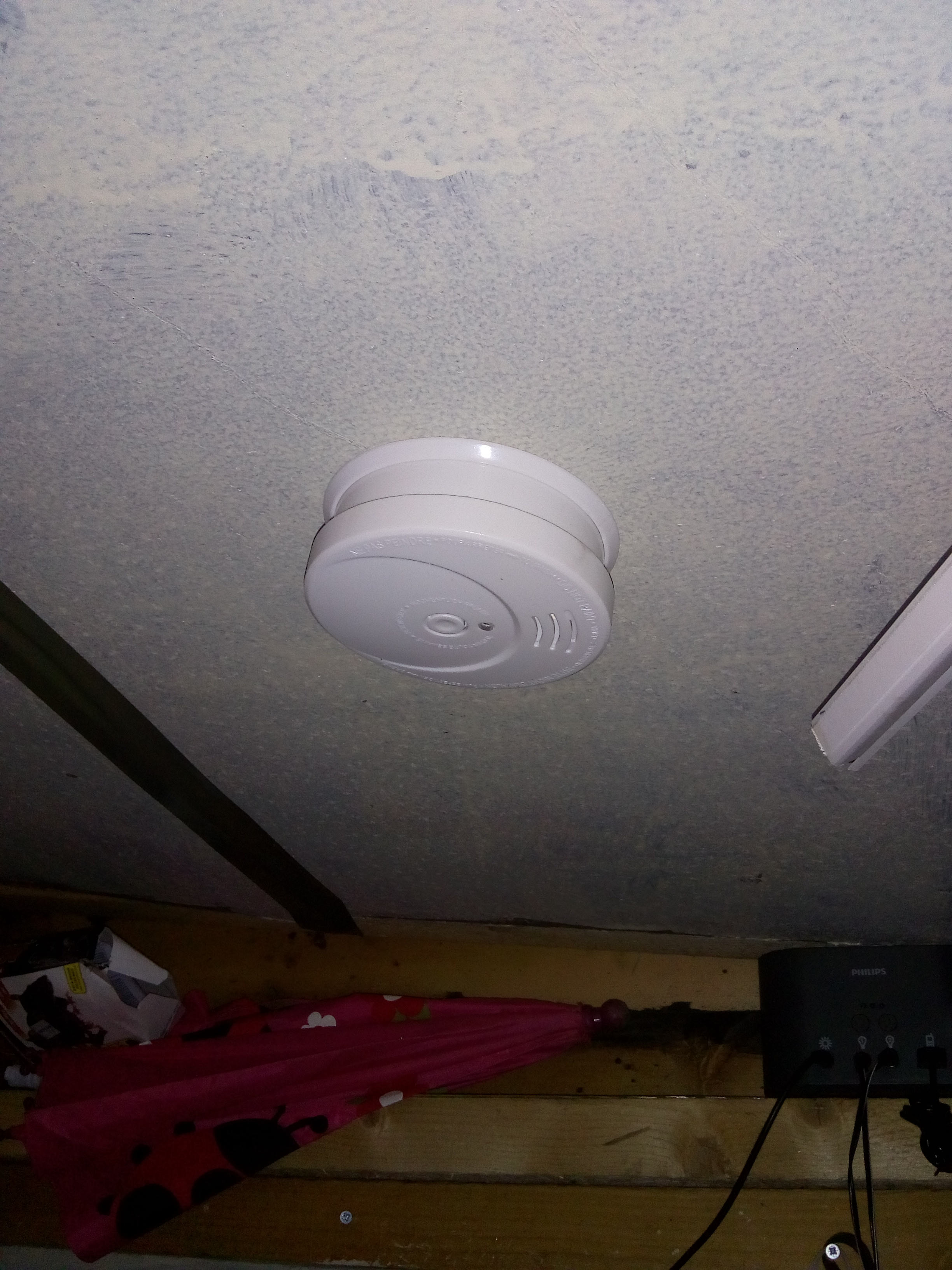

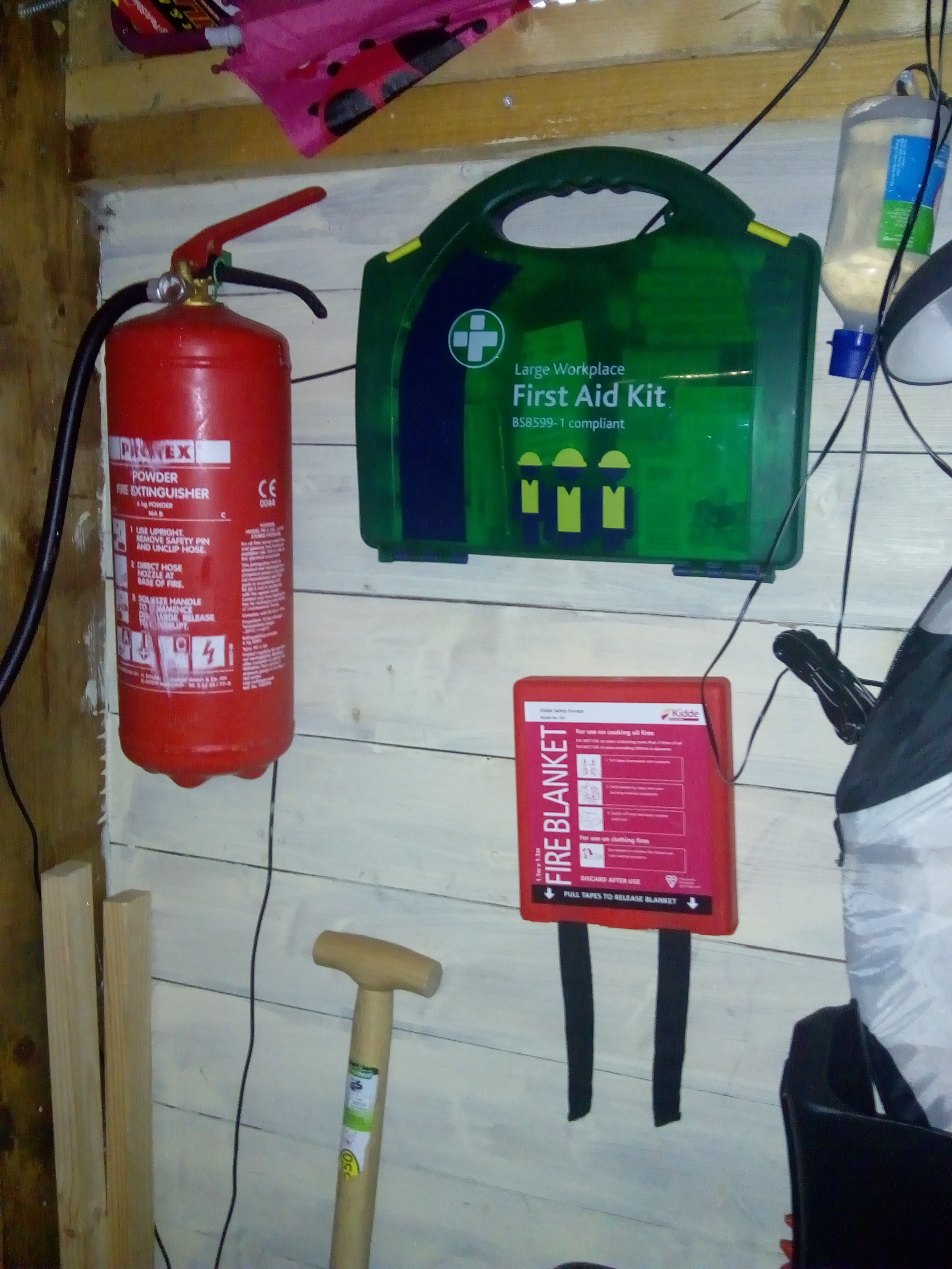

Then my mancave / shed
6kg powder and a 1.1 X 1.1m blanket plus a smoke alarm

Totes :shock: I thought I was good to have a fire blanket in the kitchen :oops:
Interesting about the shed - I keep all my first aid stuff upstairs, so if I needed it quickly because I did something stupid in the garden, I'd have to walk through the whole house (which isn't very big, but still). Thanks for that.

Just to pad out what and where / why
The ABF kitchen extinguisher contains 2l of special AFFF foam which can be used on most fires including burning clothing / solids / flamable liquids eg petrol and (F) cooking fats it's also chapter 8 compliment (safe on live electrical equipment to 1000v as long as you don't stand in the puddle of foam)
Most of my extinguishers are small powder units powder makes a flipping mess but offers very quick knock down of flames enabling escape...
If a fire is much bigger than that (the alarms in each room should provide very early warning) it will be too big to safely tackle as the heat and smoke in the average room would make hanging about most uncomfortable ;)
The larger foam in the bedroom will offer a chance to fight our way out of the house if needed as it's got a Decent discharge time
The power in the shed as foam etc freezes

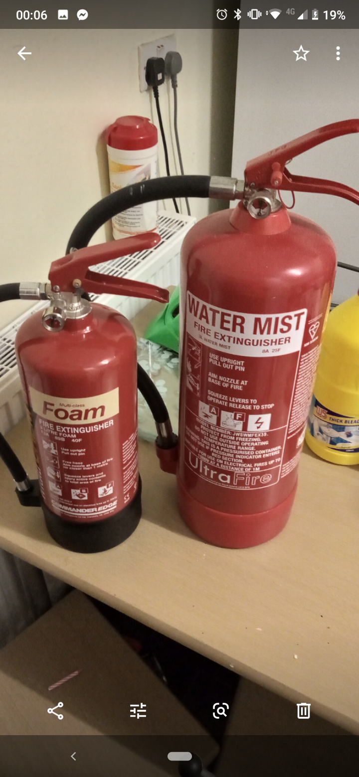

Might as well add this here.....

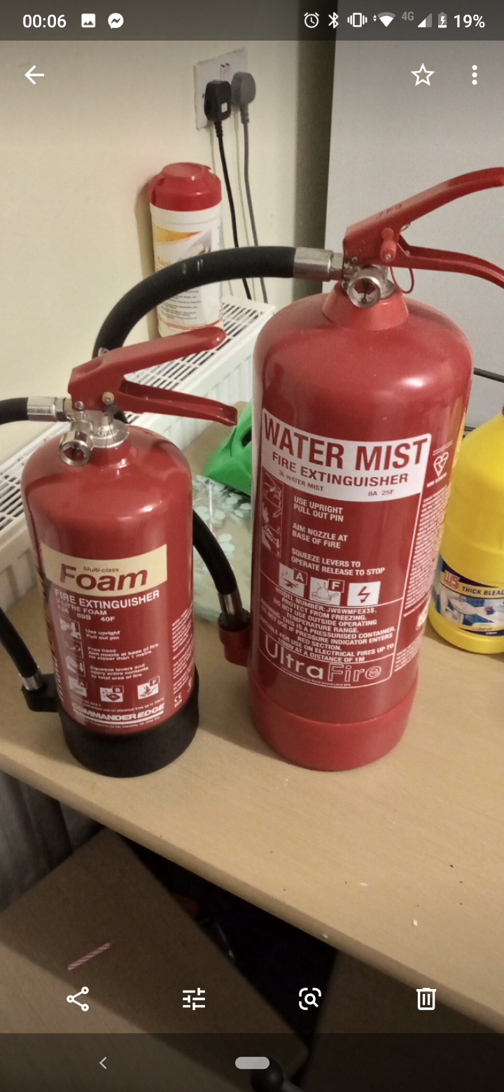

Another "new" extinguisher to the market is the multi foam fire extinguisher... My new favourite :lol:
Water mist is so last year :lol:
Whilst mist is good after much reading and a bit more use / experience with them and discussions with another service agent and a health and safety advisor they tick the insurance man's boxes but size wise they are big with a poor rating and a long discharge time a long discharge time might sound good but you want the fire out quickly minimising exposure to heat/ smike . . .
So take the 3l water mist it's physically as big as a 6ltr foam / water / powder...
On the official tests with a good preburn it's only got a 8a 13b 25f rating. .
Whereas the 3l multi foam is 13a 89b 40f and a lot smaller do easier to move it through the house especially if your not strong or as able bodied.... Speaking from experience the big industrial units are hard to run with (my shin bears the scars litterally when one took me off balance at work )
So effectively can tackle a class a fire twice as big as the mist extinguisher, a decent size class b fire eg petrol and a 40l ! Chip pan

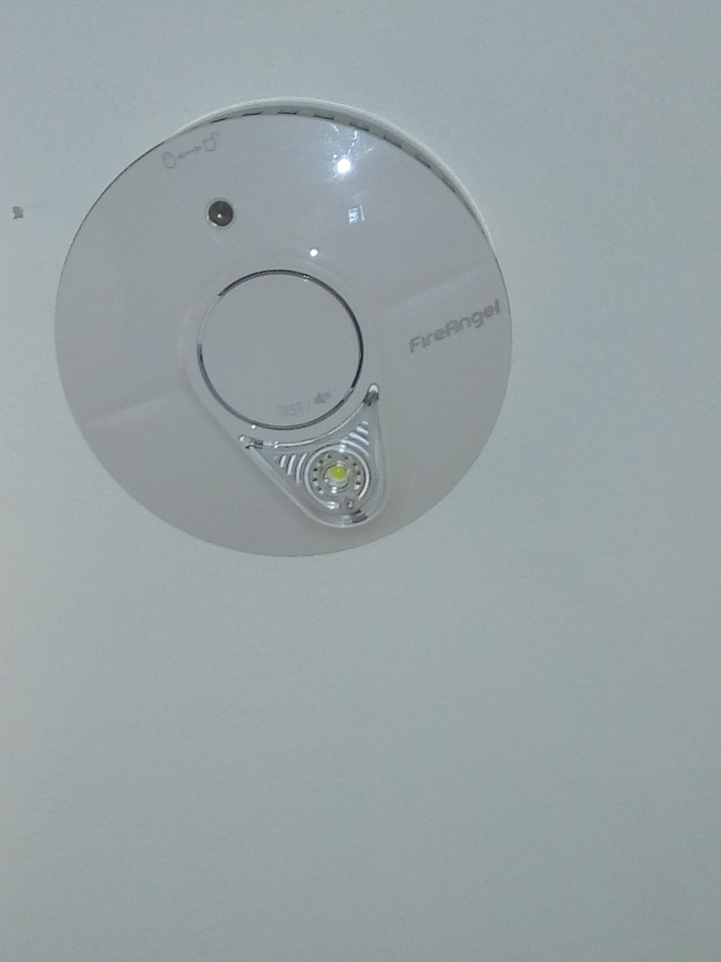

My current favourite bits:
Alarm with a escape light runs on 2xaa batteries which are readily available and according to the book last 3 years!
https://www.fireangel.co.uk/products/st-623e
