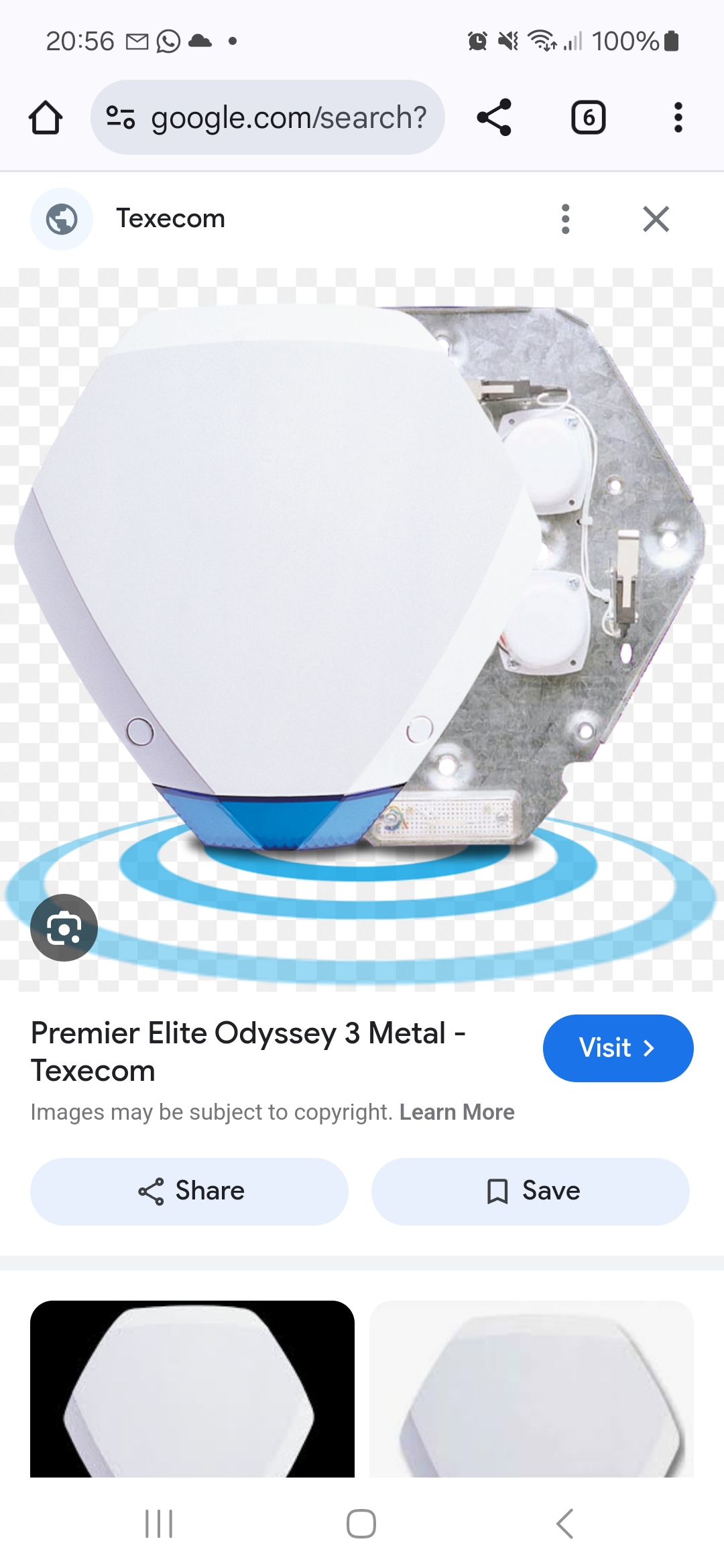

Assuming you mean hard wired not the basic diy smart jobbies
You can get bell boxes with the standard polycarbonate outer skin but below that there's a metal inner skin and long screws meaning it takes an age to kill the sounder....
https://secureforth.co.uk/product/texec ... backplate/
With a standard plastic cover to suit in the colour you want ....
Or full metal back plate and stainless lid
https://norbain.com/elmdene-rapier-exte ... er-grade-3
