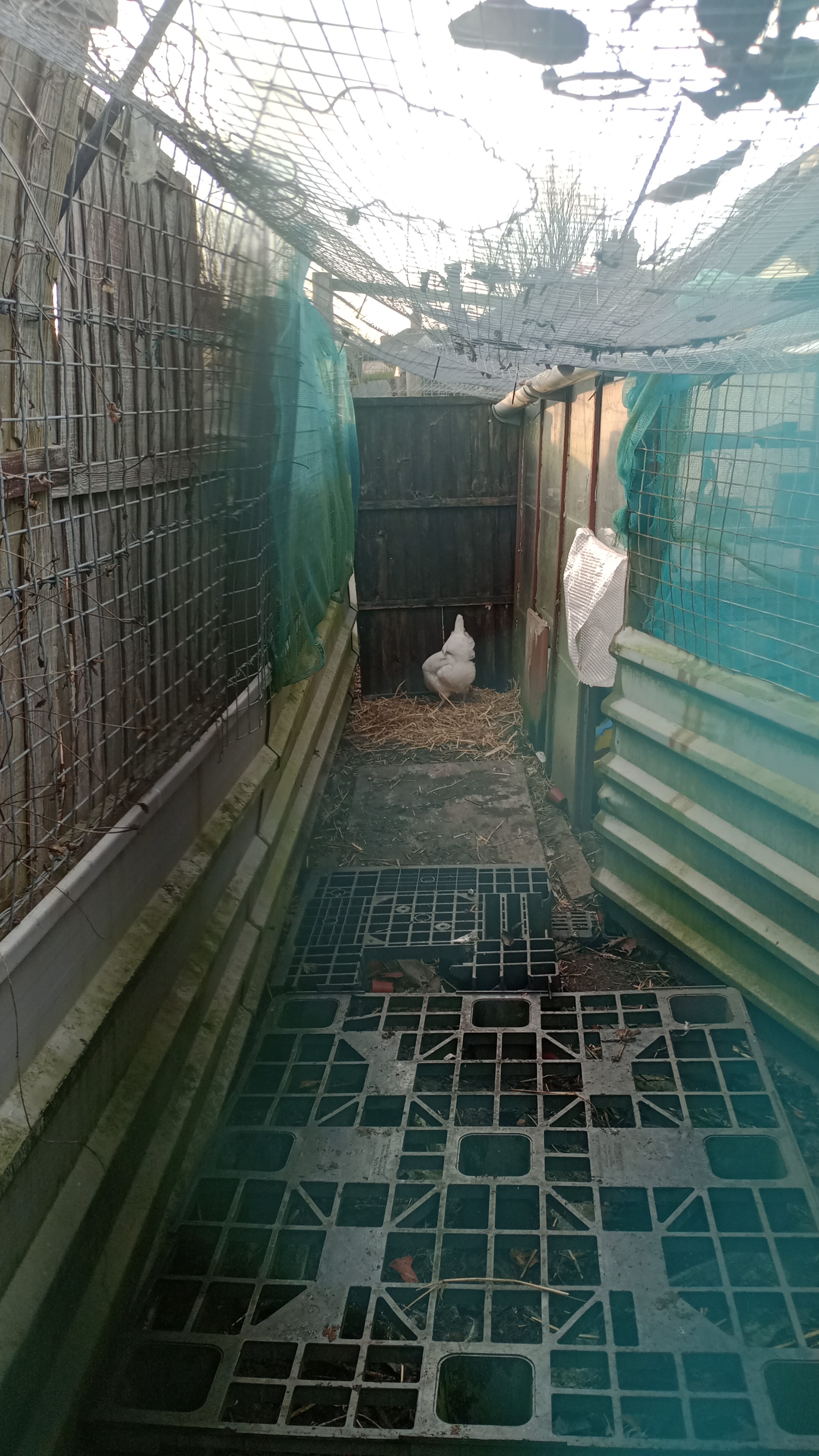

Posts: 10016

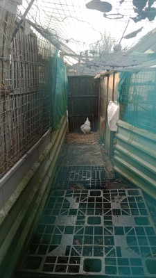

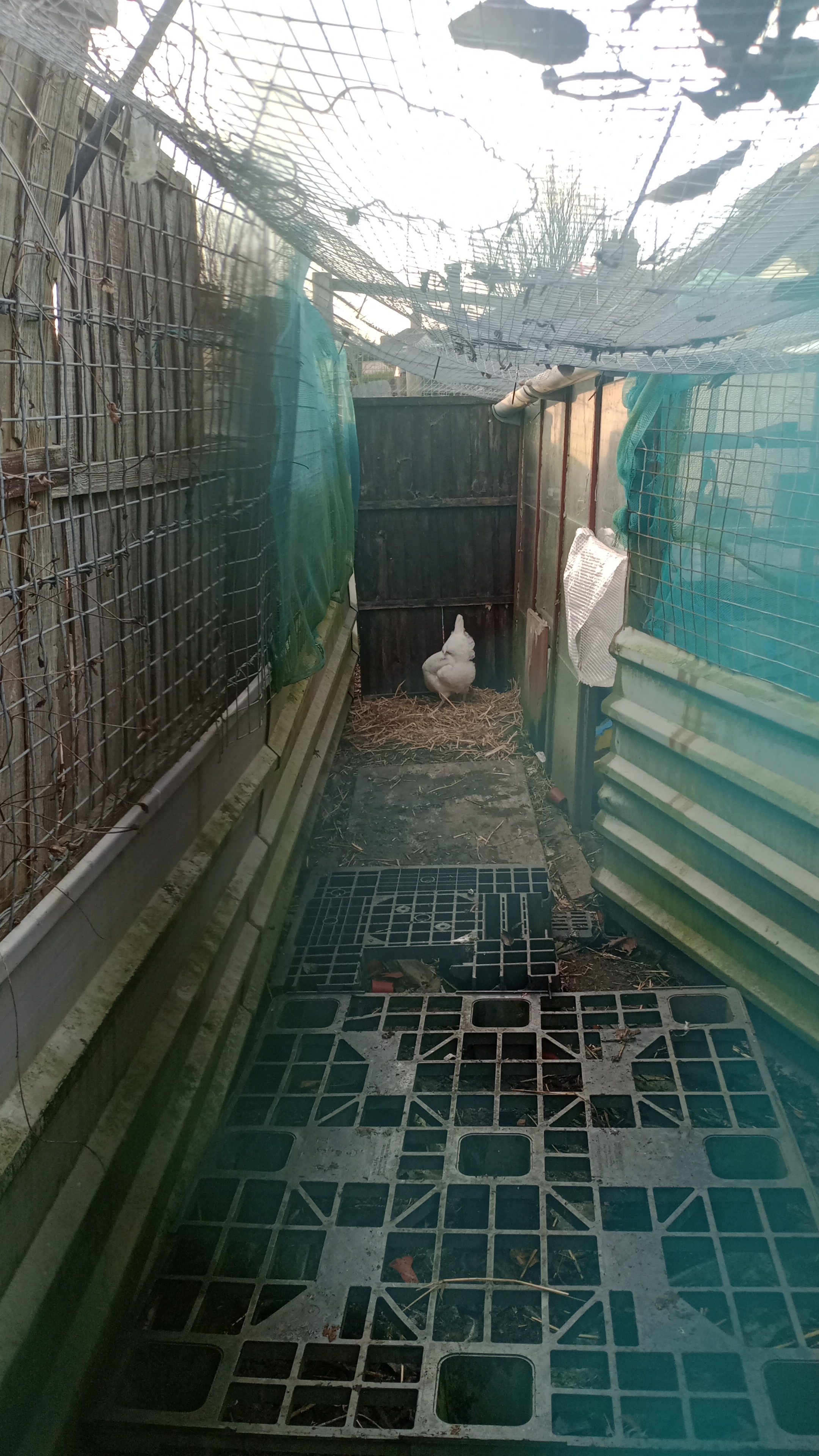

Let me out.. let me out!!!
[attachment=0]IMG-20241222-WA0004.jpeg[/attachment
Avian flu housing order comes in tomorrow for our area and many more so that's another job done
