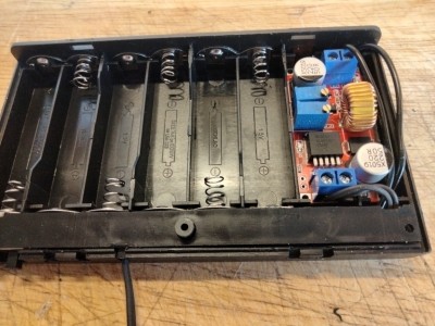

Secret sauce..... The 8 cell battery box holds 6 cells and the XL4015 goes in the other two slots!

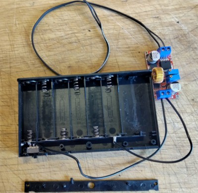

OK... A picture paints a thousand words.....

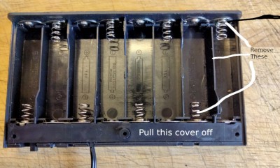

Modify the battery box by removing one of the cell separators, with a knife and some jiggling and pull out two of the battery terminals.. We will rearrange them to save on the need to do soldering.
Rearrange the wiring, as below. Later, you may need to bend the +ve terminal with the wire so that it reaches the battery terminal.
Tidy the wiring away.

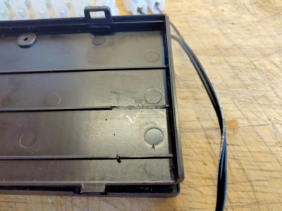

If required you may need to scalp some plastic from the box lid. Depends on the design of your module.

Pop the batteries in. Put the lid on.
