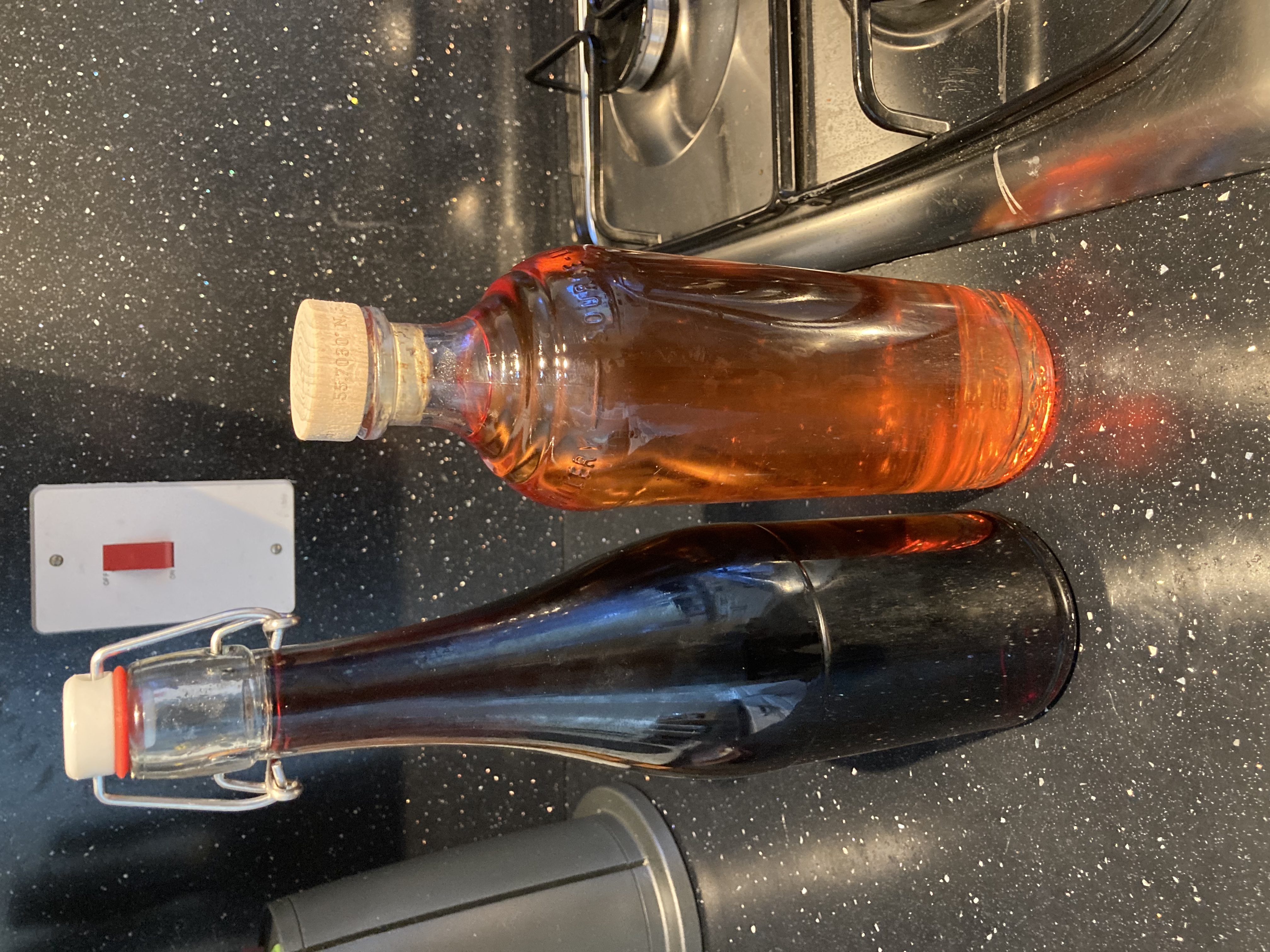

Haven’t a clue if this has attached but that’s my cherry and fruit salad wine.
The fruit salad wine is in an Arran whisky bottle. I’ve told the wife I need more empty bottles for my wine so therefore I need more whisky….
