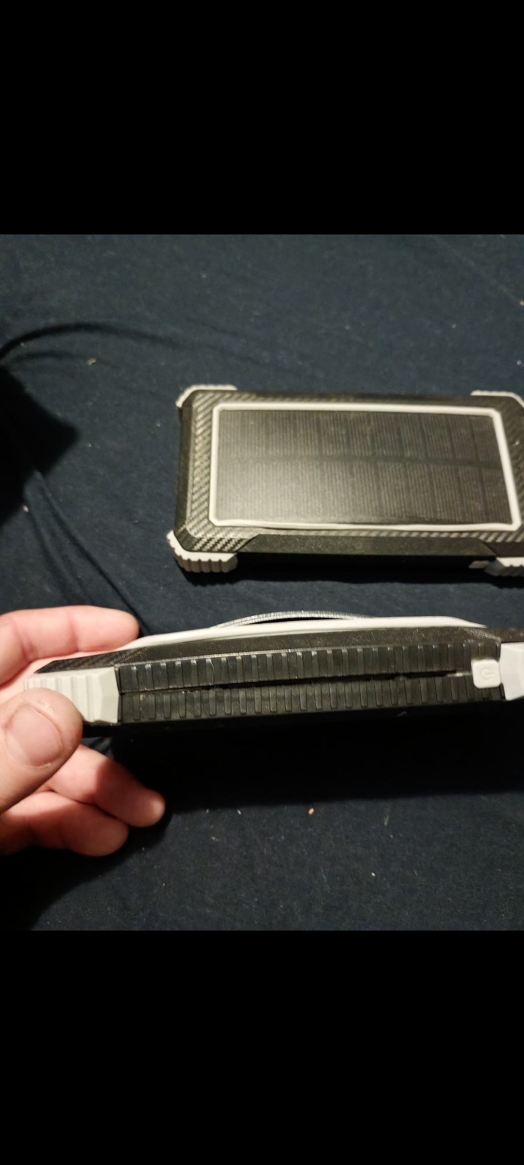

Well here's a prime example of why you need to practice safe storage of lipo power banks ...

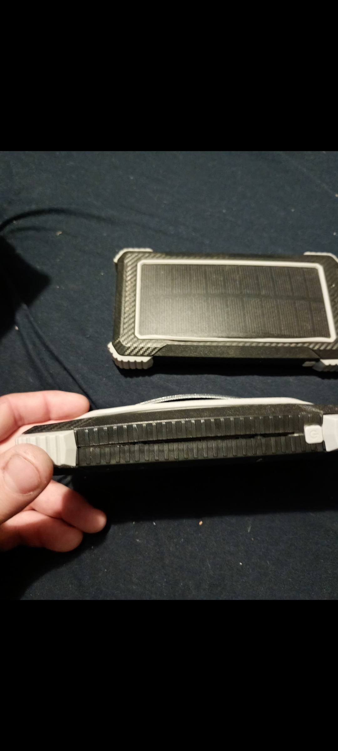

Let's set the scene around April 2023 I bought a clutch of Goodman's solar panel shod Goodman's 10,000mah usb power banks
Exhibit a :
https://www.uk-preppers.co.uk/forum/vie ... nk#p228844
Used a few times a year then topped up to full then drained back till the 3rd led is lit taken on holiday in carry on as a backup for phones etc
About 1.5 months ago a former colleague was doing a big charity event and asked if he could borrow a few power banks so I lent him my afiry and a couple of ankers at that point all were happy in the ammo box I had a quick look through got a couple of others out to exercise and charge back up....
He returned them yesterday which had been planned he'd had his car in the garage etc etc plus very sore feet from a 200 mile run!!
So set about making sure they were full hed charged them before return (always nice ) so last night used them to top off my phone and spent the afternoon charging other stuff ..

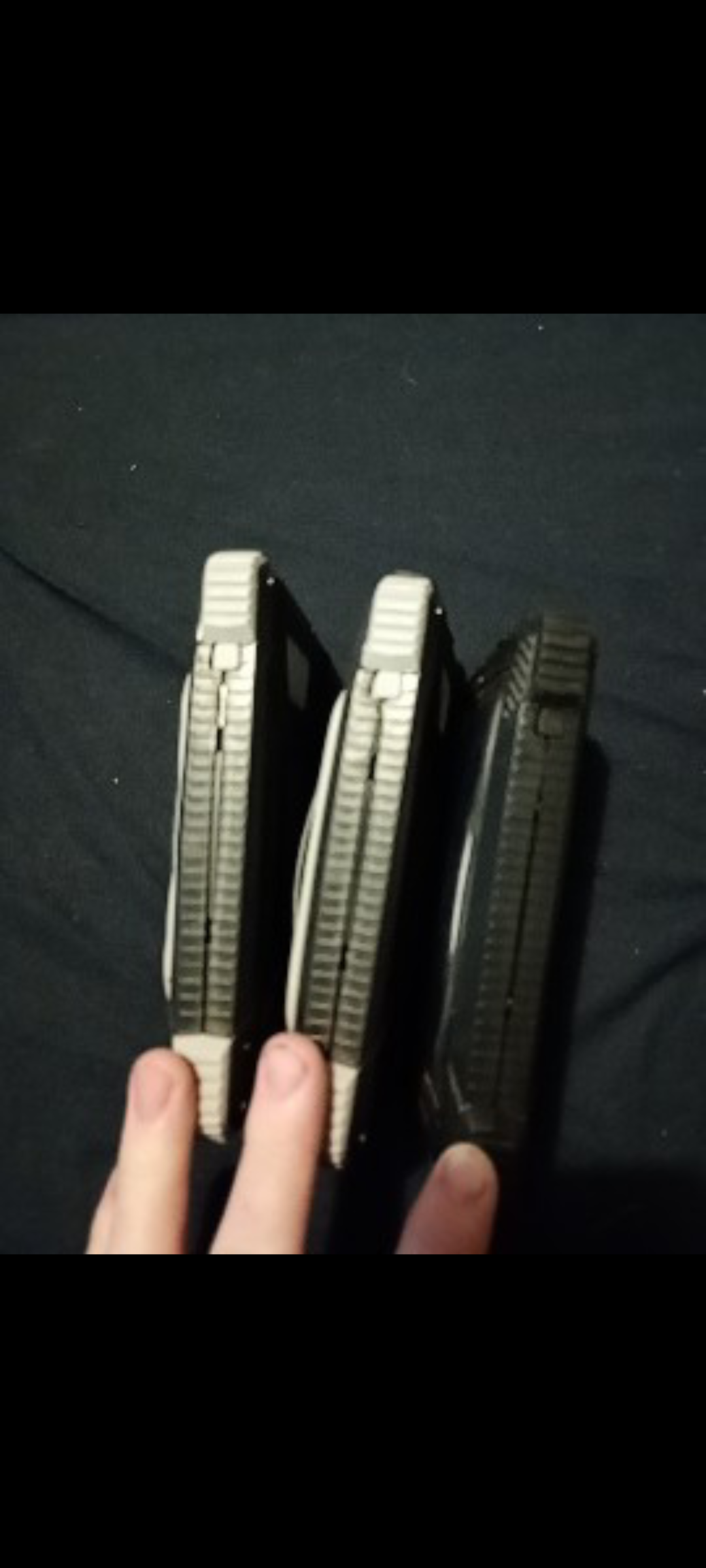

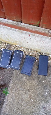

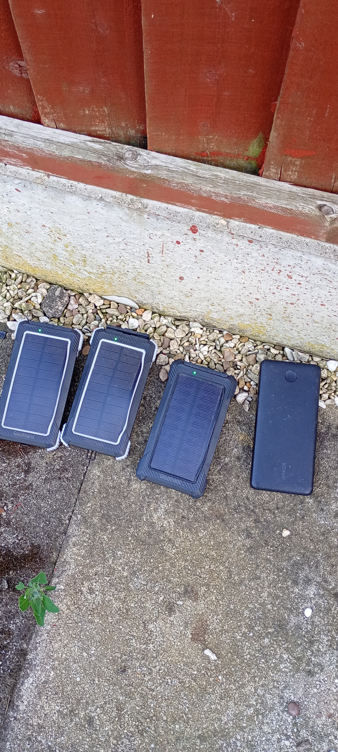

Without dragging this out any more than needed opened the box to be confronted by this::
Stored at about 75% charge

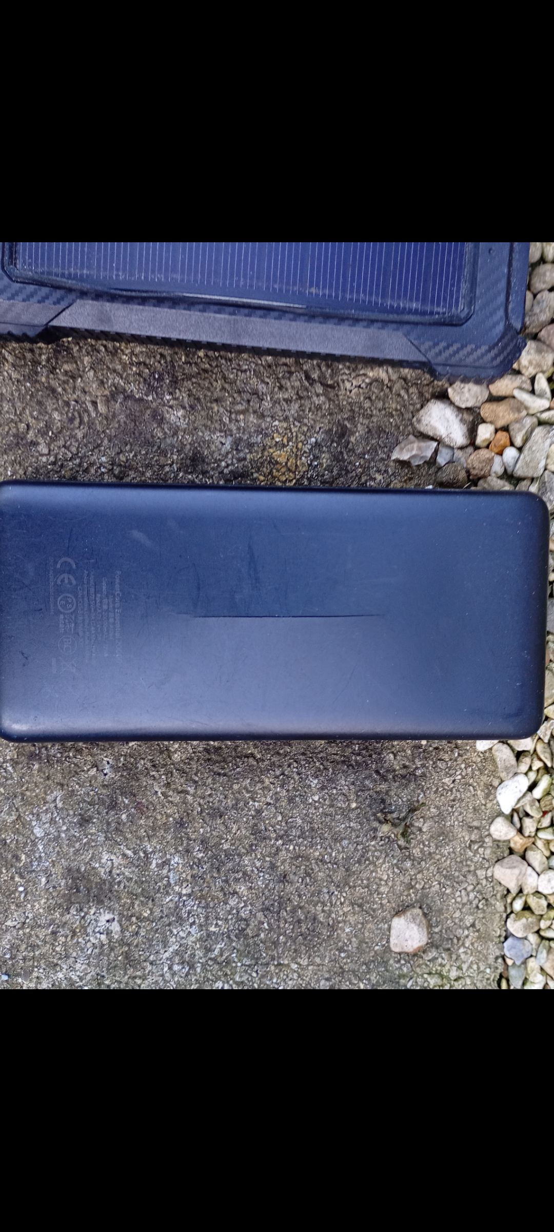

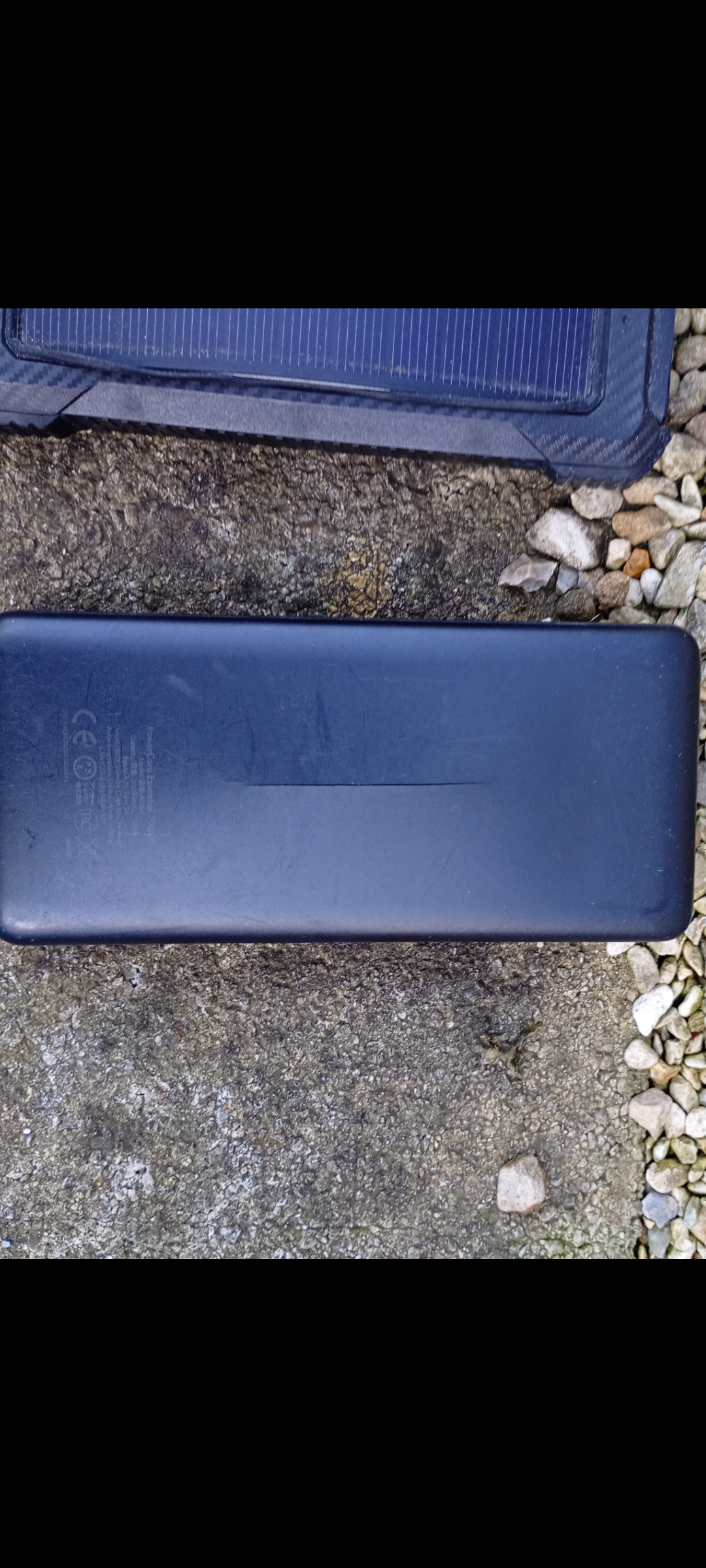

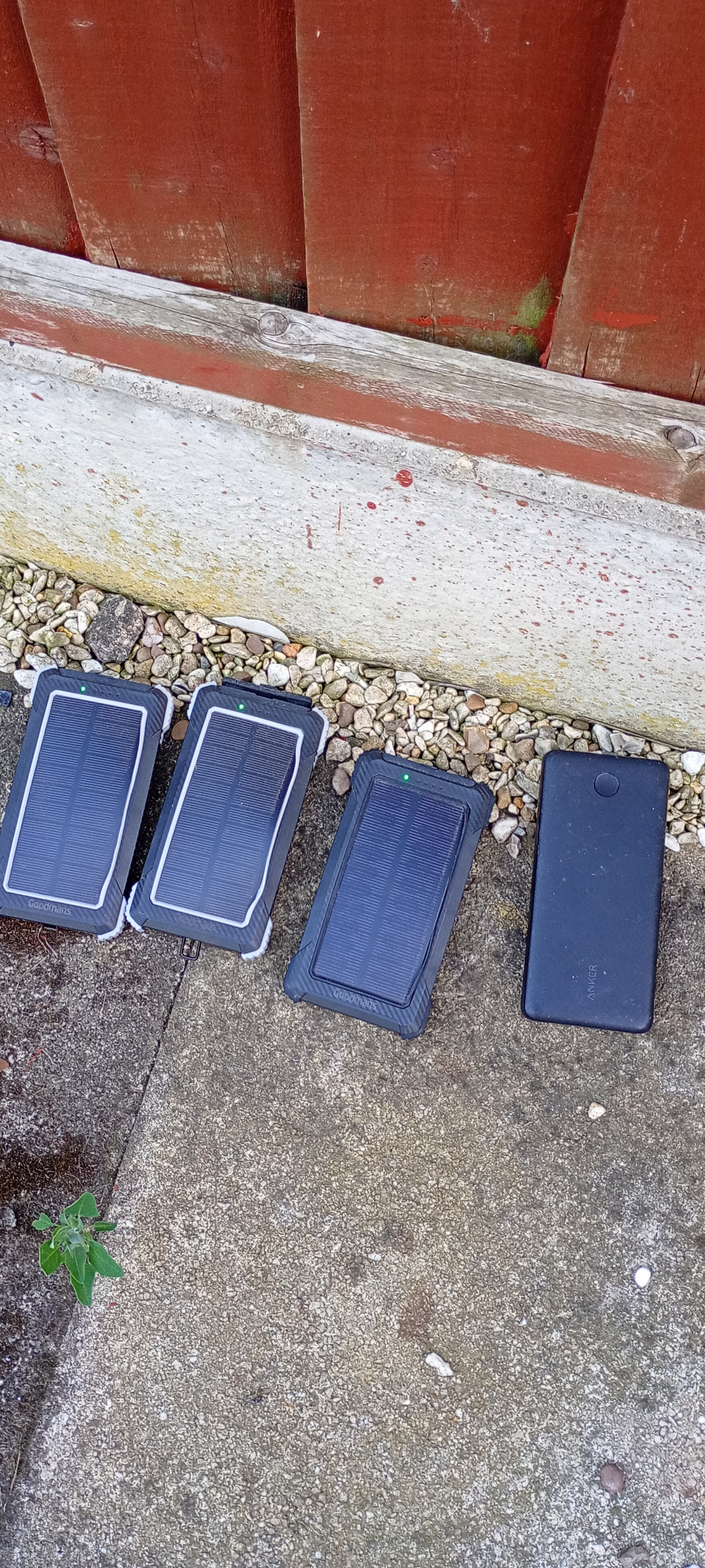

Fortunately nothing untoward happened found an Anker when I lent my mate the banks had a crack in the case too need to get some rock salt and give them a good soak in a bucket for a few weeks currently outside anyway from anything
