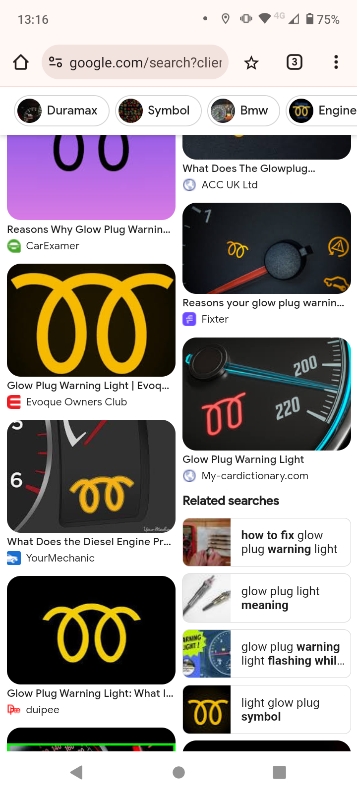

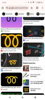

Get the glow plugs tested +the relay unit chances are one or two have gone down... And get the battery tested it's one thing it starting but the Mechanic can tell how much actual kick the battery has if it's low on cranking amps the glow pligs wont get as hot as they should...
If it's still struggling get the coil light on let it go out then ignition off then on again try starting the second time the coil (glow heater plug) light goes out
This heats the plugs twice so should start up easier

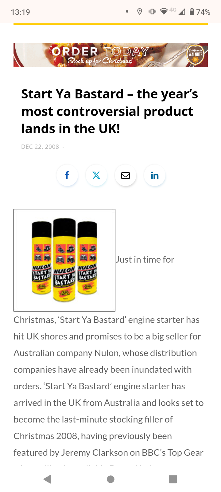

SHTF and you need the car running locate the air intake and give it a squirt of Start Ya bastard or easy start but don't rely on it cars tend to get addicted to it and it doesn't do the engines much good over time

I had it at Halfords on the diagnostic - nothing came back for glow lights being shot. I do also do that - turn on the ignition and wait for the glow light to go out - repeat a few times so that they warm up.
