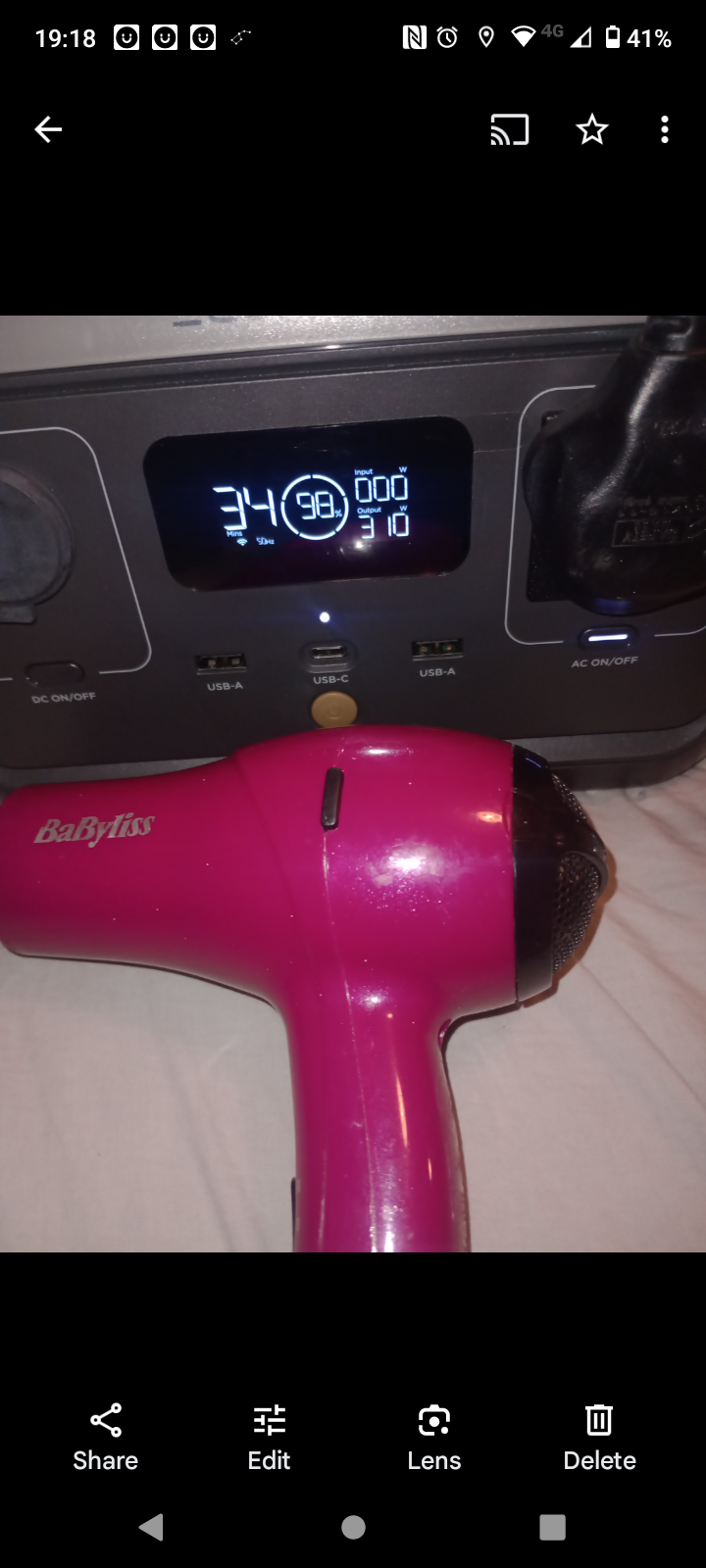

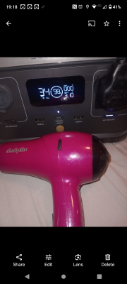

Is this solely to dry her hair? One shower / drying session and phone charging ?
On low power (trips on full) it'll get 35 mins run time
Added bonus from nearly flat it'll recharge in about 2hrs from the car cig lighter (average holiday running about visiting places)
