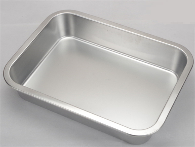

Can anybody advise on the follow idea of an EMP protective case for sensitive electronically equipment like SSDs/HDDs please.
The idea being to clasp together two identical oven trays, to form a box:
Then to use aluminium tape to seal around the edges.
Naturally there would have to be a non-conductive inner lining, but that essentially should be sufficient to protect against ~50dB ?
Any thoughts please ?

It should work. It will work better if earthed. i.e. attached to a wire or metal rod buried into the ground. Your mains water pipes should be earthed so you could also attach to an unpainted mains pipe.

Many thanks for the replies.
To earth the system I could just leave it on the ground floor. Although, that wouldn't necessarily make it "work better", only prevent me from getting a shock, after an event.
The thing difficult thing for me is to measure the level of dB protection that a DIY system can ensure, without specific tools. Even if a mobile signal is blocked, what would that mean ?
I believe that nesting is the answer, and I am looking for a cloth based solution as the rigid oven trays don't nest.
I did think about a kitchen pot (I thought that I was the only one, of course), along with a paint pot, and shall explore these options, but would like to know how to measure them.
My goal is to achieve around 50dB of protection, but ideally over 100dB would be best.
No the grounding will help dissipate any charge to ground from static build up nothing to do with you not getting a shock....
Might be worth picking the bones out of this
https://www.survivalsullivan.com/ground ... aday-cage/

I wonder then, should I place my SSDs/HDDs in an ESD bag, so that after opening the Faraday case, the transfer of static is resisted.
I suppose, before I open the box, even for routine access, I would clasp a radiator with my hand ?
