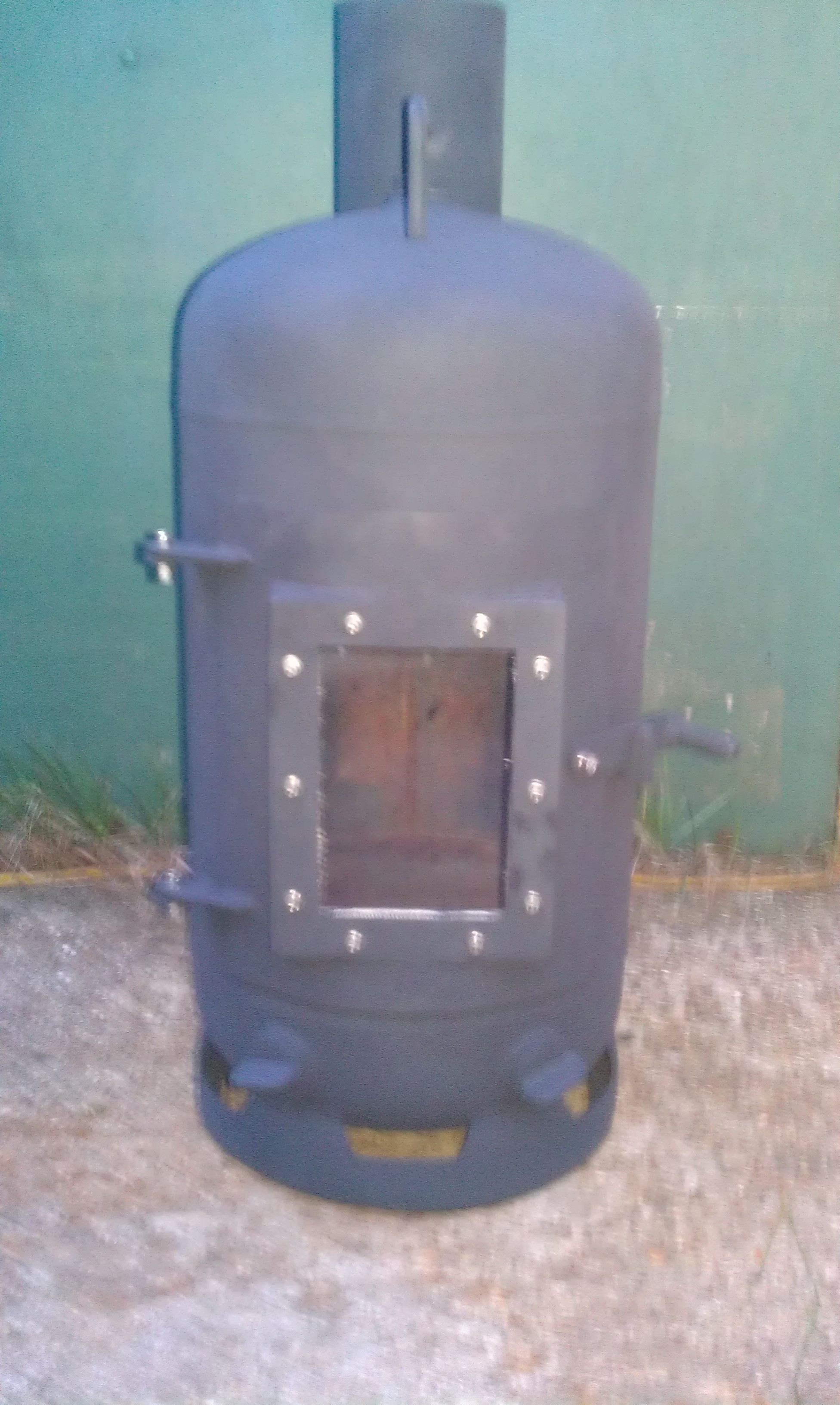

Made this one ages ago,cost next to nothing. Just put a baffle plate inside,so hopefully minimum sparks.
I like stuff that has more than one use. Next bit of this project is a length of copper pipe coiled round the bottom bit of the flue to act as a water heater.

Very nice! Wish I was handy and able to make stuff like that. Or at least, I with I had the cash to buy one already made for my shed. ;)

Yeah, I kind of want to make one but I'll probably use an ammo can as I have a bunch sitting around and its easier to cook on a flat surface.

I made this one.

Thought you might. This is in the front room, used all last winter, very cosy :D

I'm in the process of building one out of a small Calor gas bottle, I just got to wondering how big do I need to make the chimney? currently I made a hole big enough to take a short length of scaffold pole, (I use what I can find / scavenge) do let me know if you this needs a lager diameter, cheers "H"

A small stove (like those little pot-bellys they put in narrowboats ) needs a four inch flue so I'd of thought starting there and getting bigger as the stove increases in size.
What size bottle you using ?

errrrmmmm its sized as a 10kg so not massive, a quick google has the outer Dia of the scaffold pole 48.3mm O/D x 4mm wall this will be a short section with a length of ally platform post that slots over it....... or so I planned things !?!??!??!

About a foot across and two feet tall ?
Probably going to need a bigger flue then a scaff. pipe...... Suck it and see, but I think you might be a bit short on draw.
