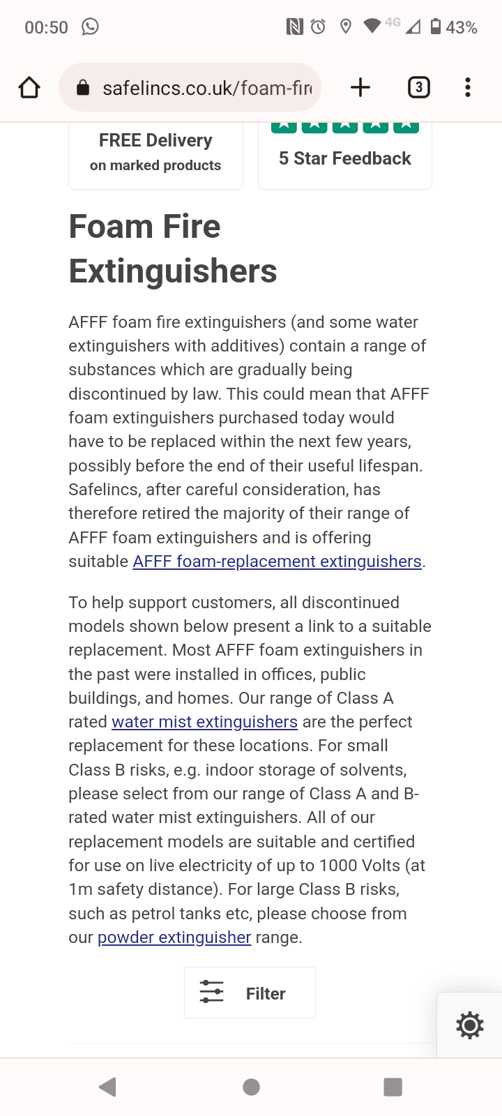

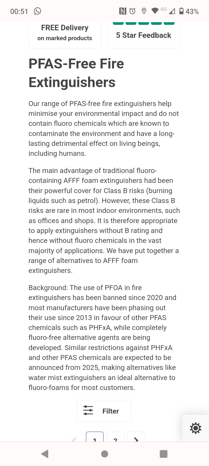

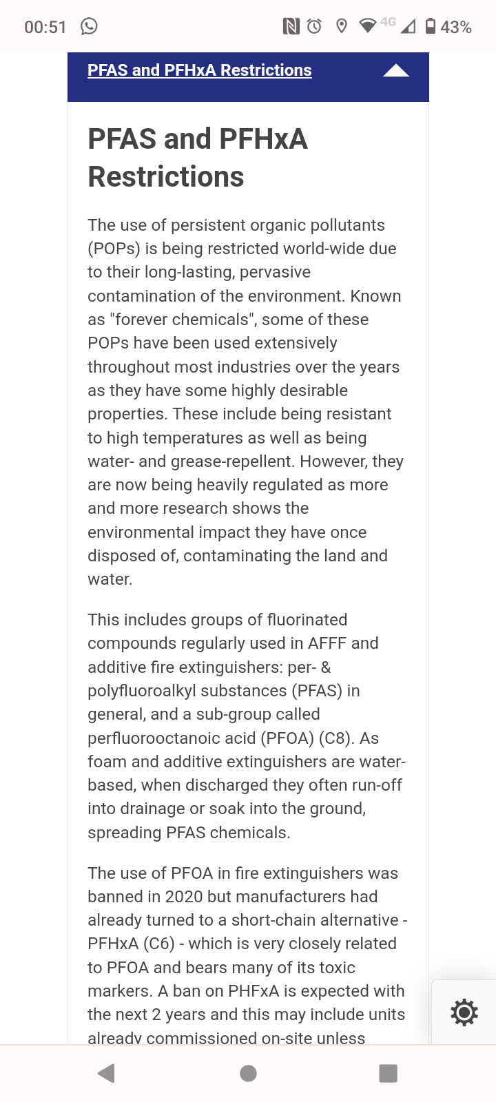

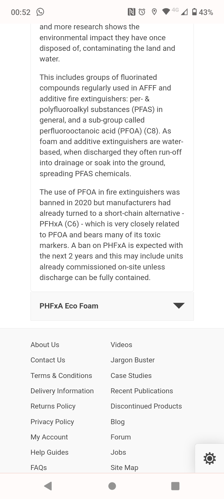

Just been browsing for a new extinguisher to replace an old one... Well it appears the environmentalists have scored another goal on the totally bonkers scale..
AFFF (Aquarius film forming foam) is becoming extinct
Which is a pita as Afff foam is bloody good at putting out flammable liquid fires .. I've used it in training and on real fires (large tar burner kettle fire and a large industrial plant machine engine bay fire to name 2 ) it just works....
Apparently there's 10million us gallons of concentrate in the US military alone not counting fuel refineries and similar... All to be disposed of
But tptb have deemed it bad.. much like they did with bcf (halon) 30 years ago or so...
Many suppliers are discontinuing Afff extinguishers early so stock up if you need any...
The screenshots uploaded back to front from safelincs most are steering people to water mist which is ok but it doesn't seal a class b fire so fail to put it out fully and the extinguisher runs out it'll re ignite
The end of Afff fire foam

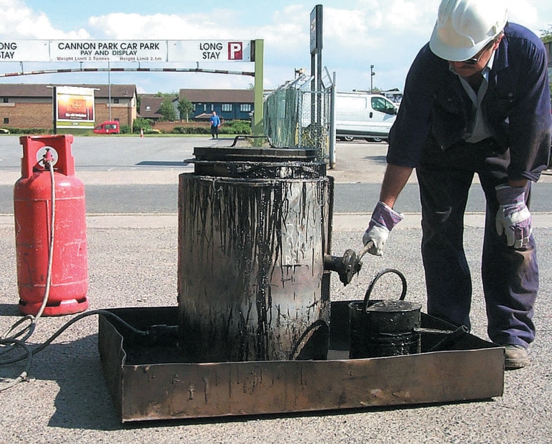

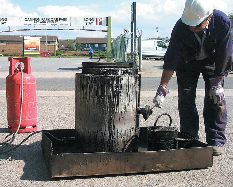

I've experienced it first hand a burning pitch kettle used for flat roofing gaffer had put a full bucket size block of pitch on top of an already full "bin"
Lit it and gone and sat in the office for an hour before work.... Thinking Eureka an hour's overtime...
Saw the smoke probably a mile before work....
Mate went and yelled him his response was er you best go out it out ..
9kg (the big) dry powder extinguisher did not work the fire kept reigning no matter how / what I tried ..
9l foam probably used about 6l to put it out but used the rest to cool / build up a layer of foam on top .. it did the trick
