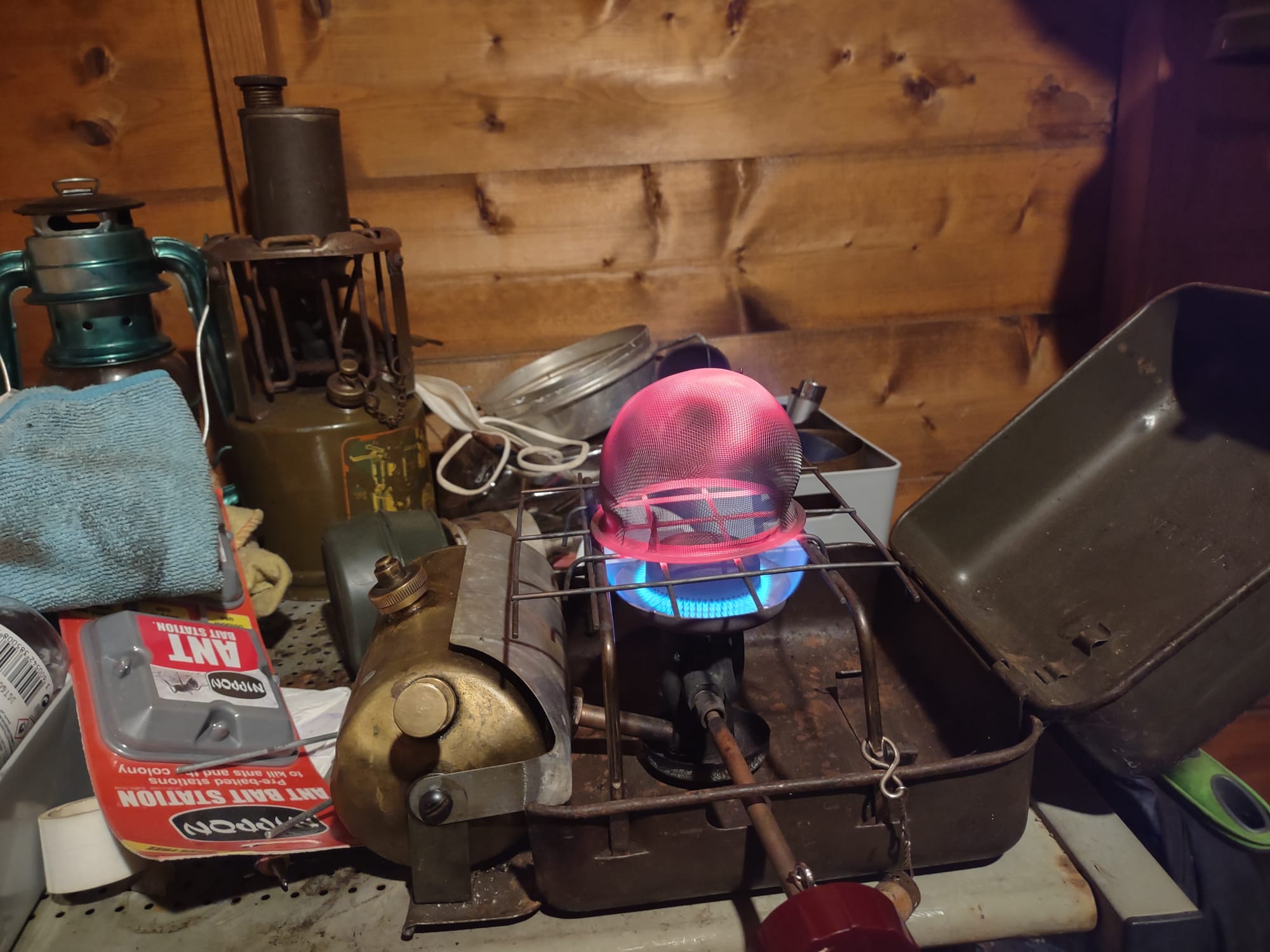

As some of you know, I'm a recovering stove collector so over the years I've played about with stoves/lanterns/heaters.
Paraffin as a fuel works great but unless you have access to a cheap source its expensive, 4l tubs going for £10-£15 and running a wick heater on full and your use 4l in 14-16 hours. You can use central heating oil which is cheaper but it will burn a bit 'dirtier'.
A few of us stovies have played around with veg oil in various mixes and its, messy, smelly, sooty, PITA to be honest and running in a Primus type pressure stove it clogs up the jets which need frequent pricking to clear and you get a high carbon residue build up in the burner pipes so for me I'd not use it. Diesel is not bad but again sooty but will run in a Primus.
Ethanol has about 30% less energy content over paraffin so you may end up using more fuel for the same heat output.
Wick heaters are fine the flat wick and round wick are much easier to maintain than multiwick heaters/stoves and as the old saying goes, "keep your wicks trimmed"
This stove is an Optimus 111T and burning paraffin, 10,000 BTUs or getting on for 3kw. The mesh dome is actually a tea/coffee strainer. The stove is designed burn paraffin/coleman/ethanol with a good adjustable flame control; great stoves easily in my top 5 stoves of all time.

pseudonym wrote: ↑Wed Nov 09, 2022 2:07 pm Loved my 111T, if you were up, your neighbours were up as the roar echoed through the woods :twisted:
The 111T is the 'silent' burner type as in the picture, just gives of a hissing sound, the standard 111 is the paraffin only 'roarer' burner and is pretty loud (there is the 111B which was for coleman type fuel).
