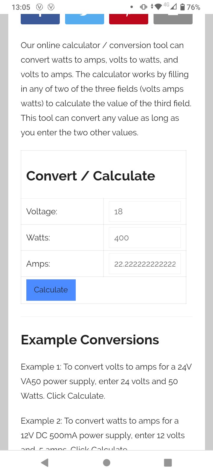

Andy: What would you suggest as a good fusing arrangement for a 400W design charging multiple 7AH AGM batteries? Any particular products you would recommend?

There's masses of different options
Fuse the panels incomer
Assuming the cable that comes in to the charge controller can take the max current from the panels
And assuming the panels shove out 18v which immsmc that's what mine do
So I'd fuse it initially at 25A if I get any issues of it blowing I'd measure it then amend accordingly
For accessories I use something like this available in many sizes
https://www.ebay.co.uk/itm/322464684815 ... R46Es7n7YA
One big fuse at one end then common across the other terminals so it's got one supply then outputs all come off it
Then the outgoing ive got a big inverter so that's got its own overload trips supplying it s got its own internal fuses but it's slightly smaller than the rated fuse so it trips before I've got to go dismantling and resoldering internal fuses
https://www.ebay.co.uk/itm/204000810663 ... R_yJ-7j7YA
