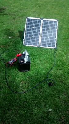

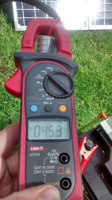

The good Bosch 60w folder I've got with a charge controller puts out a good 4a on a bright day might put out more depending on the charge controller Vs the state of charging of the battery..
