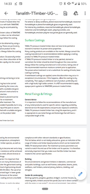

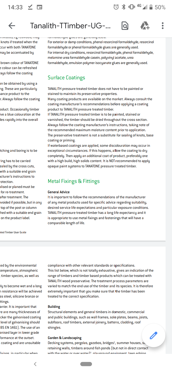

- Posts: 10013
Re: New Shed questions
From the book.......
