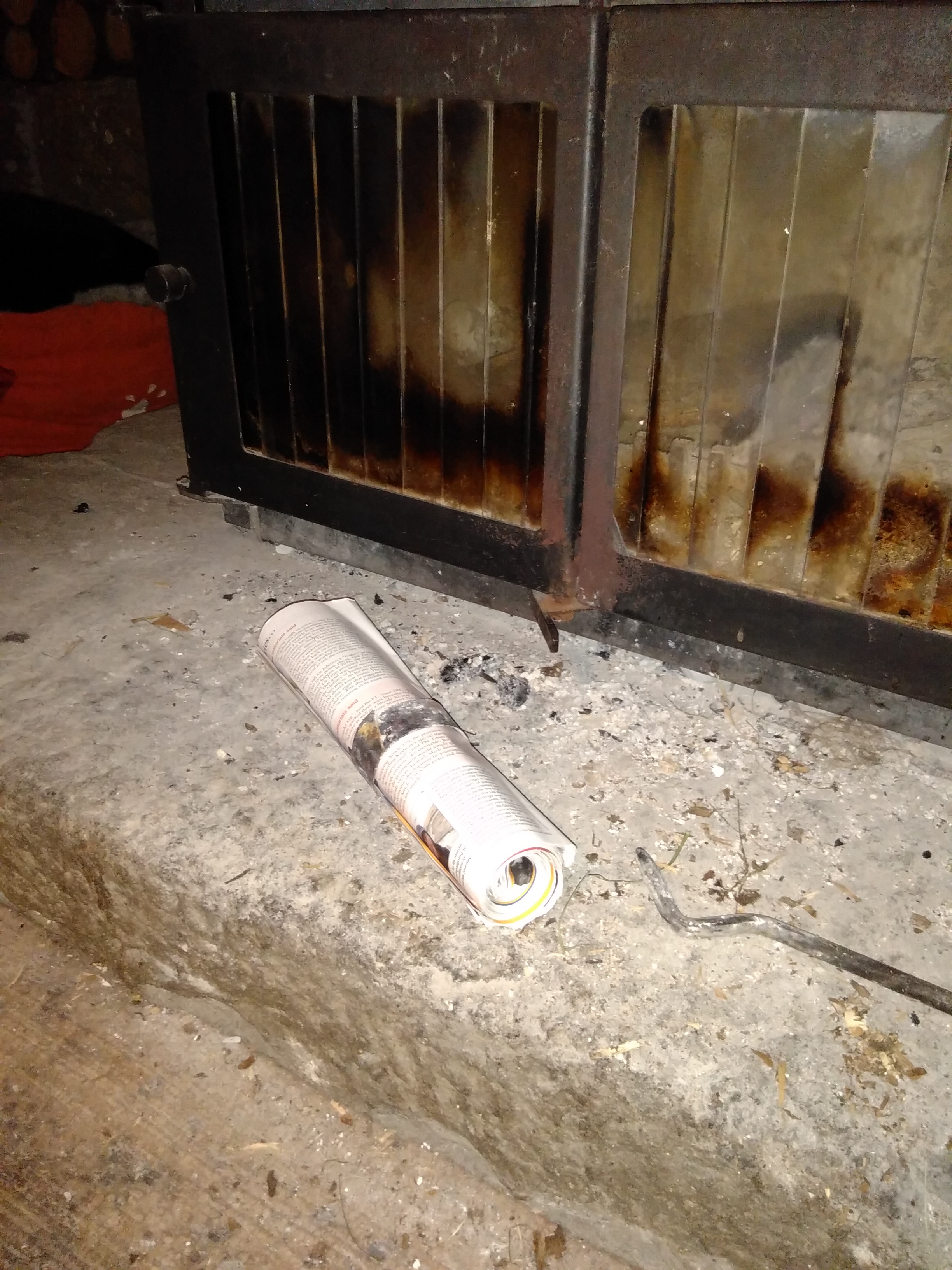

Another option for waste paper/magazines/newspapers is instead of mushing them & using the pulp to make briquettes is instead to just roll them up really tightly and slip a metal ring over them and throw them on the fire, much simpler & quicker.

To be fair, my method is simply to use waste materials. I always have sawdust about, and always have cement in for running repairs. Nurseandy’s paper roll works too. I have used rolled newspapers and tied them with wire.
