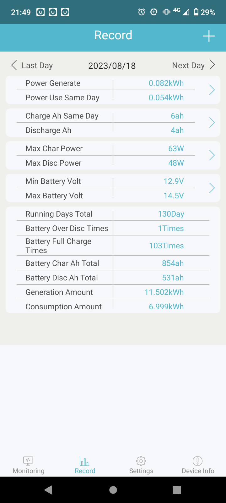

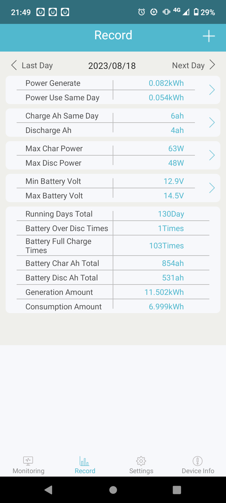

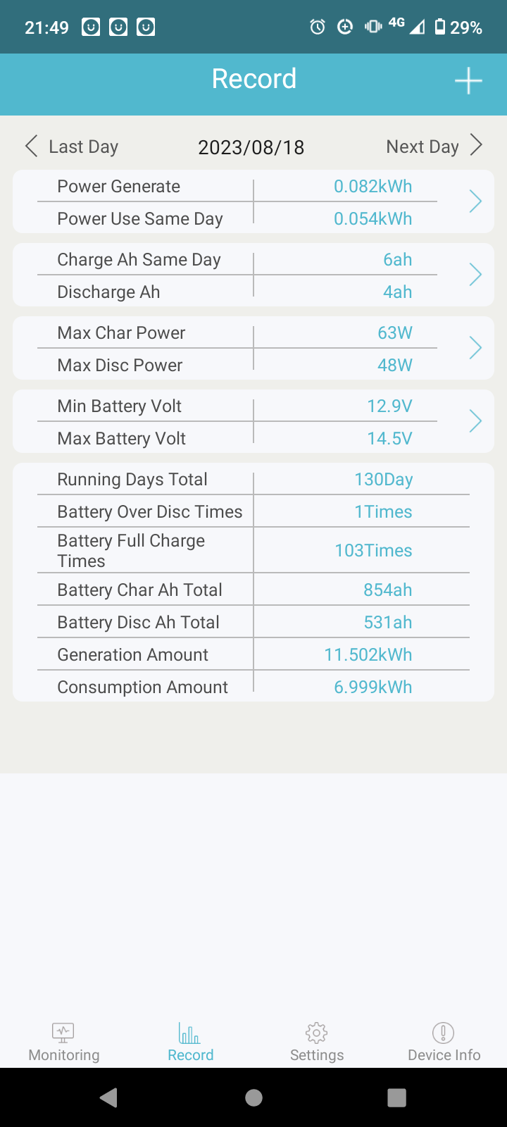

Nice, what sort of difference in Wh have you noticed since switching the controller?

I'll be honest I've not had the meter on it since I upgraded sort of had to do the jump in one big hit.. leisure battery died ... Decided on lithium iron phosphate so needed a controller compatible battery all in almost one go and whilst I was at it I banged another panel up since I was relocating the other on to the roof one big hit but since spring I've not needed to do anything to itdeckard wrote: ↑Sat Aug 19, 2023 8:35 pm Nice, what sort of difference in Wh have you noticed since switching the controller?

Screenshot from the Bluetooth connection
I'm not even close to kicking the backside out of it
There is a irregular bit of data between consumption and generation the inverter is direct to the battery so it doesn't measure consumption from that

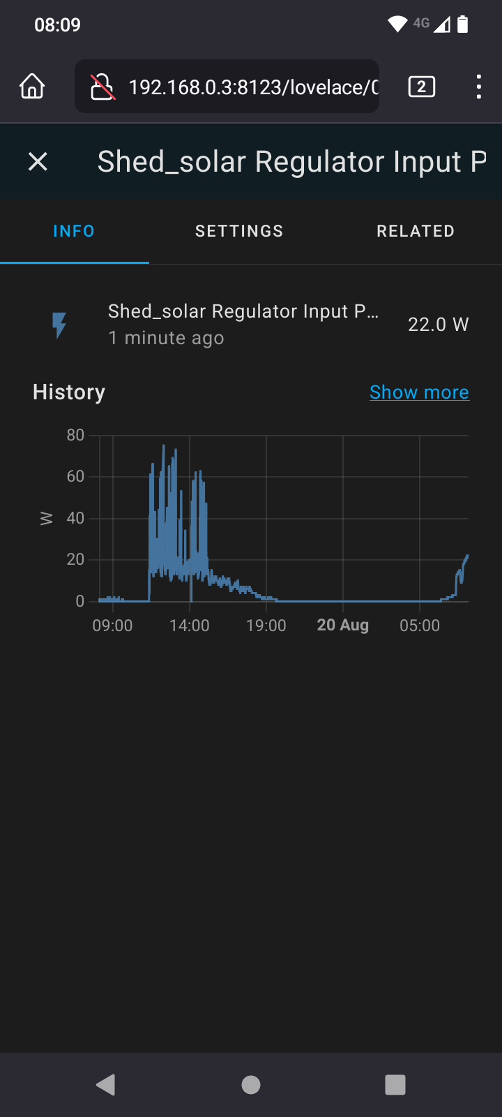

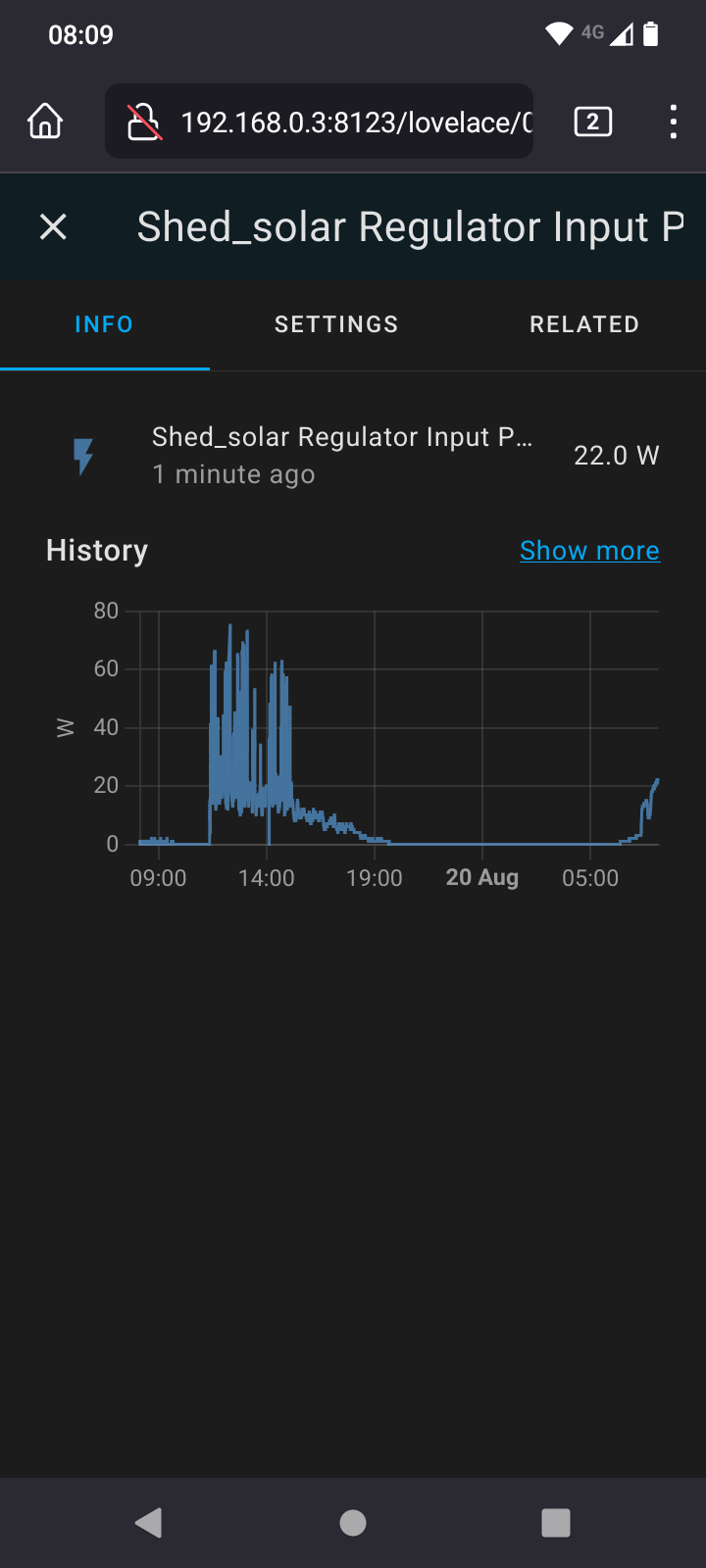

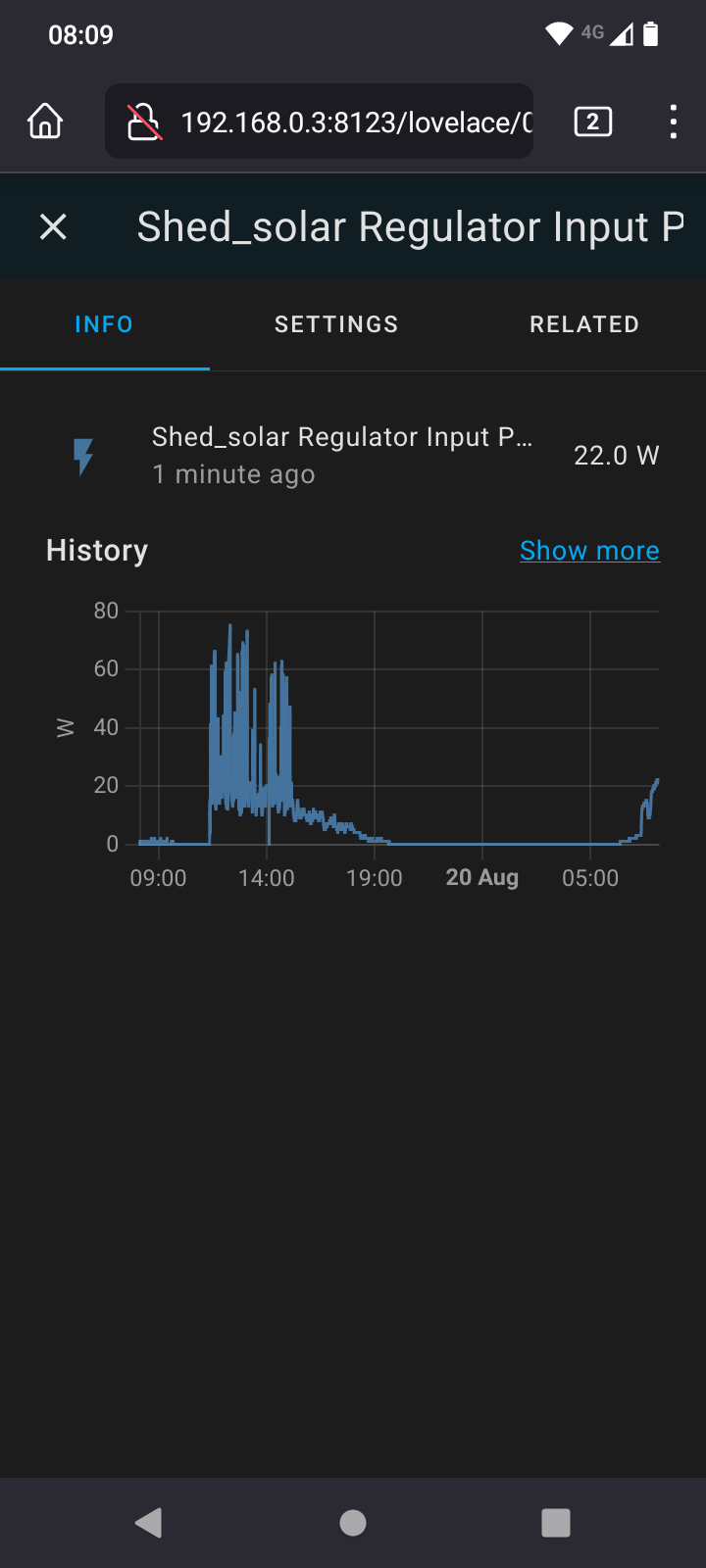

I've got all the metering you mentioned, and the controller data goes into homeassistant;
I don't do any automations off the data yet, but i may do one day.
