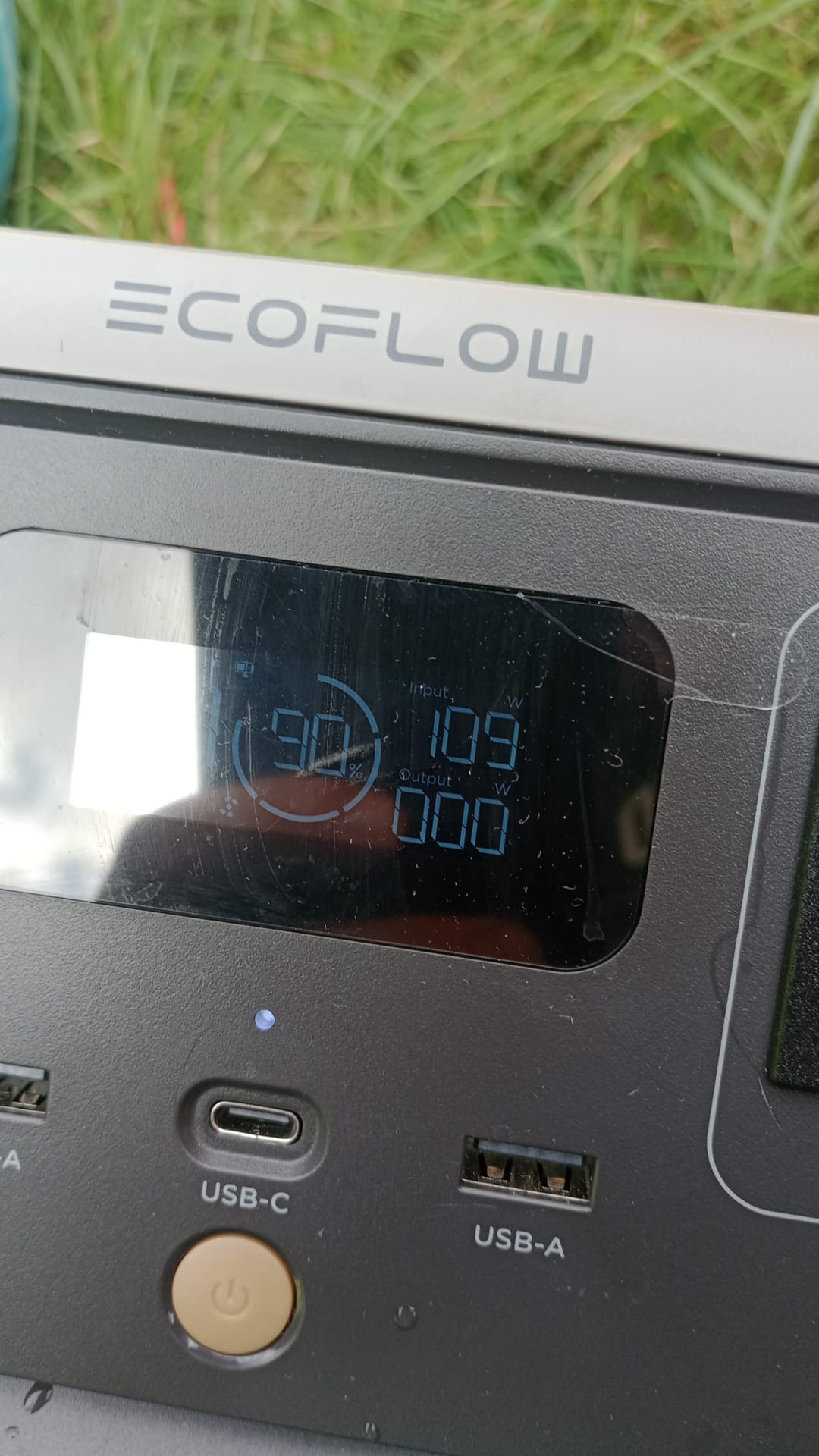

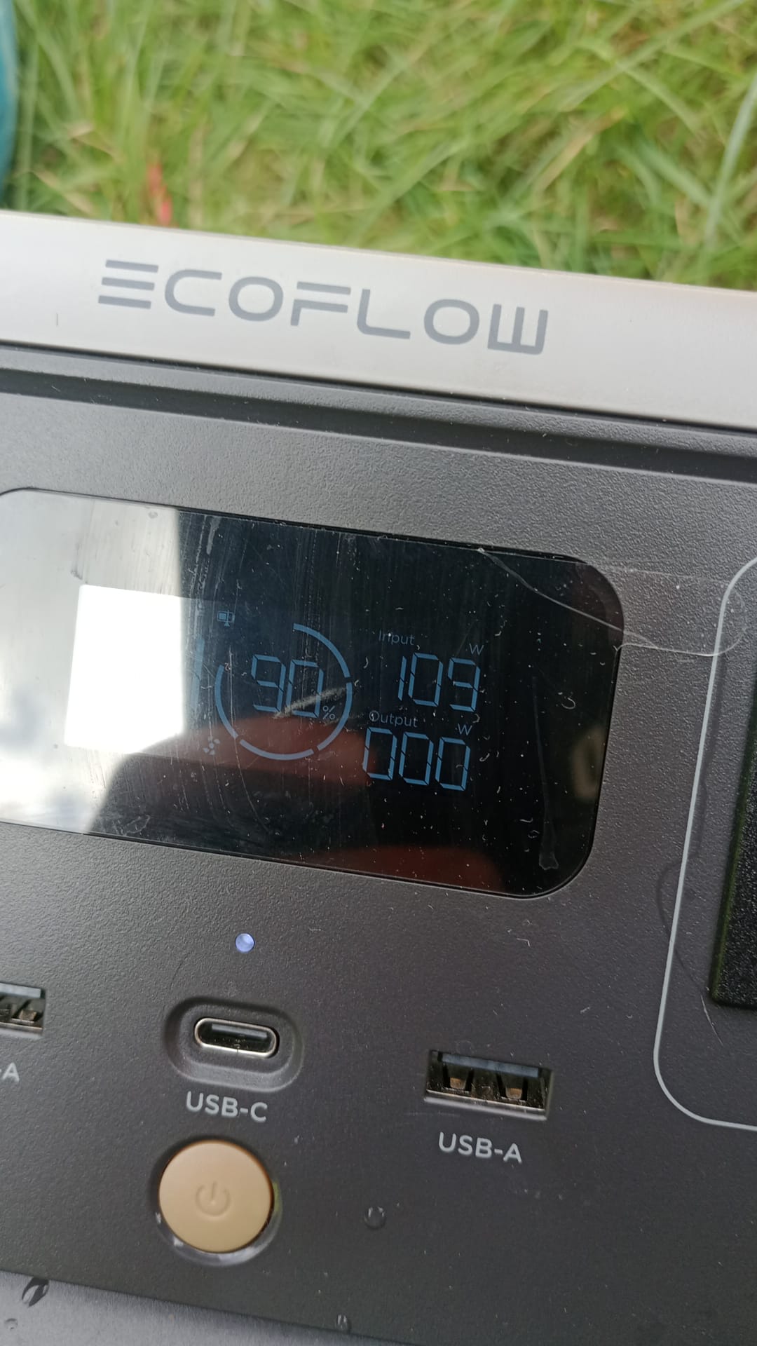

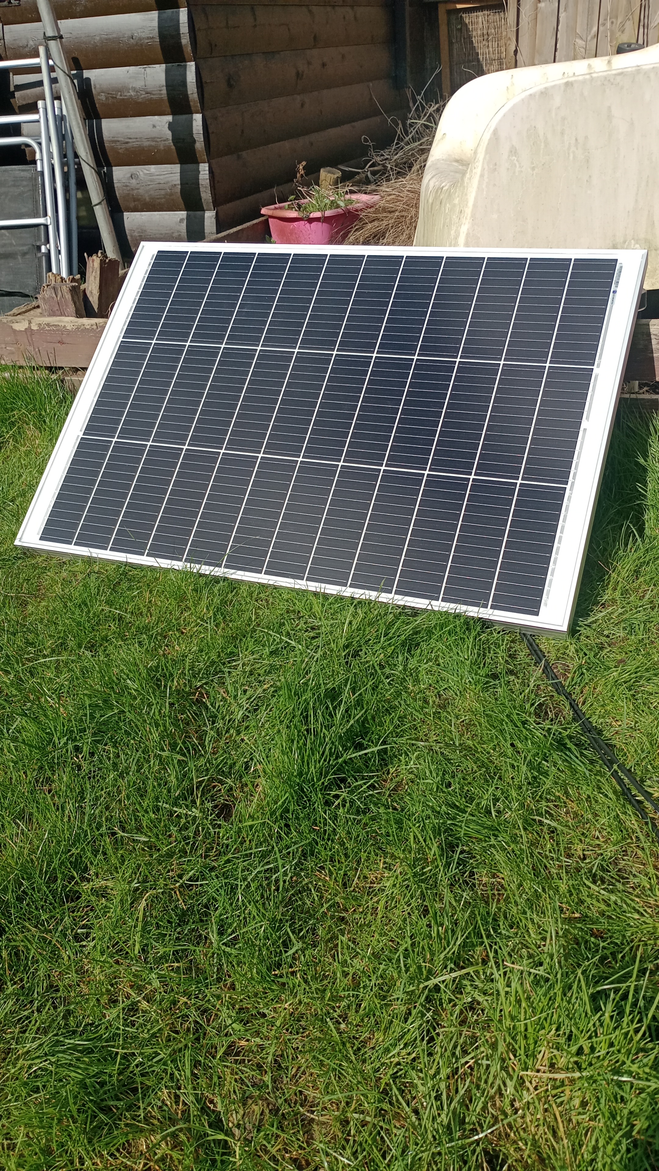

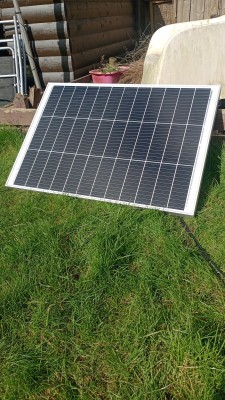

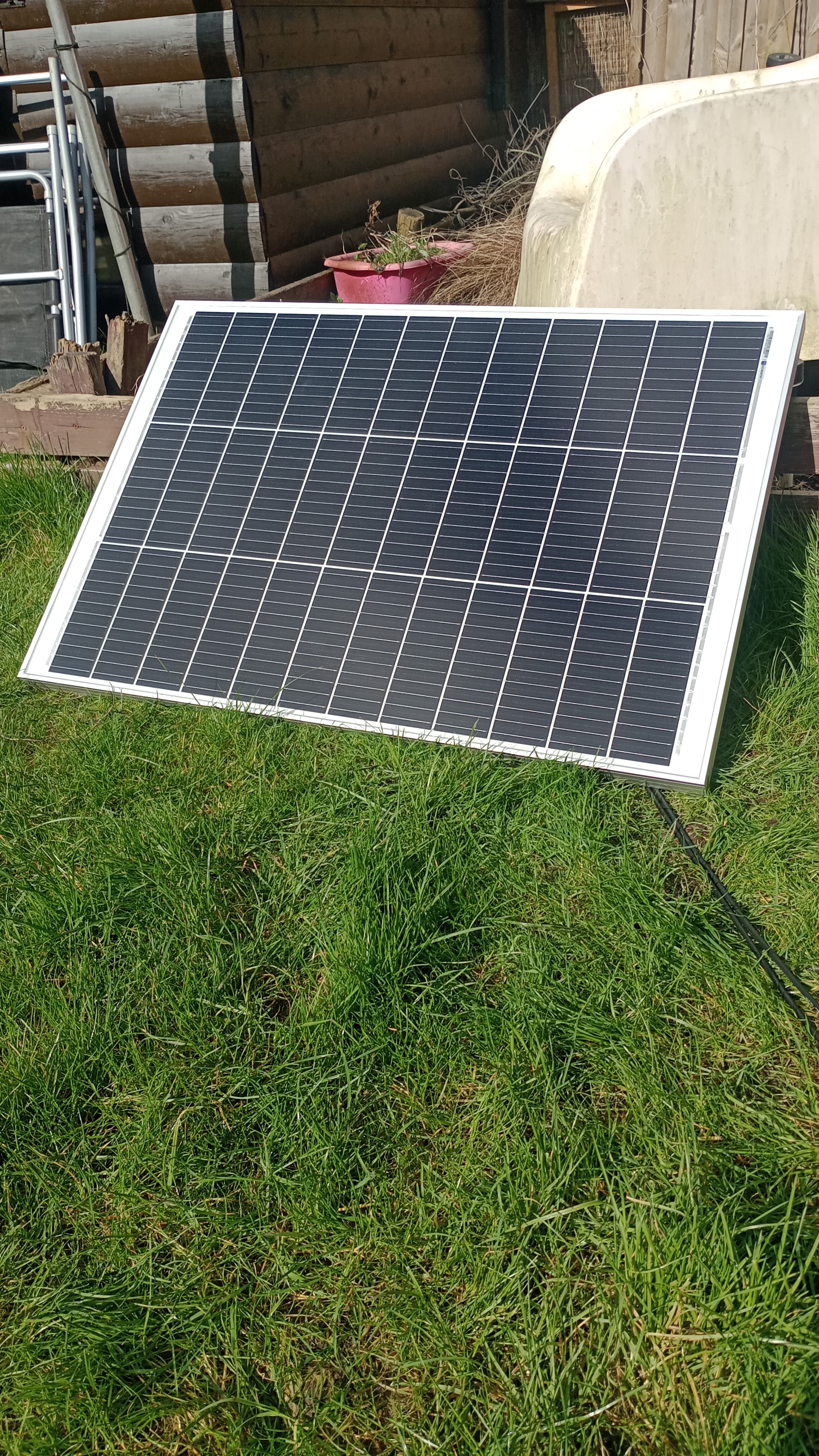

Little testing done today ...
Spring sunshine it's pushing 109w happily enough about 20 when it clouded over
Posts: 3490
Re: Solar panel bargain...
Yorkshire Andy wrote: Sat Mar 16, 2024 4:32 pm Little testing done today ...
Impressive. I'd never expect to get anywhere near 90% of rating in this country.
