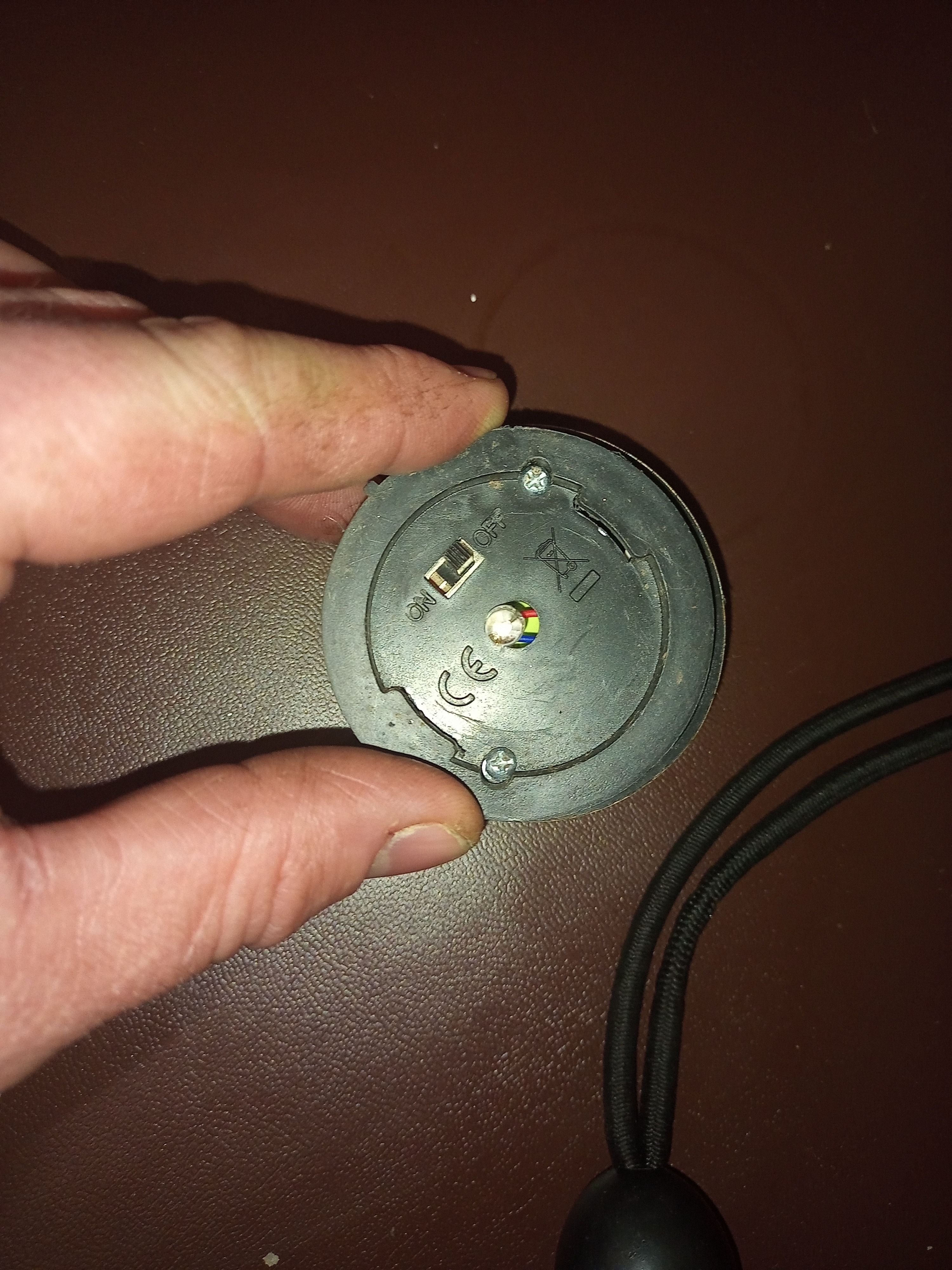

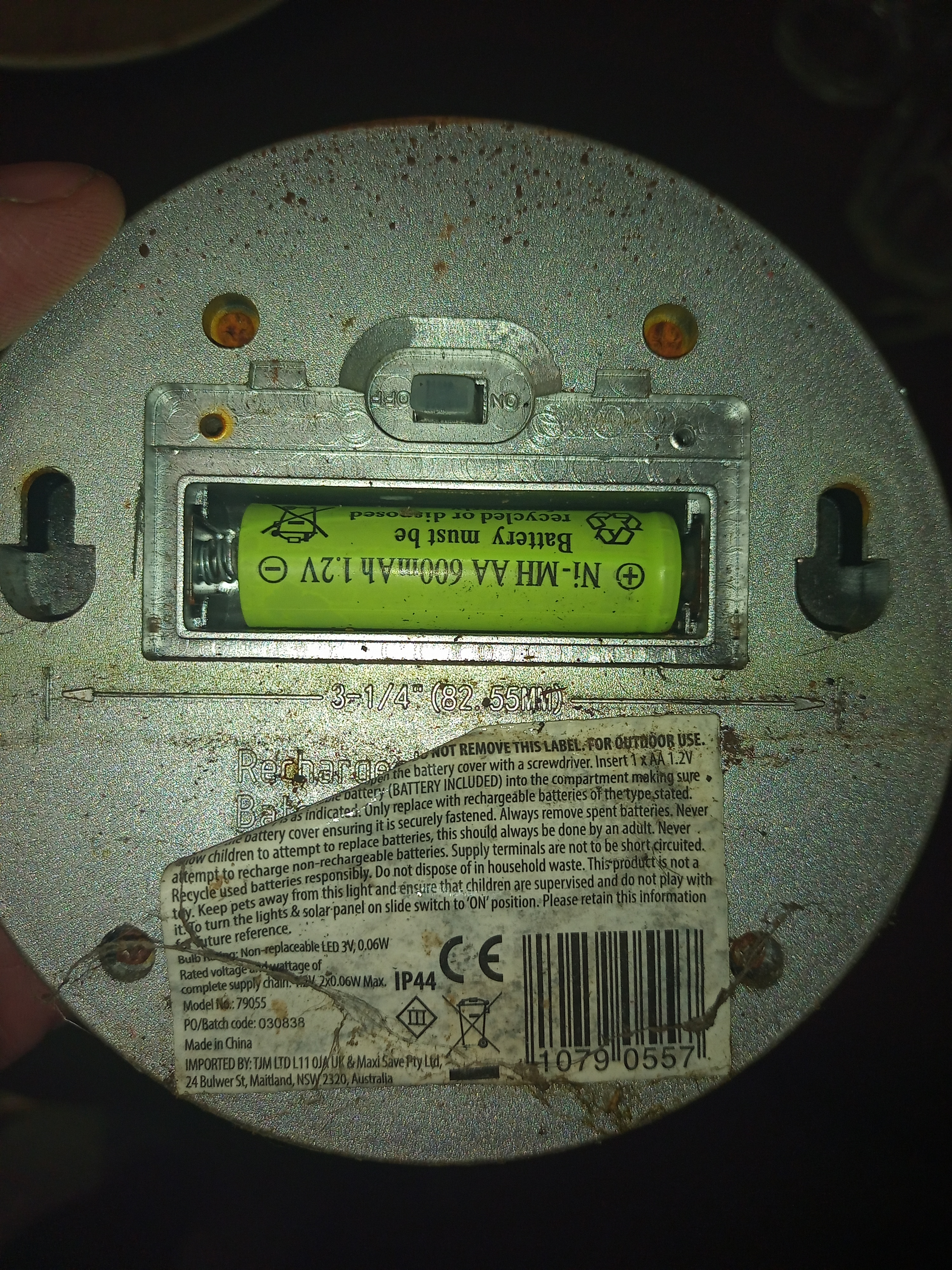

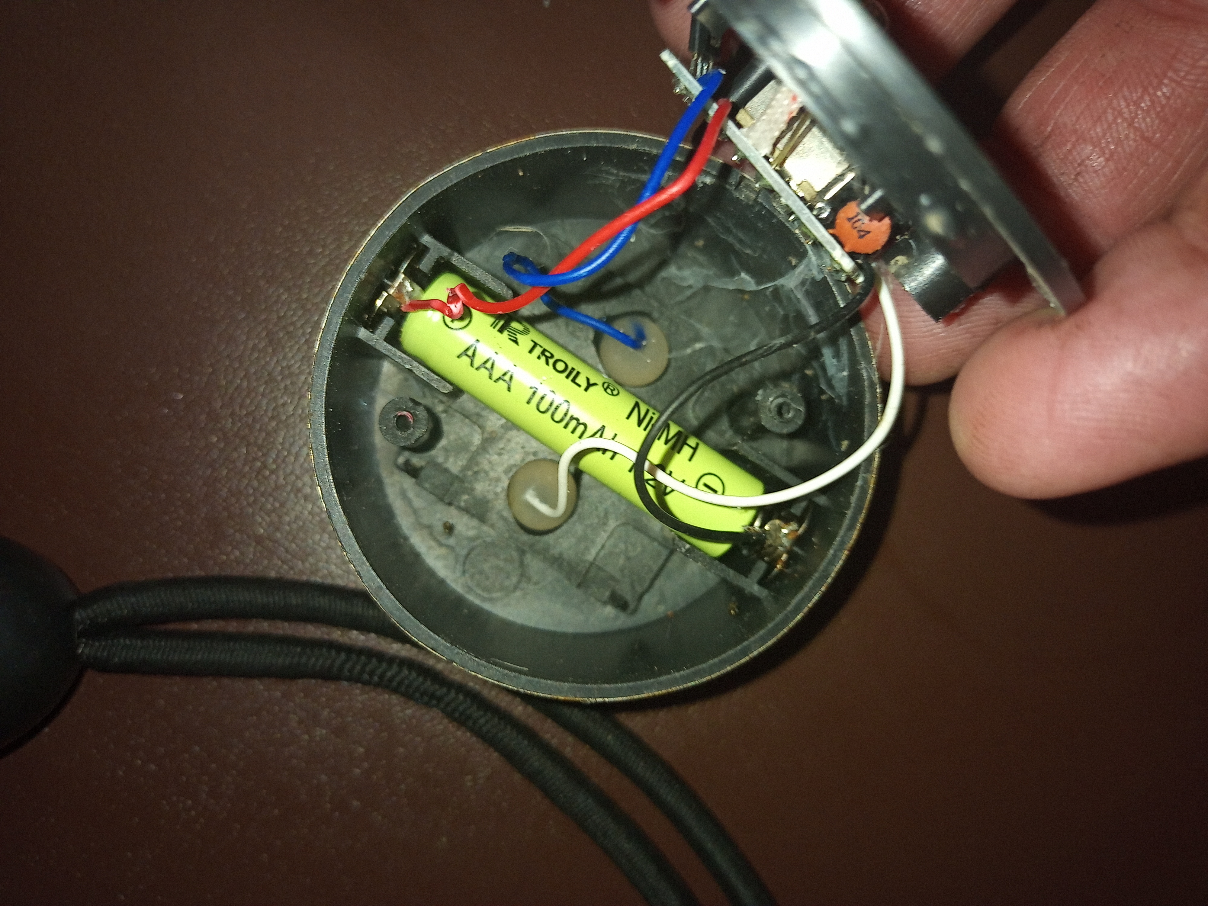

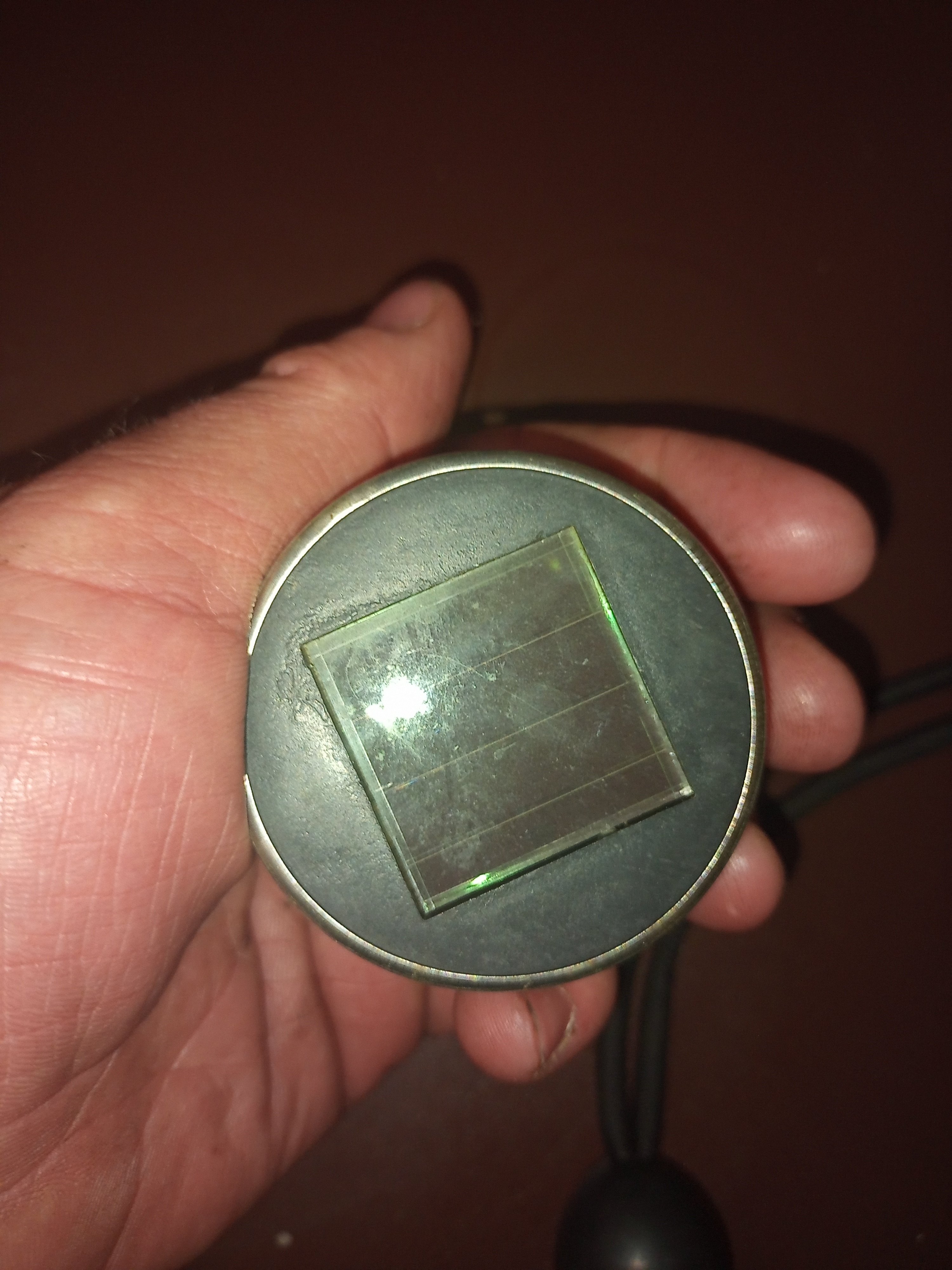

Think I mentioned this a few years ago .. but just been out and sorted a few garden lights that had stopped working.....
B&m / home bargains / quid shop / DIY shop garden section often have the generic solar garden lamps in fairly cheap. Some granted have some silly odd ball button cell battery pack inside....
Others however have AAA / AA cells and some very basic low capacity batteries which as you will probably be aware don't last long but the lamp can be bastardised and used to charge decent batteries should shtf don't expect fast charging but some charge is better than no charge...
In most cases it's a matter of unscrewing the cover putting a decent battery in and parking it facing the sun ..
Bit more involvement in chopping off the led means no load so it won't drain over night some switches turn off the led others take the battery out of circuit you can soon soon determine what's what with a multimeter...

Just back from Home Bargain. They have basic LED solar lights for 79p each or £7.99 for twelve. Quite similar to the one YA showed, the top black bit pulls off and is a self contained aaa charging station. The led does need snipping out though, because if it's turned 'off' the battery gets no charge and if it's turned on, it will light the lamp at night.
Contains a 600mA AAA and the LED is pitifully dim
But.... well.... What can you buy for £8/12 =67p?
https://www.homebargains.co.uk/products ... -pack.aspx
Experiment for the next sunny day will be to measure what charge current they can manage.

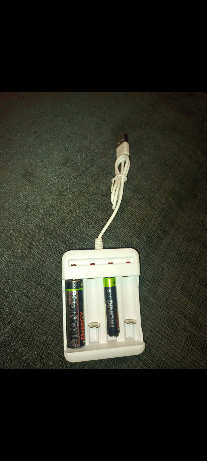

I might add one of those little chargers at £4, for my AAAs but to be honest, I anticipate using my lamps to charge my batteries in. Will work for 2 18650s or 4 AA. I don't know how efficient it is dropping the voltage down from 5 to 3.? but probably as efficient as that ebay one? But those lamps don't do AAA, so there is that.
Have you seen this Andy? USB charger for 4x 18650
https://www.ebay.co.uk/itm/354046104353

Not a bad deal at Argos (same price at Tesco) AA AAA USB fed charger with four batteries so just plug it into your cheapo ebay solar panel and away you go
https://www.argos.co.uk/product/9453885 ... ger:1:10:1
