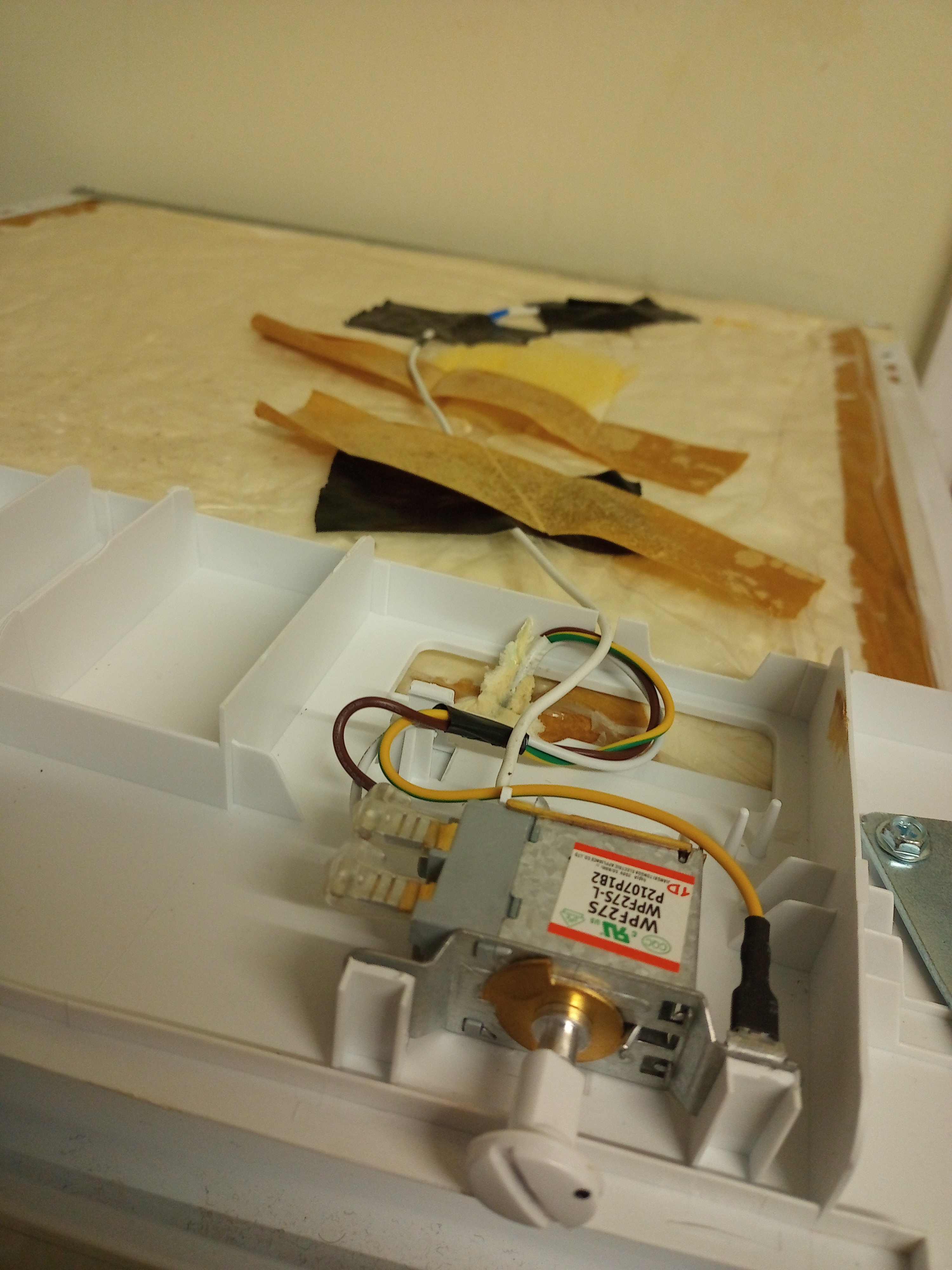

jennyjj01 wrote: ↑Fri Mar 11, 2022 4:34 pmINSPIRED! And bless you for fixing it and avoiding all that environmentally damaging waste.Yorkshire Andy wrote: ↑Thu Mar 10, 2022 10:54 pm Well next drama the flipping deep freeze is on the blink .. Looks like it's the thermostat on the blink. . . £40 lighter Vs £300 ish for a new freezer + loss of food it's full!
and a new one here tomorrow by post...
It's currently running fine having linked it out....
Always pays to have some random terminal connectors and wire in the shed.. it's currently running on a plug in timer half hour on an hour off seems to be working but not overly energy efficient![]()
Glad I was like my little lad is and constantly followed my dad round watching asking why a lotas it didn't take long to diagnose it will be simple enough job to swap it 3 wires and the capillary tube remember my dad doing the fridge stat when I was little
Well the thermostat landed in about 12 hours from ordering to delivery

Brief description of the task ...
Unplug from mains
Remove 2x screw caps
Remove 2x screws
Lift off the top of the freezer
Open freezer remove top draw. Pull and push the old thermocouple out through the insulation (mark the hole with a marker pen)
Unclip 3 wires mentally note where they go
Unclip Thermostat and get new one ready .. carefully bend the capillary tube being careful not to kink it
Push new capillary tube into insulation into freezer cavity locating it into the little tube it sits in..
Clip in new thermostat
Retrieve old thermostat from the bin and pull off the adjustment knob
Push on wires
I resealed rte the capillary tube hole with a drop of pu gorilla glue
Tape capillary tube in place I am used duct tape
Refit lid
Plug in and switch on ..
Set thermostat

Excellent firm - one of my previous clients. Good solid West Midlands organisation, still run by the family.Yorkshire Andy wrote: ↑Fri Mar 11, 2022 8:15 pm
Well the thermostat landed in about 12 hours from ordering to deliveryDPD man turned up before 9am! Was about 10 to 9 last night when I hit order just before the next day cut off.... 8 quid next day delivery can't grumble for the service they do candy / hoover parts so £38 all in cheaper than a new freezer

By the way - bloody impressive skills - count me impressed.Yorkshire Andy wrote: ↑Fri Mar 11, 2022 8:15 pmjennyjj01 wrote: ↑Fri Mar 11, 2022 4:34 pmINSPIRED! And bless you for fixing it and avoiding all that environmentally damaging waste.Yorkshire Andy wrote: ↑Thu Mar 10, 2022 10:54 pm Well next drama the flipping deep freeze is on the blink .. Looks like it's the thermostat on the blink. . . £40 lighter Vs £300 ish for a new freezer + loss of food it's full!
Unplug from mains
Remove 2x screws
Retrieve old thermostat from the bin and pull off the adjustment knoband fit to new stat
Push on wires
Refit lid
Set thermostat

Cheers among past jobs electricians mate , telecoms firms electronics soldering / storeman, maintenance fitter , along with DIY car mechanic gardener / allotment holder I can turn my hand to most tools and tasks .. uncle and FIL are both electricians if I get stuckBritish Red wrote: ↑Fri Mar 11, 2022 8:27 pm
Genuine OEM Kenwood element was £25 posted .. about 8 screws and 10 minutes and it was cooled pulled out new one fitted and put back . Following a quick insulation test with my megga insulation tester . know people have overheads but £175 is one hell of a markup (before thinking he can probably get parts cheaper on account) I
