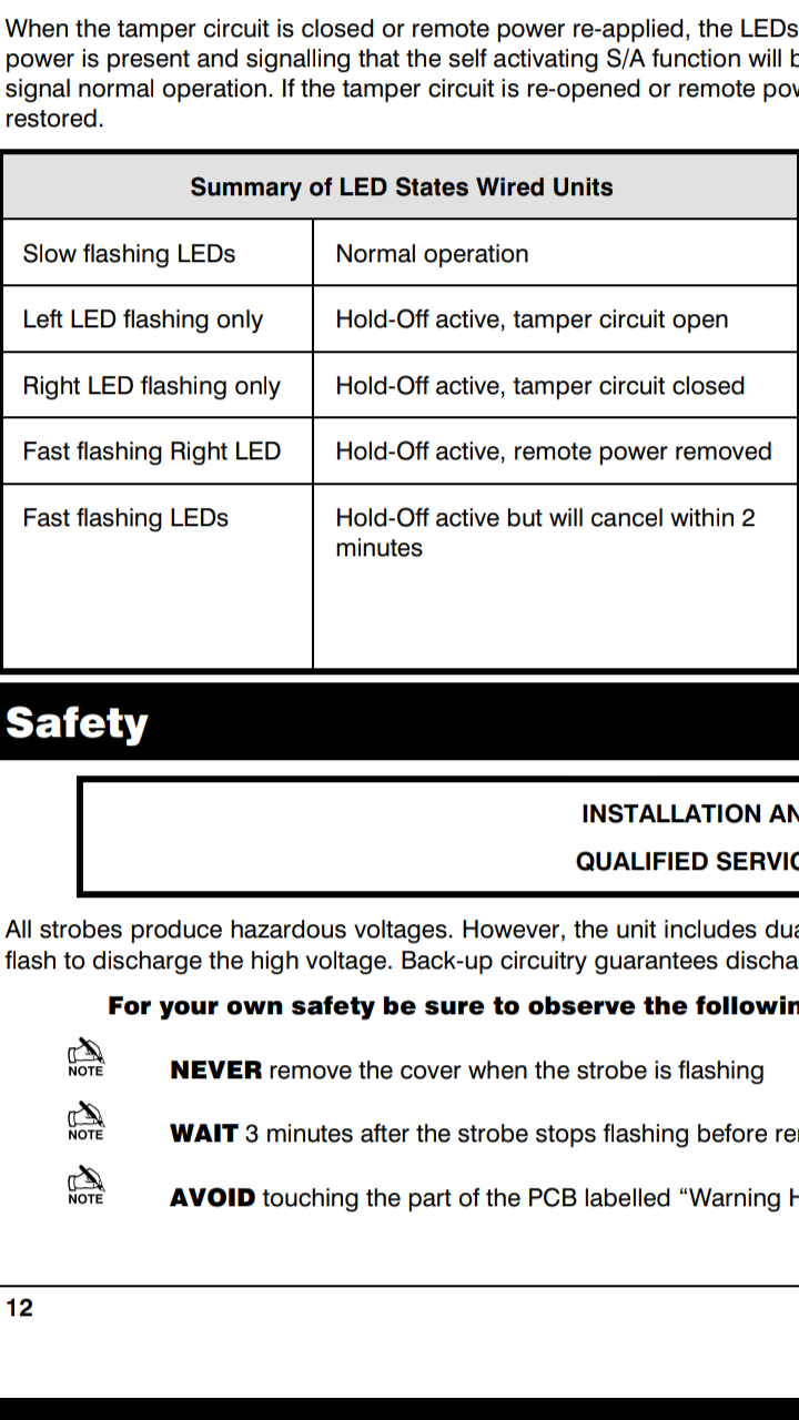

To be honest I've never seen that on a UK bell box and I've worked with electrical contractors fitting systems...Maydonnell wrote: ↑Sat Jun 01, 2019 12:25 pm I did not know this about the lights on the alarm boxes. That's straight up a security flaw. I can't believe companies that sell alarm boxes would have something like that go out.
Early ones had a static led glowing... Later units flashed after that they introduced "status" indicators which in the case of a texecom have a tamper indicator and a bell inhibition light used for servicing and status checking as in has someone tampered with a alarm to a outside security contractor glancing up at a bell box one light out of 2 not flashing indicates s issue
It's no lights on that catches the trained eye when they should be.. I know for a fact the neighbors system has been deactivated
