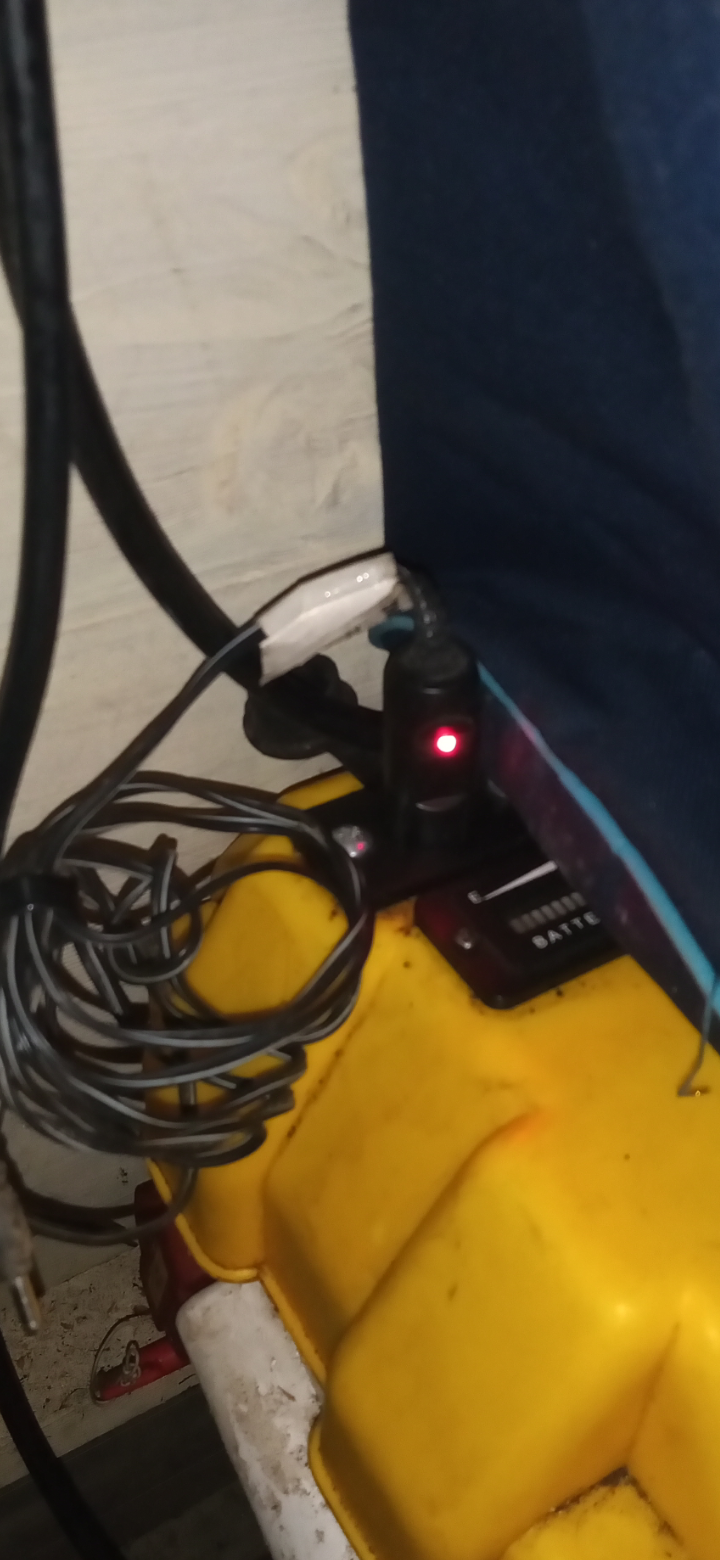

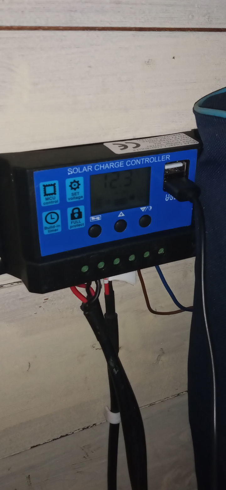

Yep it's in regular use in my shed I've 60w of solar panels on the roof feeding it it just about keeps up through winter but does get the odd boost from the mains when I drag the extension lead out to run the tumble drier ..
most of the stuff I run from it is usb or 12v (chargers and lights) inverters are just purely inefficient thought I do often run smaller things like the drill charger from it

Which is why my box has usb outlets on the charge controller
And a 12v outlet
If I'm running a generator I'd be boost charging power banks / leisure batteries whilst it was running. To store power for later
I've got a workshop fast car battery charger and several usb 2a chargers and the associated leads for the power banks
