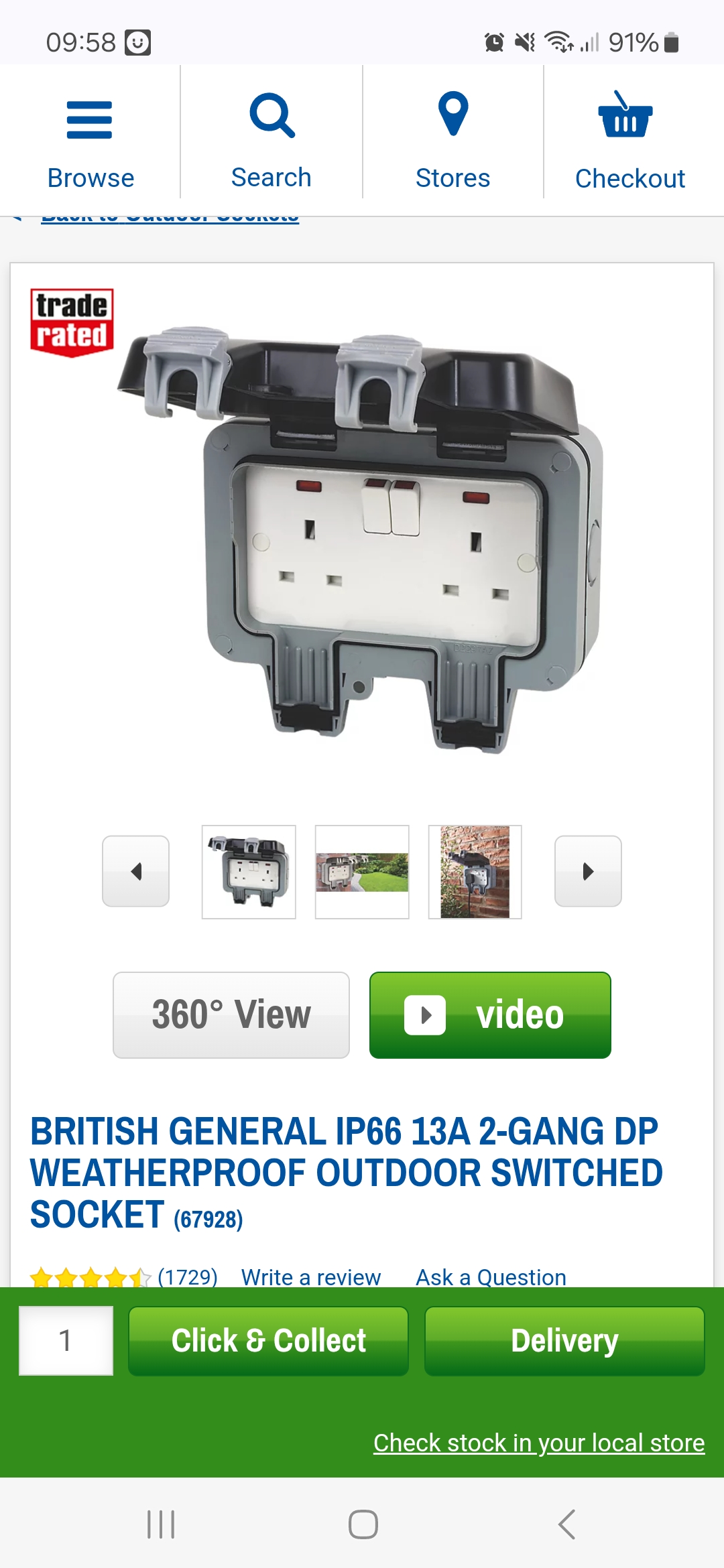

That's the garden shed finally wired to the mains ... as we are renting its powered by a heavy duty plug in the kitchen .. the previous Tennant must have had power to the old shed as I ahem found a hole through the wall ;) ;)
Decent ho7rnf 1.5mm² outdoor rubber tuff flex which is used to wire site cabins etc on building sites submersible pumps and Is rated for sustained outdoor use
Wired to 2x double watetproof sockets screwed to the shed wall do basically a DIY 4 way plug strip most use 1mm2 cable I went nice and beefy so the tumble drier will be nice and safe and not overload the cable and if at any chance the inside of the shed gets damp it'll still be safe
Just needs clipping up at some point
Posts: 10368
Husband was another one who "found" a hole through the wall Andy. From kitchen to shed. He did the same setup but not heavy duty cable as he didn't run anything like a drier in the shed. He had a tv and fancy lighting instead :mrgreen:
Posts: 10015
diamond lil wrote: ↑Sun Jan 19, 2025 9:23 am Husband was another one who "found" a hole through the wall Andy. From kitchen to shed. He did the same setup but not heavy duty cable as he didn't run anything like a drier in the shed. He had a tv and fancy lighting instead :mrgreen:
Did the maths for the cost it was £2 cheaper for the correct cable over the usual less robust extension cable/ appliance flex (ho5) which isn't uv stable
And I used waterproof outdoor sockets as they marry up well with the cable using a item called a compression gland to secure the cable. If the roof leaks for example or it gets very damp the sockets are safe
All wired then tested earth connection all good and nice high resistance readings between all the wires via the insulation testet (I've got a pat testing machine that work was putting in the skip and it fell into my car boot and a megga ) :mrgreen:
Just need to go raid my dads garage for some cable clips :lol:
