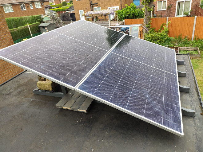

A major advance in our solar adventure.
The Ecoflow Stream Microinverter arrived which prompted me to nudge MrJJ to install the solar panels, which he did today.
I just have to show off his handiwork
See pics below.

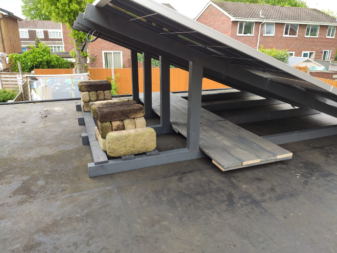

The mountings comprise 4 x angular frames made from treated and painted timber.
Pitched at 20% as a compromise between solar efficiency and wind resistance, These panels are HUGE 2.4m x 1.2m and 605W each!!!! They weigh about 33kilos apiece.
For ballast, we currently have about 100kg of concrete bricks and there is a ballast tray on which I intend to load four bale arm trays full of bottled water. Might as well use the storage space.
We still need to install the inverter inside the garage, once we have procured 4 x 5m PV extension cables ( Or I could mount the inverter under the panels )
*Evil ecoflow sneakily didn't include PV cables, having changed what's in the bundle.

Is the house on the left in the pics, so it will block wind coming from that side getting under the panels? I assume they are fixed to the timber.
I wouldn't have the space. My garden is long, but even narrower than the house, which is terraced, and the hedge takes up a chunk, and would block the sun to a large extent as well. The fence on the left does face south though, as does one wall of the kitchen and back bedroom. Back of house faces NWN so only gets sun in the morning.
Re: Home Solar System
Thanks. He was pretty quick with his power tools. Blame me for the design where I had to relearn all about triangles
Next door is on the left and mine is on the right, but offset, forward. It stops wind coming direct into the 'sail' of the panels. They are not screwed down and we are trusting several hundred kilo of ballast to hold them. More to be added.Is the house on the left in the pics, so it will block wind coming from that side getting under the panels? I assume they are fixed to the timber.
Mine will get max sun between about 10am and 1pm then will start to get shaded by my house until about 3pm. Before and after that, they will be at a bad angle looking 90ø away from the sun. Far from ideal. I might try facing them West so they max out in the early evening, but that will mean they get very little before 3pm.I wouldn't have the space. My garden is long, but even narrower than the house, which is terraced, and the hedge takes up a chunk, and would block the sun to a large extent as well. The fence on the left does face south though, as does one wall of the kitchen and back bedroom. Back of house faces NWN so only gets sun in the morning.

Oh, is this on a garage roof?

So thats 4*605W? 2.4Kw? How are you going to wired them into the micro inverter, as I though they only has 2 MPPT channels? Or is that 2 panels? Hard to tell.

yes. Flat rubber roof
2 huge panels on 4 triangular brackets. So 1 per channel.GeraldTheBonzai wrote: ↑Mon May 04, 2026 11:55 am So thats 4*605W? 2.4Kw? How are you going to wired them into the micro inverter, as I though they only has 2 MPPT channels? Or is that 2 panels? Hard to tell.
