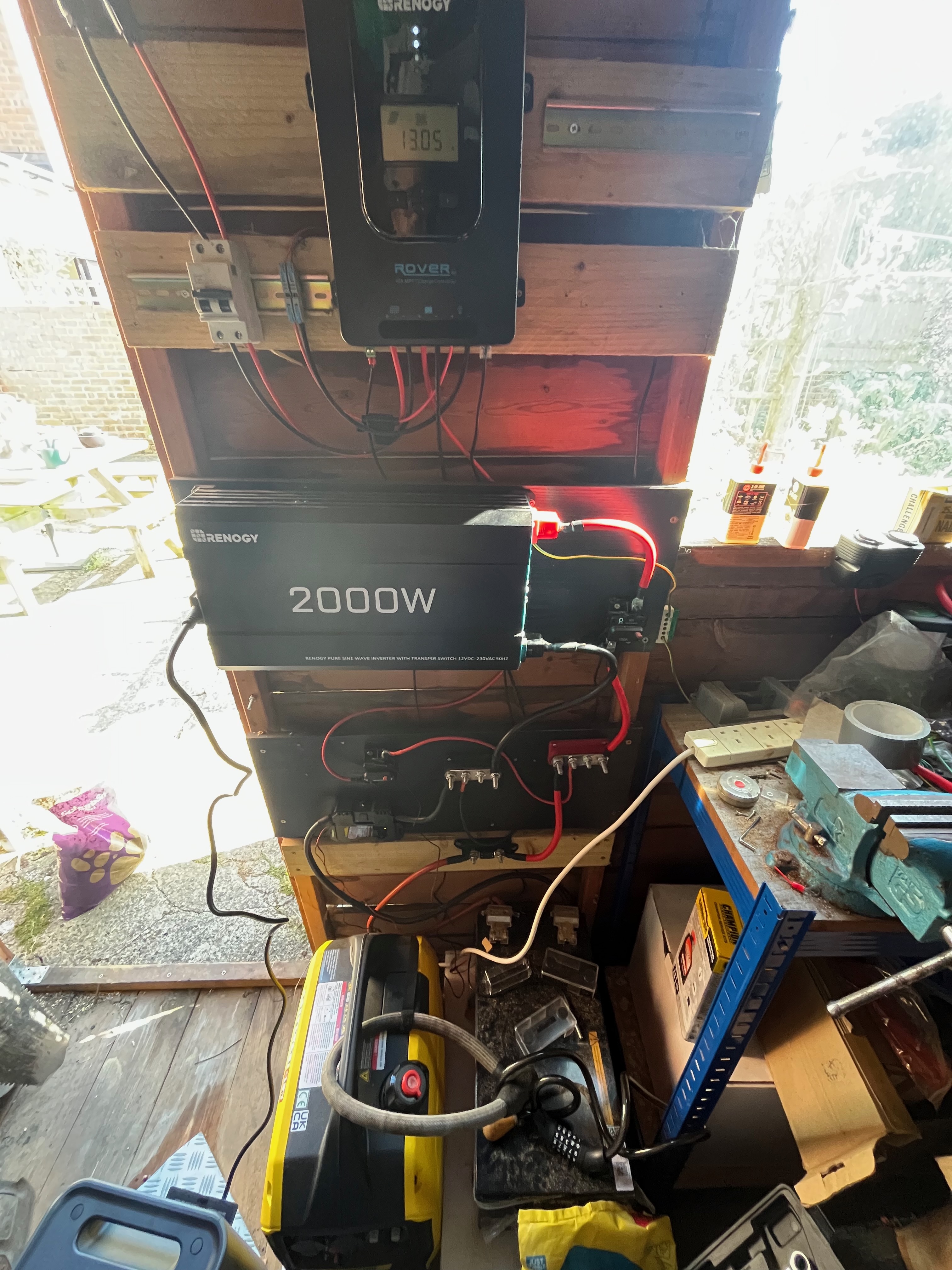

So, I have been stress testing my home solar power rig, following the heat issues due to corroded connectors. Now that everything has been cleaned up etc, am getting much better thermal control. However still have a few bits to solve. To recap, when running it at a 600W load at 12V, I was getting a couple of hot cables (one in particular).
This is the actual rig. Renogy 2Kw inverter, Eco-Worthy 280Ah battery, Renogy Rover 40 Charge controller.
This is the thermal image with no load. Temperature in the is around 19C, as its south facing. The max is coming off off the concrete floor outside.
I than ran it at 600W load at 20 minutes. The 29.8C Max is the cable coming out of the break, on the +ve DC, going into the inverter. However, it is in the sun. But..
I then cranked the load up to 1.2Kw and left it for 15 minutes. The first image is the fuse on the -ve return to the battery. Bit warm, but was stable. The next two are the 150A breaker again. Getting a bit toasty. Ok to touch but definately a bit on the warn side.
So the issue now is that breaker. Reason its causing a problem is that it was cheap, so has stupid little terminal connectors. Need to swap that out for something with a recent surface area - at least M8. The lugs on the cable onto it are M8 and there is slack. However, from a supply perspective, my base load is around 200W. Running it at 600W then I'm now fine. Can even crank it up to 6X my need, and with a few tweaks, should be fine. .
