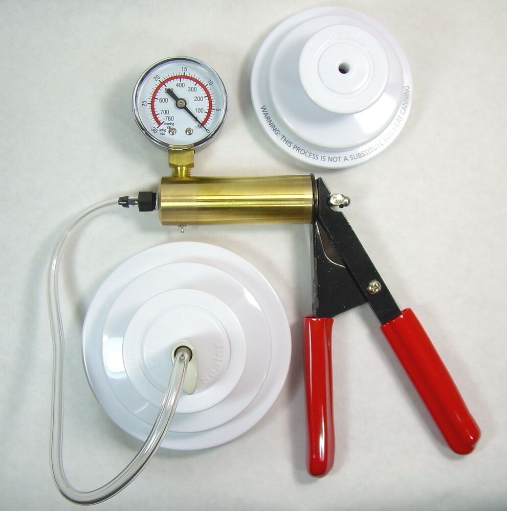

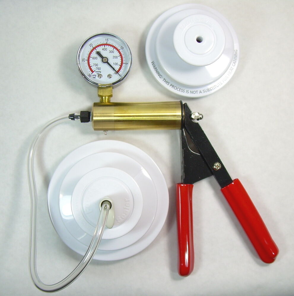

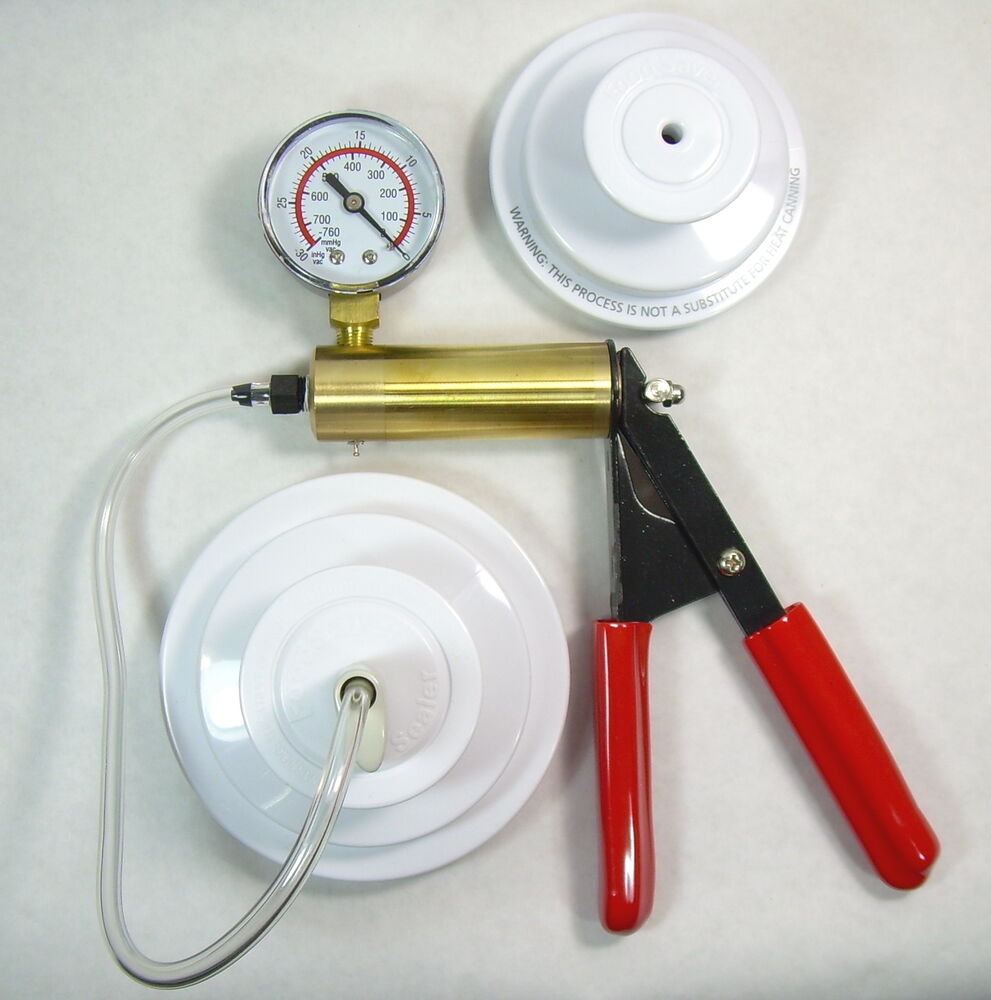

We had been looking to buy a "Food Saver" kit from the US (See pic below) which was about £80 inc shipping, which seemed rather expensive to me.

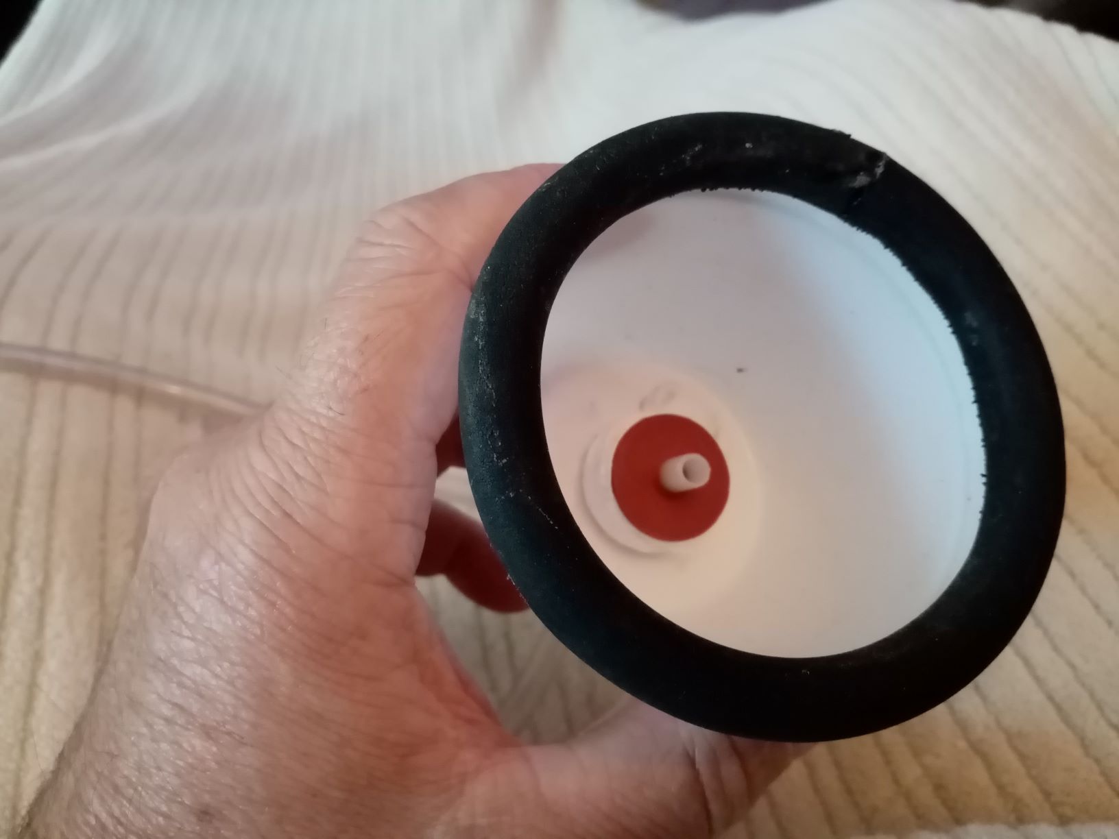

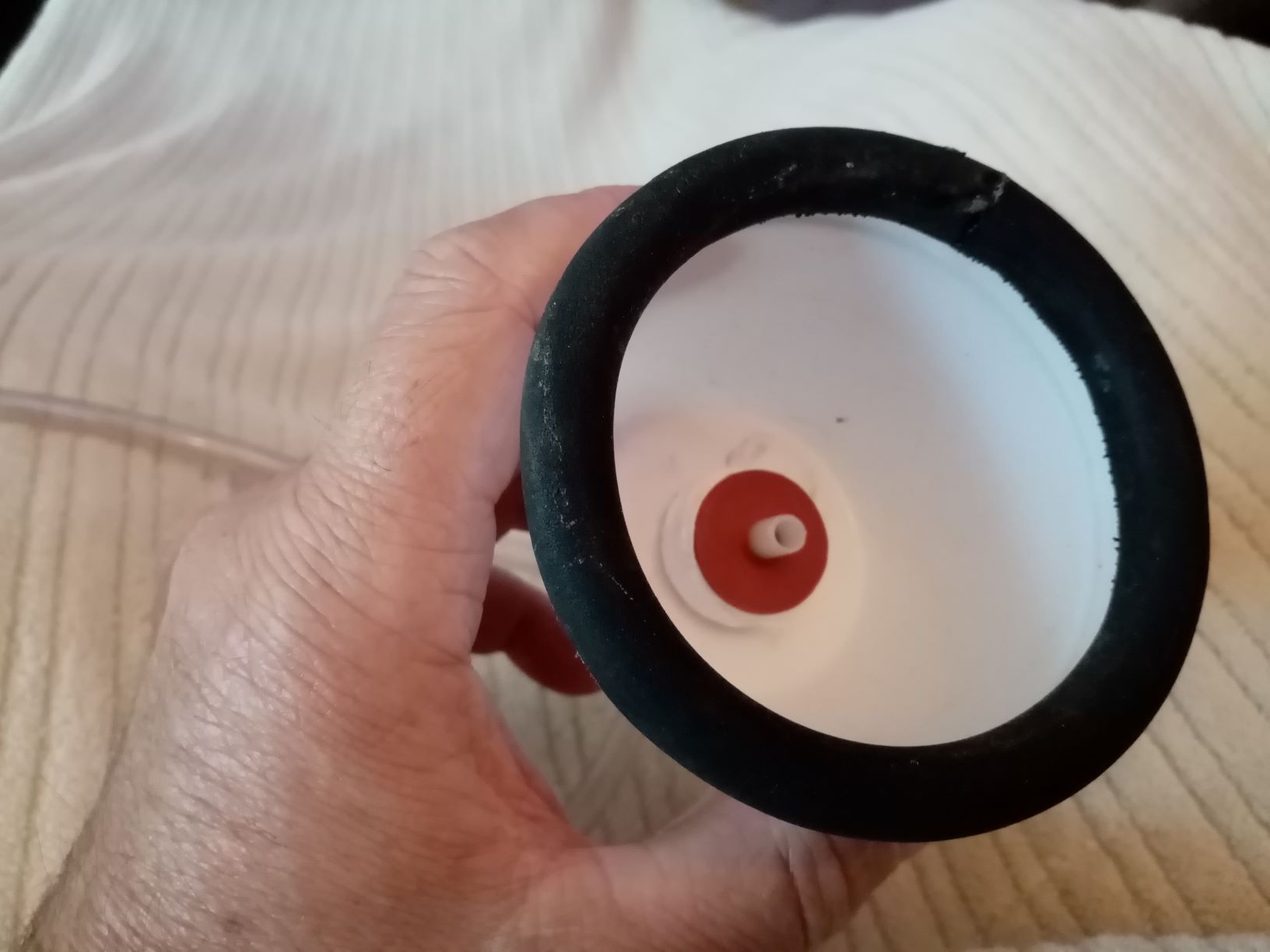

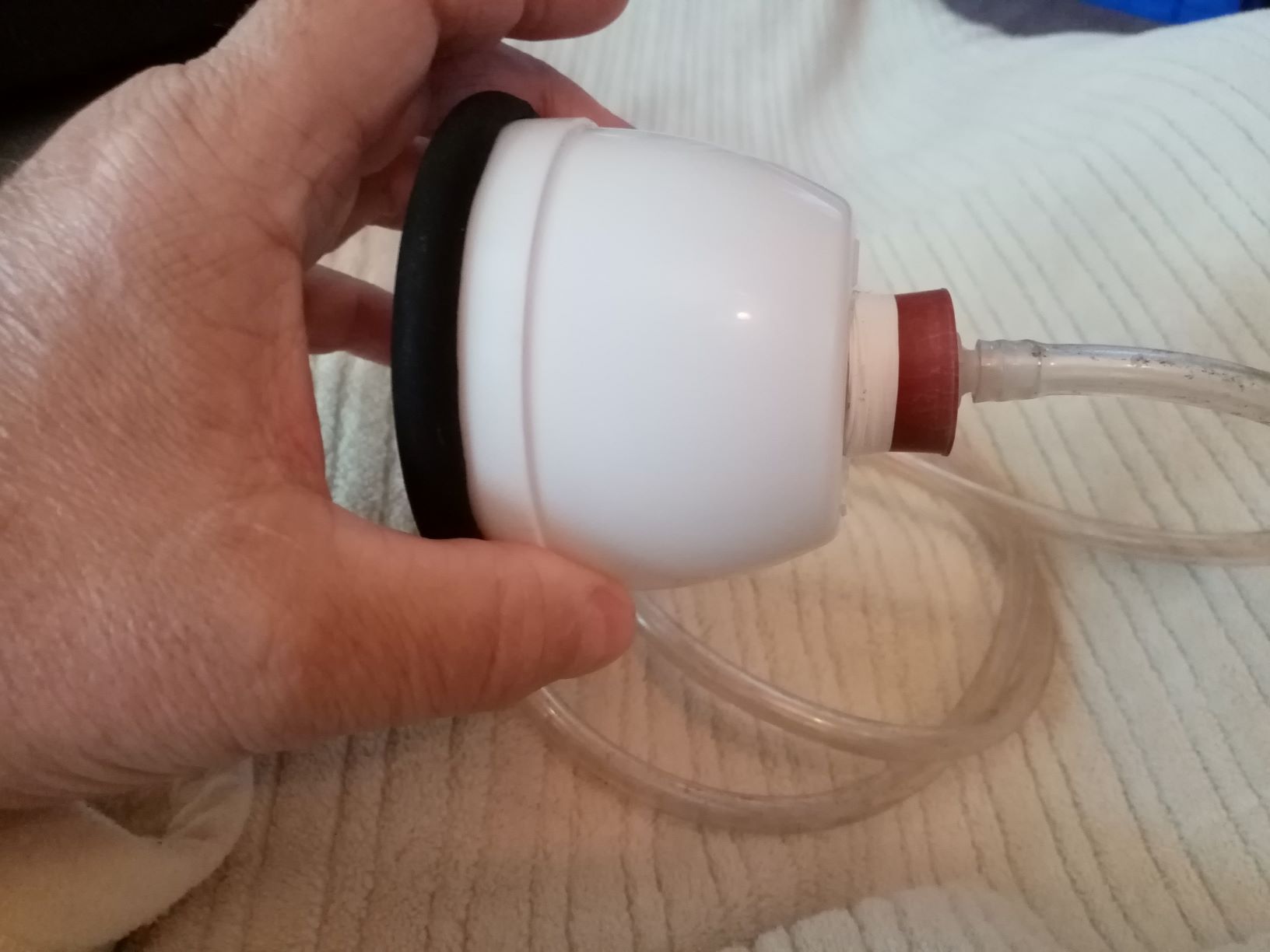

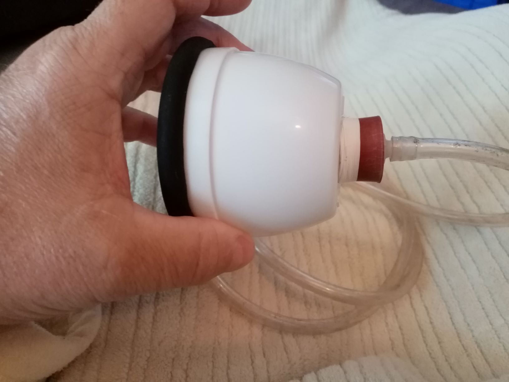

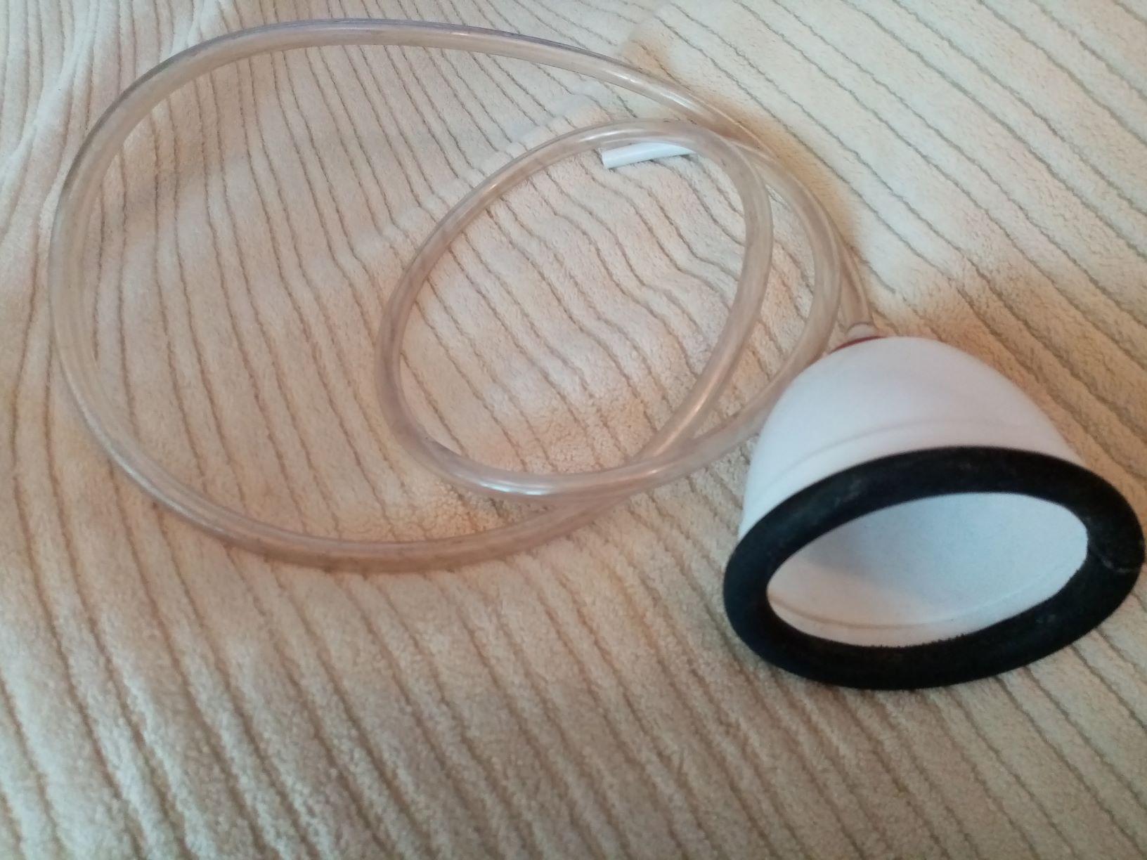

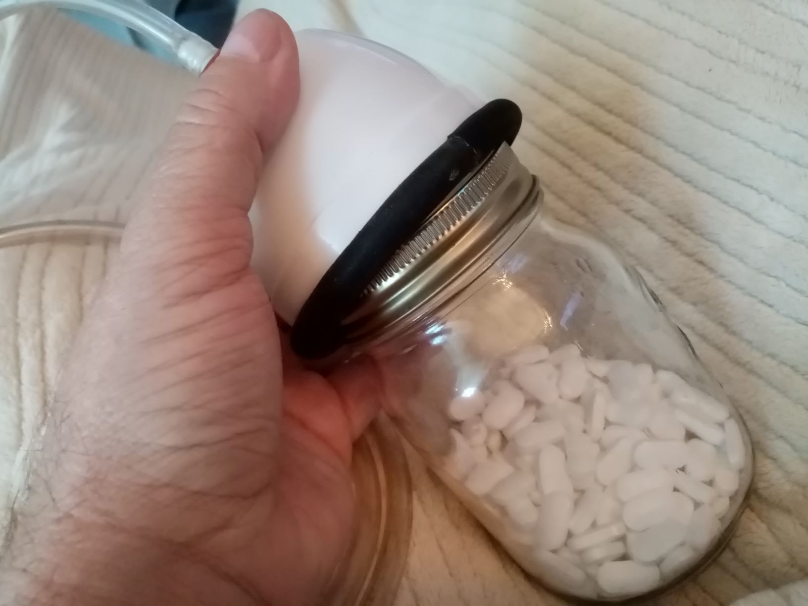

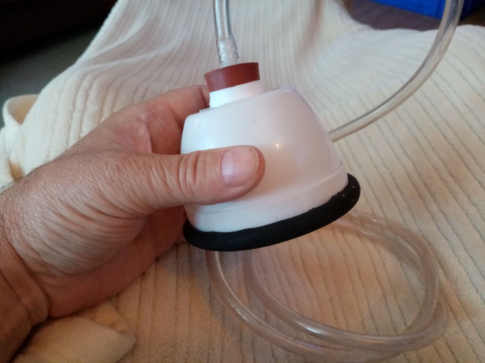

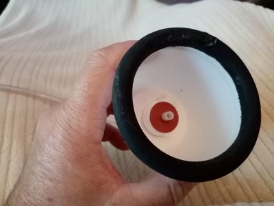

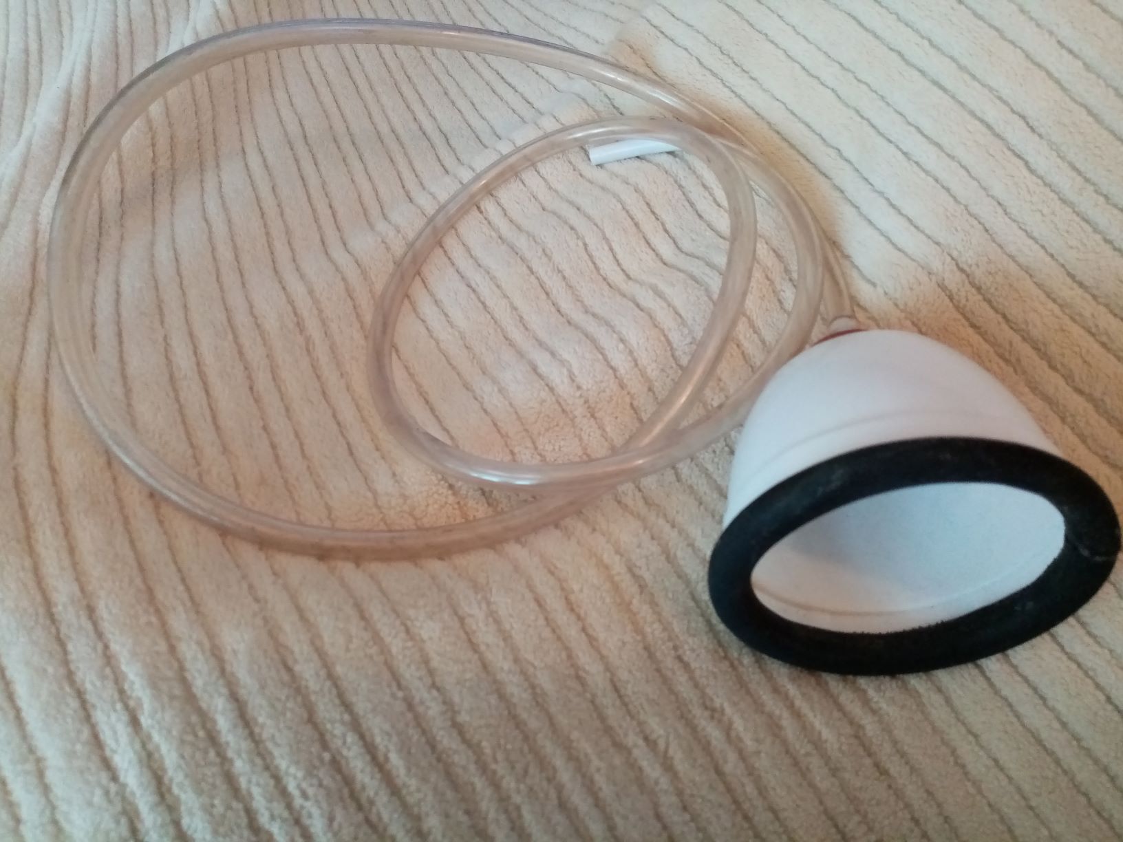

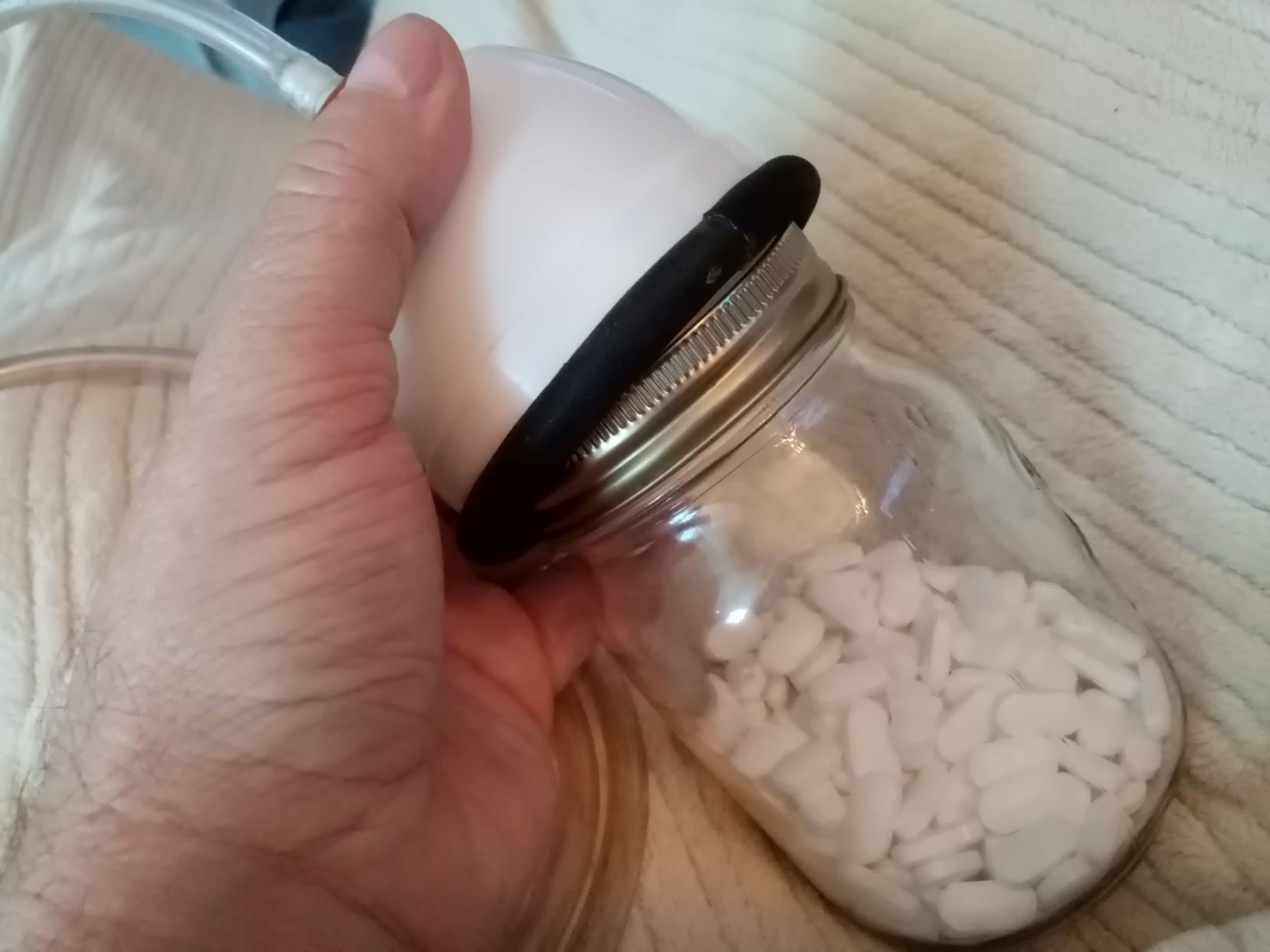

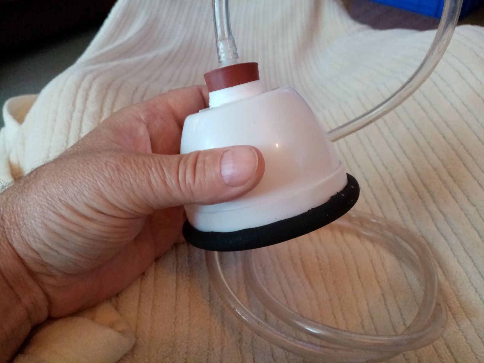

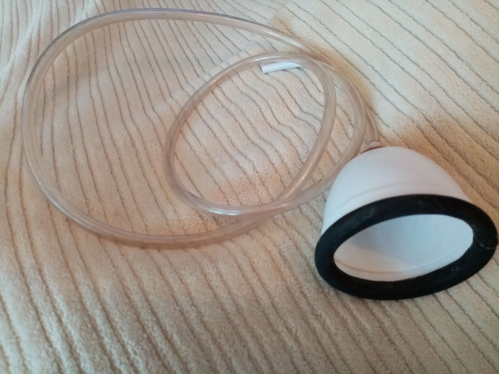

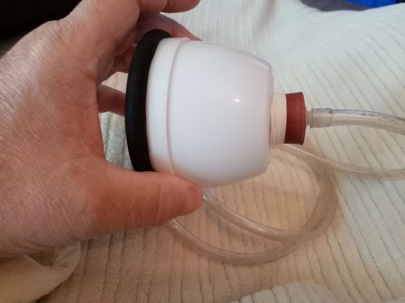

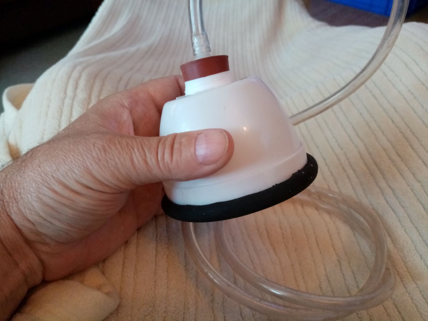

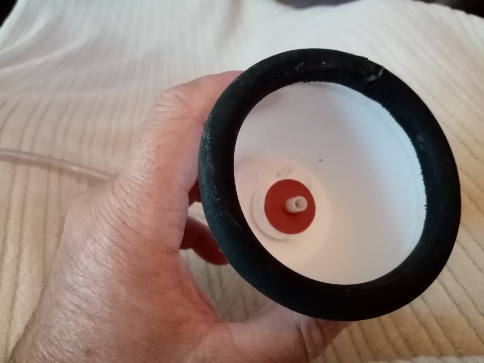

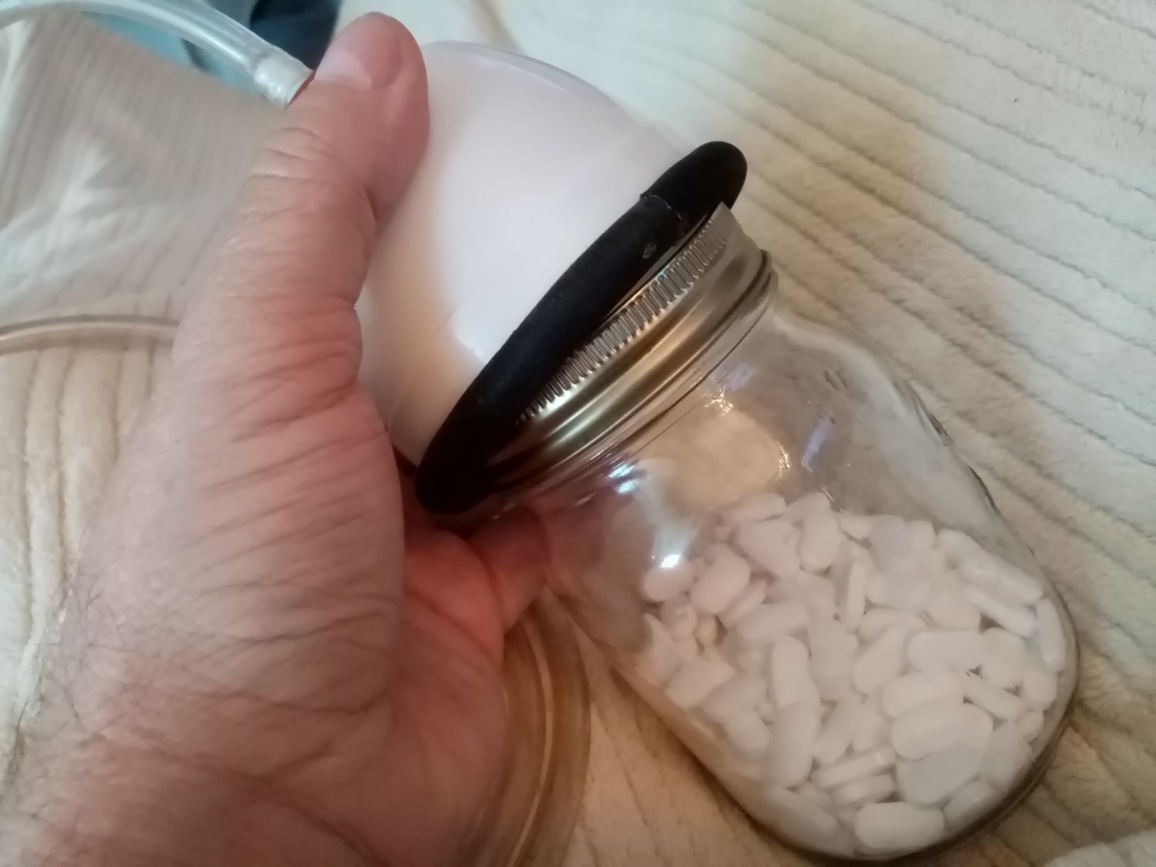

So I made this vacuum set up from old bits and pieces, it connects to the outlet of our vacuum / heat bag sealer machine and it works fine.
The white tub came with a Christmas pudding. The main clear tubing and red cork are standard wine making kit. The black rubber seal (between the glass jar and the white tub) is a piece of hose from an old garden solar water feature.
I used some ptfe tape to seal the red rubber cork in the 25mm hole I had drilled through the white tub and added a small reducer pipe where the clear tube connects to the machine.
It fits the standard 70mm mason jar lids and would you just need a bigger white tub if you wanted it for larger sized jars.

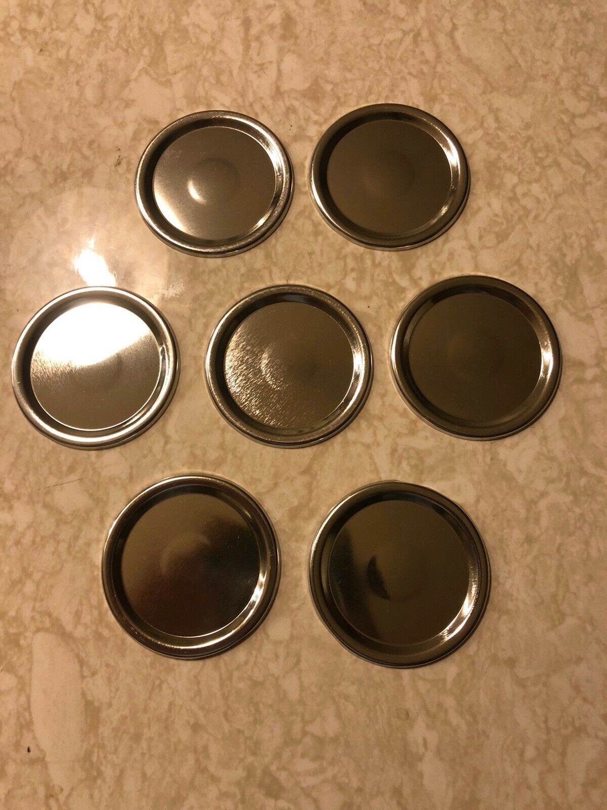

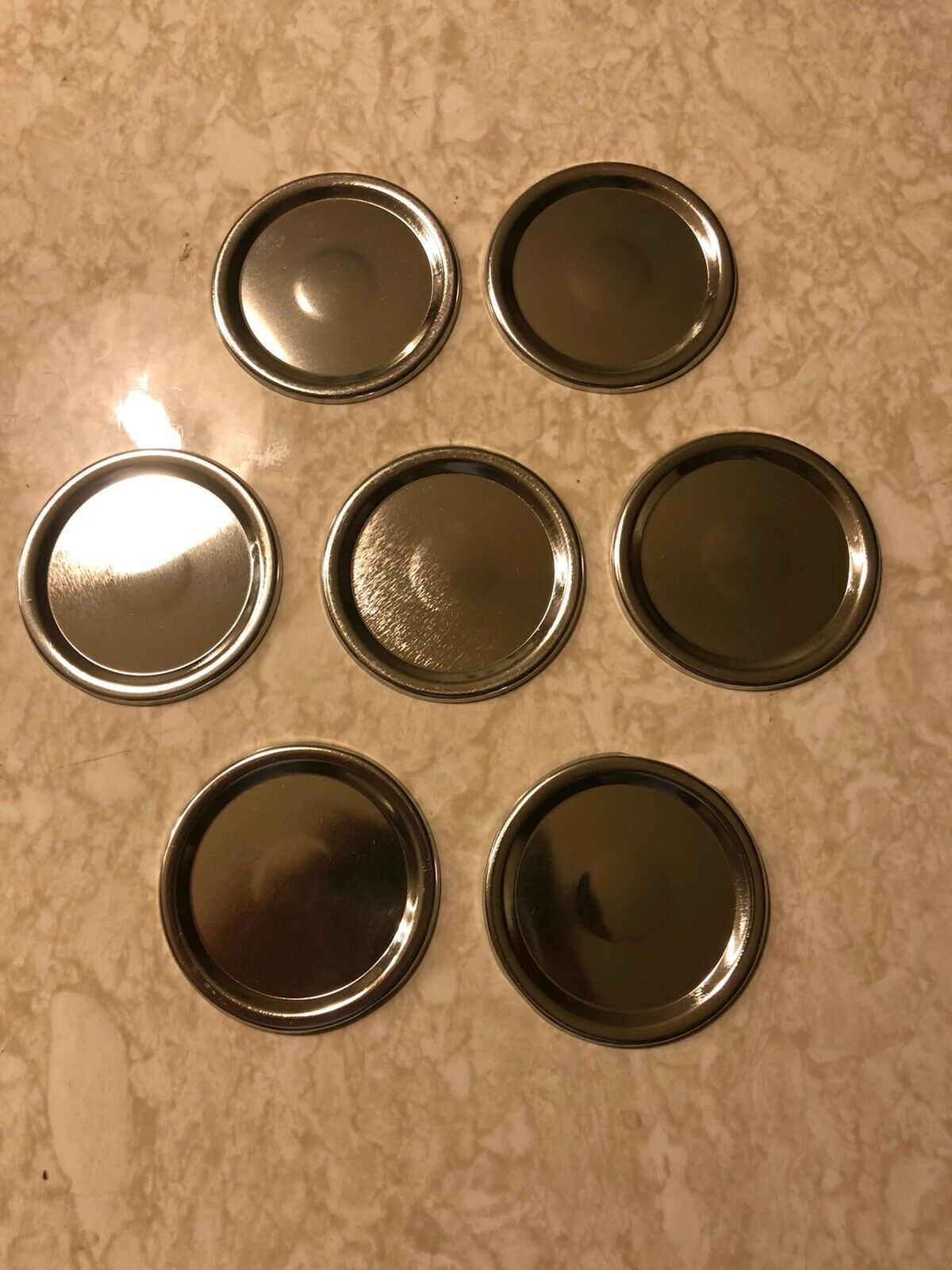

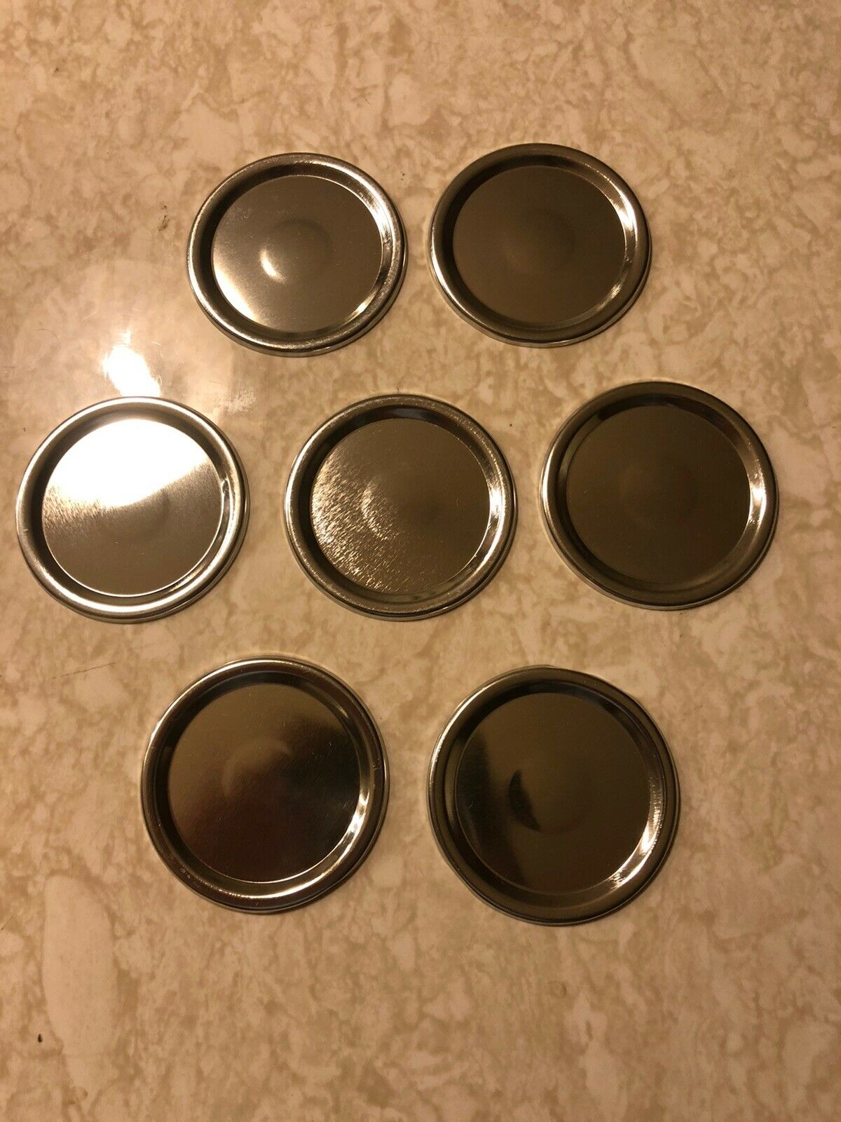

Not strictly to do with dehydrating, but if anyone needs a supplier of replacement mason jar caps, these are good value at about half the usual price £30 for 100. The silicon seal is white rather than the usual red colour but they have worked fine for us over time.

Very cool! Our dehydrator has been quiet. Hopefully if the garden works out well it will be busy in the furure.
