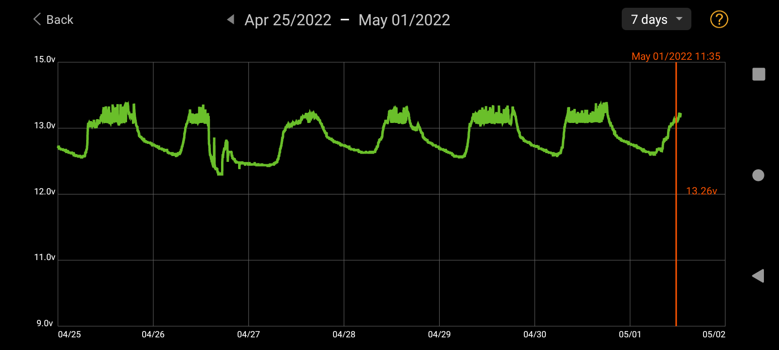

This is the Voltage trace from my pwm charger over the past week 60w of panels . ....
The discharge over night is the CCTV IP camera

Nice chart. What sort of data logger did that? Is there any equipment you don't have :D
Did the data logger prove useful in designing your solar gear or was it just one of the tools of your trade?
