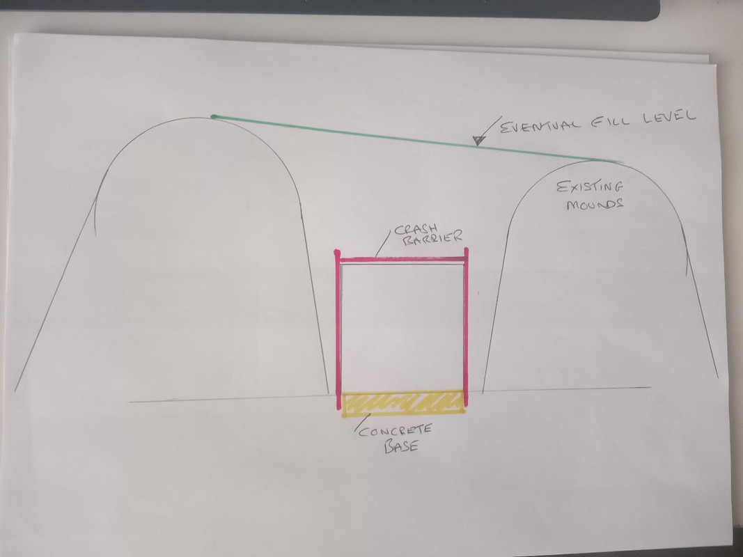

Frnc wrote: ↑Tue Apr 25, 2023 7:42 am This is roughly what I had in mind as a compromise
Hi Frnc
thats pretty close to what i was thinking, the difficulty i see there is the reinforcement drawn in red has no where to finish half way up the wall where there is no strength to lean on it really needs to go up to the top where you have a hard edge which is much much stronger
like this is where i think im heading
This looks like a heck of a lot of weight on top still. I've no idea how much these crash barriers will strengthen it.

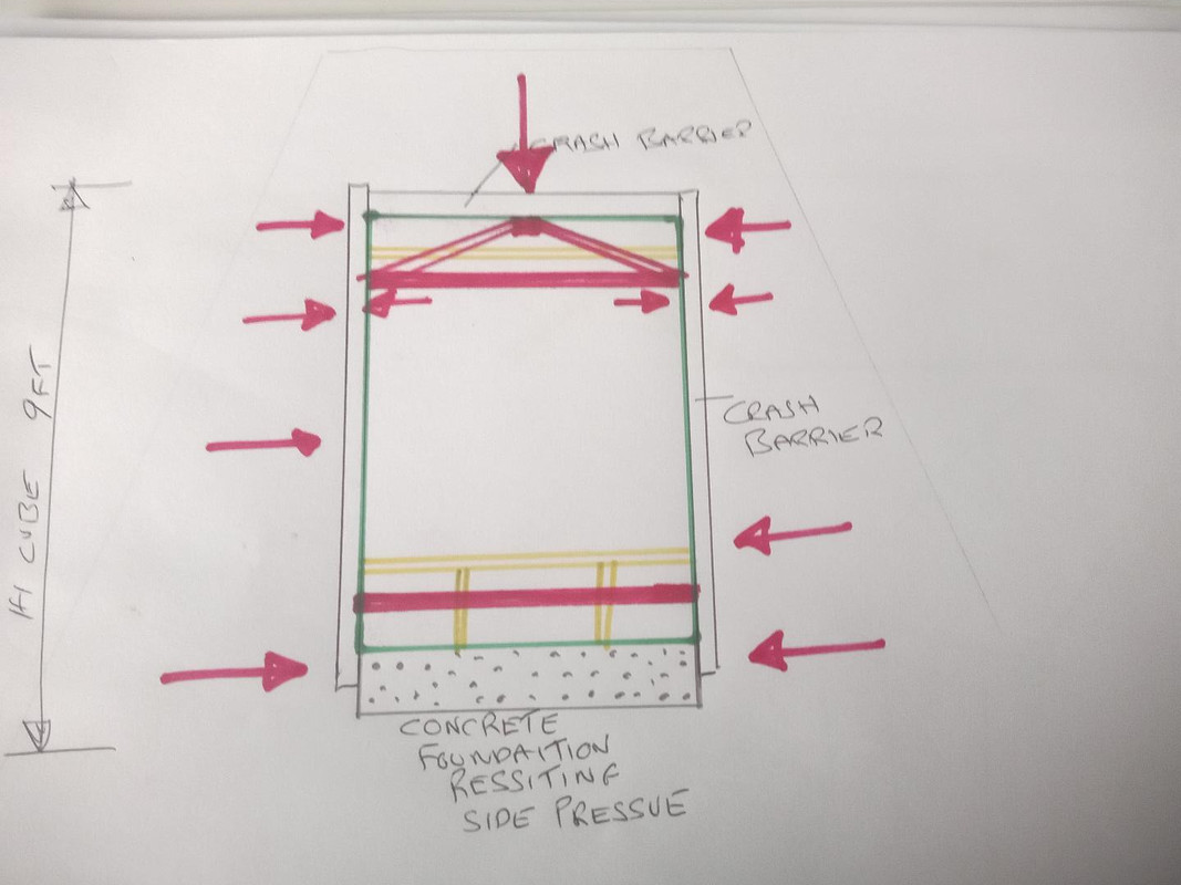

Frnc wrote: ↑Fri Apr 28, 2023 12:25 pm
Baloo wrote: ↑Fri Apr 28, 2023 12:00 pm
Hi Frnc
i agree it does look a lot but my sketches are no where near to scale, i can fiddle with the amount of cover to suit, conventional wisdom suggests you need around 3' of soil to reduce radiation to acceptable levels
I started off with nothing and still have most of it left

i will consult on likely weight on the roof but theres always a work around, i could lower the internal floor and the the ceiling so i have more room above that way i could weld in a centre spine from end to end this could have trusses that come down to the side walls, so the downward pressure from above is trying to push the side walls out resisting the side pressure pushing in and the side pressure is pushing in fighting the down pressure
Posts: 5394
Re: So i want to bury a shipping container
Those 'coat hangers' should take some of the downward pressure. But 3 feet is a lot of weight. Maybe you could start off with less than 3 ft on top, and add some more after a couple of years if it's all ok.
