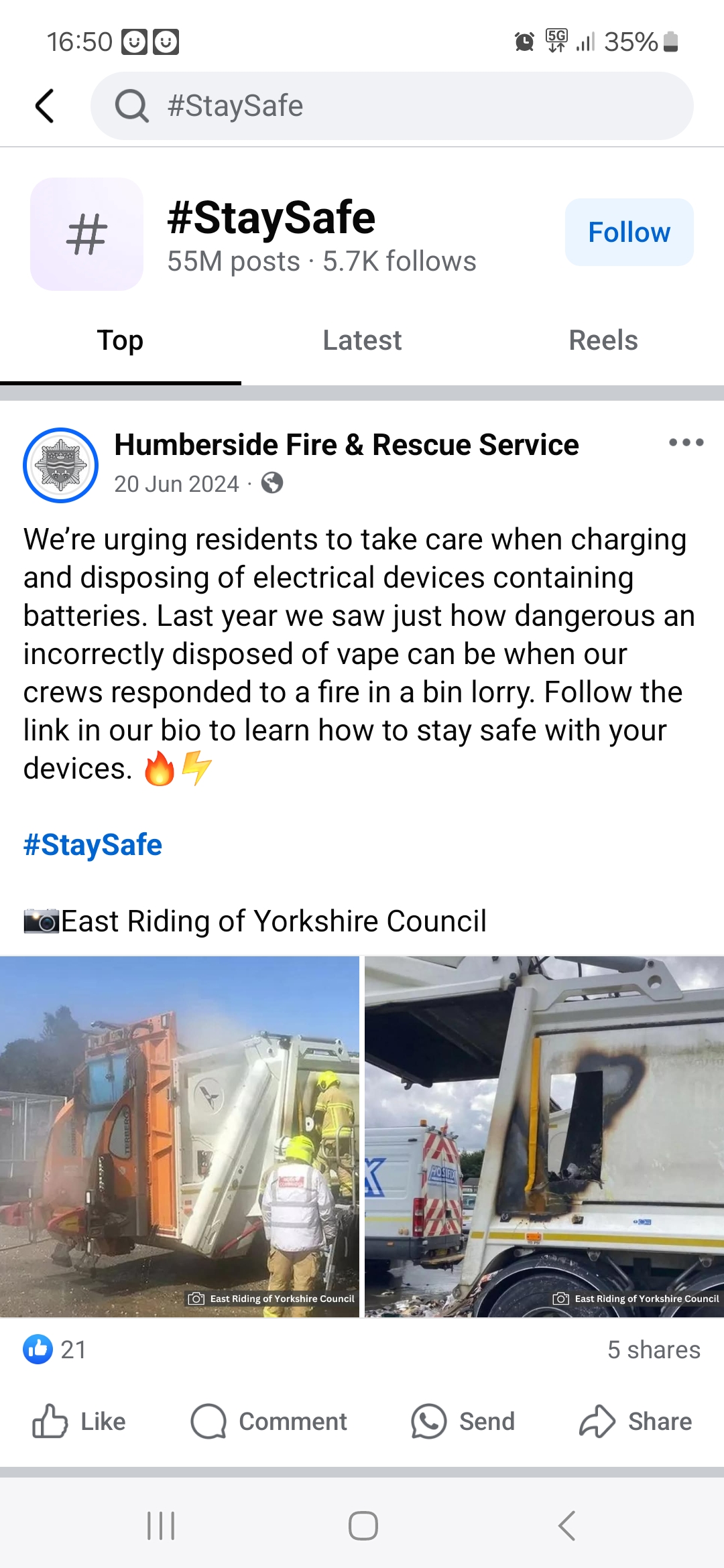

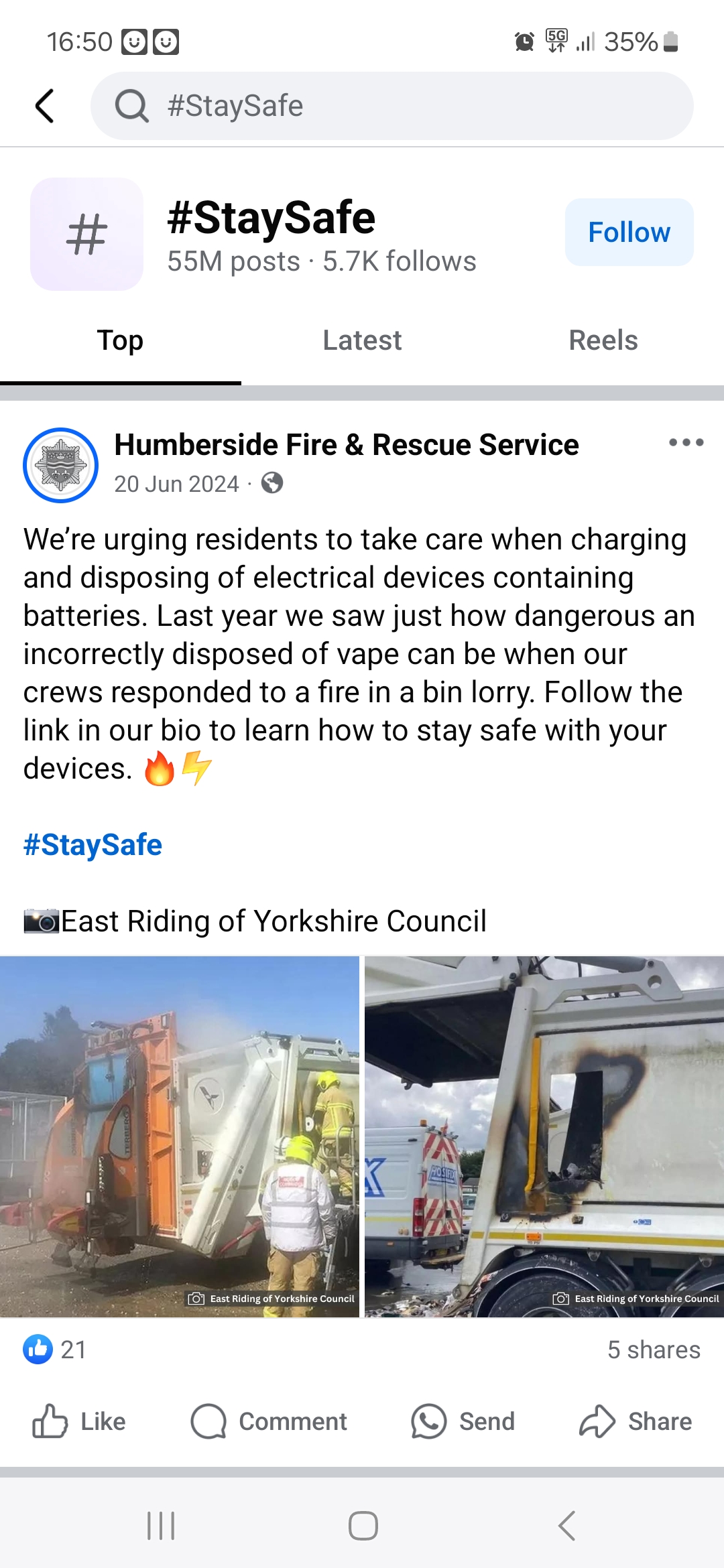

Just took a dozen lithium cells to the council tip you'd think that I'd just walked in with an IED The panic it caused .. they don't want them in the dustbins :lol:

Where did they put them in the end ? :lol:
Don't know about 'over the bridge ' in your part of Yorkshire but my side of the bridge they've closed several tips and refusing to take cannisters lithium cells etc at the ones that remain open ( 4 days a week )
So there's plenty of flying tipping going on or hiding in the general rubbish bins
Obv nothing to do with the local tips closing and opening less days oh and refusal to take them !

Probably chucked them over the hedge at the back of the tip erycc have said to take to the tip so I did :mrgreen:
They have been sat in brine for over a month
Don't want to upset the bin men :mrgreen: one is very good knowing Mrs a has health issues he puts the bin back in our garden for her / us. Got him a pint a few weeks ago in Spoons he told me off :lol:
