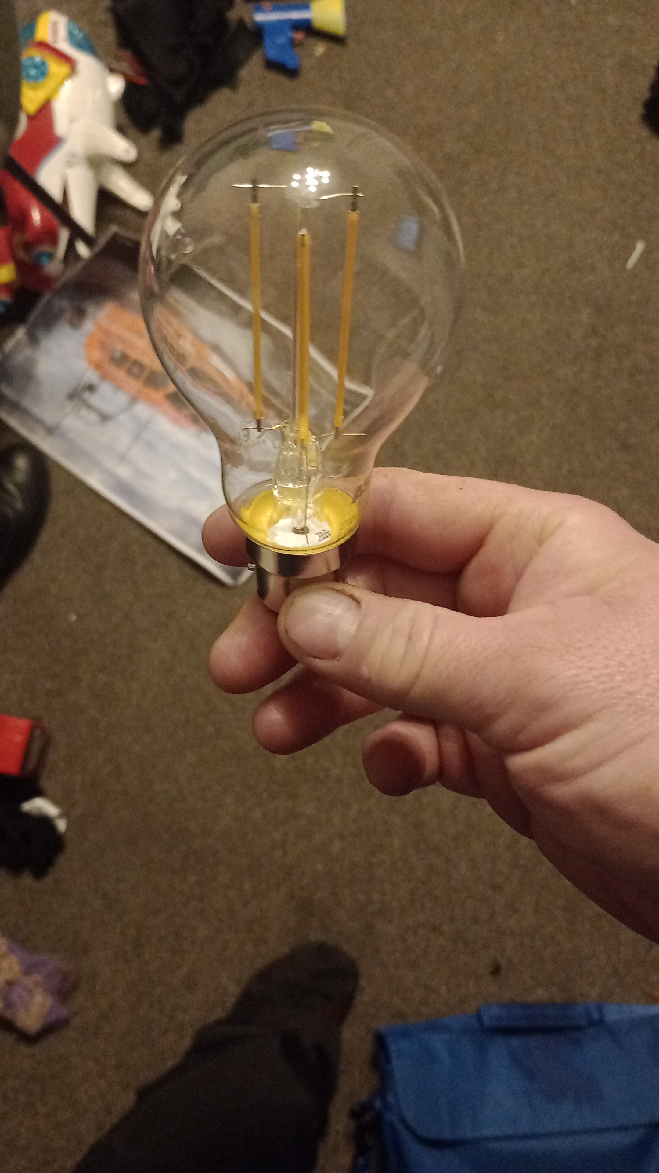

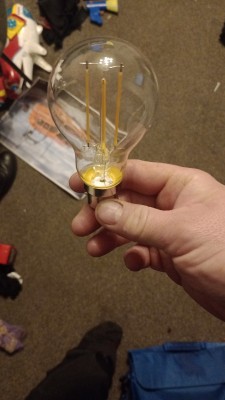

The lamp / bulb decided to go from cool white to warm flickering flame effect .. bog standard led bayonet lamp nothing special.

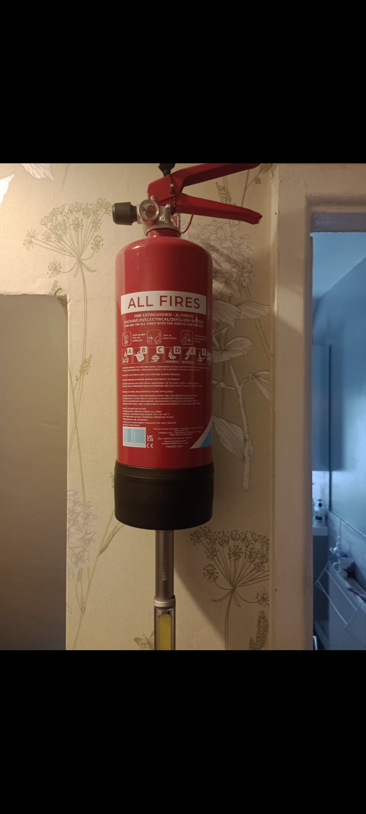

It reinforces the need to keep torches handy I had a magnetic torch attached to the extinguisher sounds daft but it worked ...

Plenty of suitable extinguishers..

And ordered some kit to refill the foam extinguishers on pay day I'm getting some Afff concentrate so I can service my own and refill should shtf I found a small bottle so I can refill the one I used just waiting for the Schrader adapter to come to see if it works
