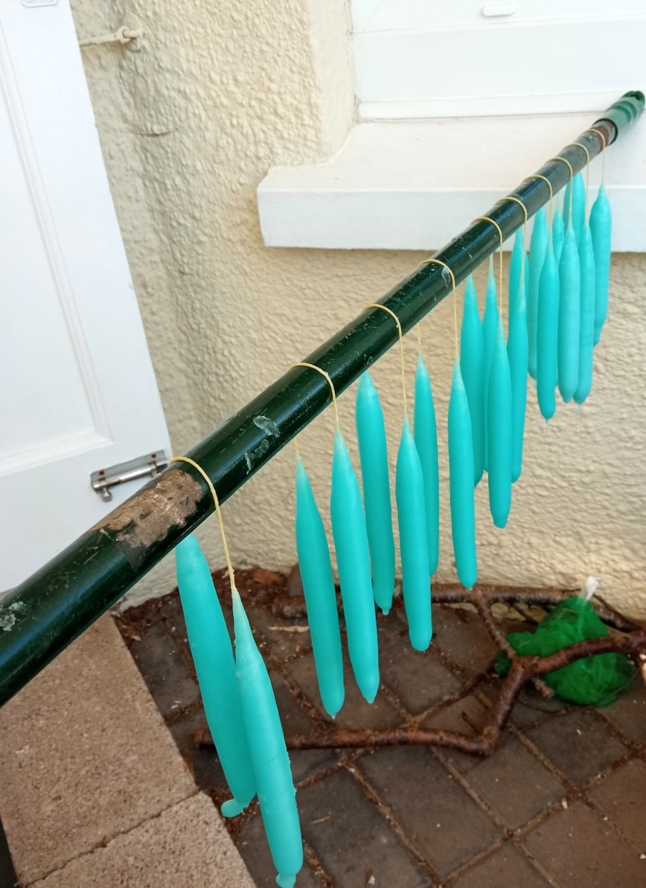

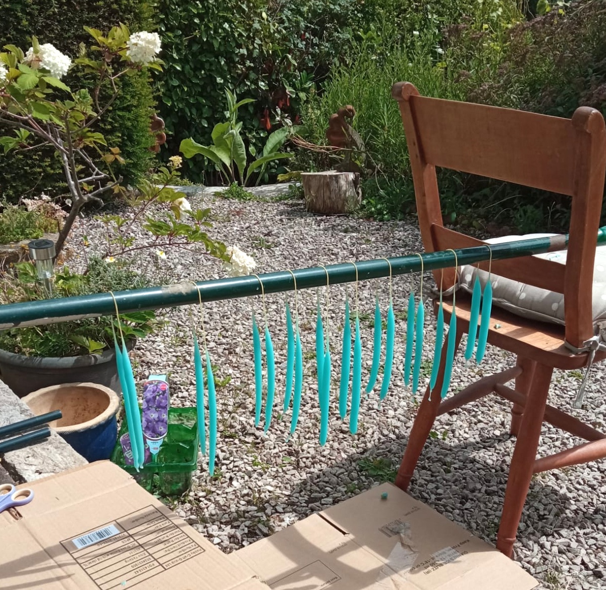

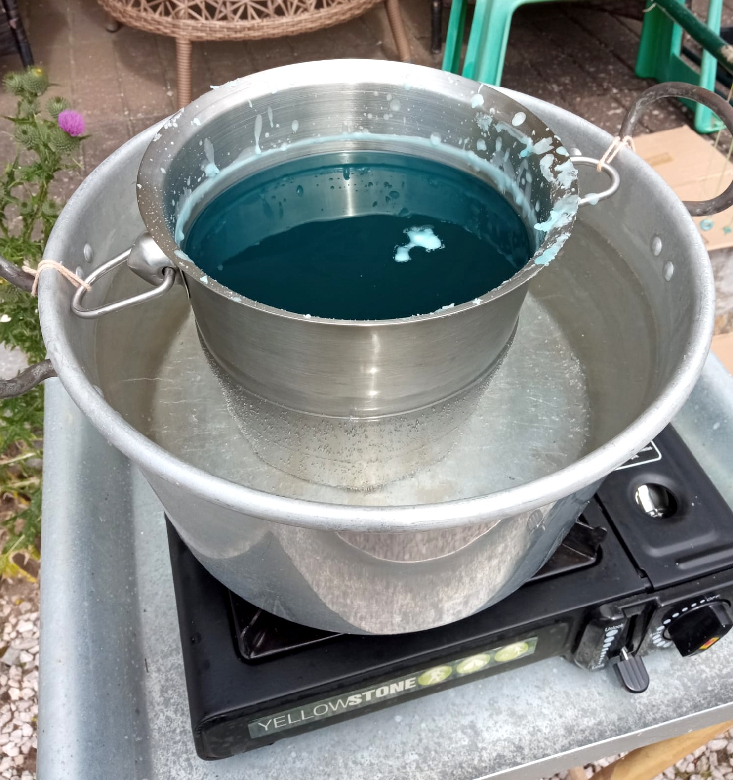

I had a go at making my own candles this year and it proved really successful. I collected old bits of wax (various burnt out candles and a few from the recycling centre shop for pennies etc) bought some wick off ebay and gave dipping my own candles a go. I melted down the wax in a old metal container (using the bain marie method), cut the wicks and dipped away. I couple of hours work and I got around 20 pairs of candles and lots of wax left for more. I tried burning one the other day - 2.5 hours and it was still only half way! That's a few Christmas gifts sorted as well as stock for ourselves!

Those candles are impressive. Well done!

I agree - those candles look great! I’ve never tried candle making but I’ve got plenty of used ‘ends’ sitting in a drawer that could go to good use. Thanks.

First, a quick safety tip:
NEVER MELT WAX OVER DIRECT HEAT, ALWAYS USE A WATER BATH OR DOUBLE BOILER
I've seen a wax fire and they're bad, like napalm filled chip-pan bad.
If you're dipping candles use the widest container you can, this is because the wax level in a narrow container will drop quite fast and you'll end up with parsnip shaped candles ( they burn down really quickly at the start and then get slower and slower)
Play with wick sizes, the thicker the candle the thicker the wick needs to be. If its too thin the wick drowns itself and the candle goes out, but if its too thick the candles will burn down too quickly and the flame will gutter (Originally, wicks were twisted and had to be trimmed to prevent guttering. Modern wick is braided and bends over so the tip of the wick burns away in the air, keeping it at the right length)
The pointy ends can be trimmed off your dips (theres no wick down there) and added to your next melt.
I love the colour you got there Mushroom

Thank you... and all good to know! I think mine must be beginners luck, as the one I have burned so far was great, no guttering and lasted between 4-5 hours!ForgeCorvus wrote: ↑Fri Nov 29, 2024 9:13 pm Welcome back Mushroom.

I weighted the lengths of wick using a little metal nut tied on the bottom! That meant they came out straight when fist dipped, not wonky! Then snipped the nut off the bottom after dipping!
