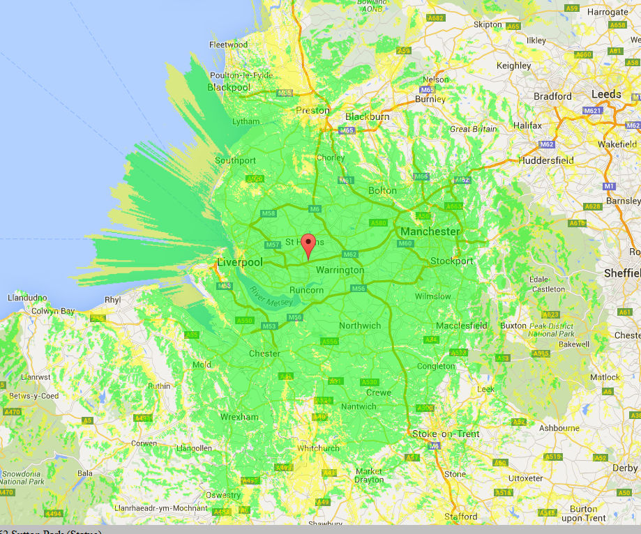

Attached is a computer generated estimate for 2M coverage from a high point on the M62 between Liverpool and Manchester. From that point I reached N Wales 40 km away using 5 Watt handheld but with a car roof antenna. On the other hand I can struggle to reach across the town where I live.
