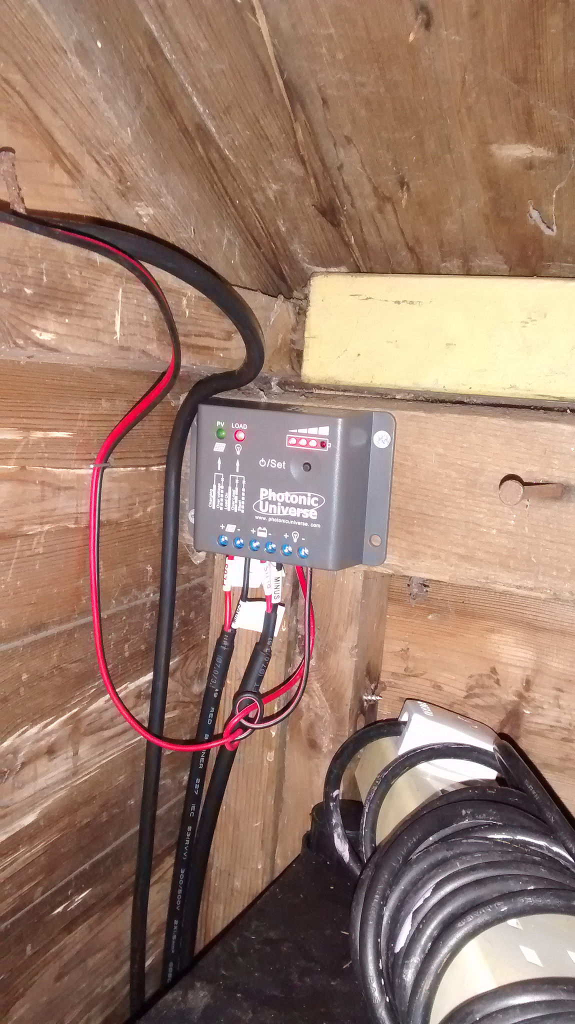

Upgraded my sheds 12v system and doubled the original 30w solar unit to 60w by slapping another 30w panel on the roof and linked it to the charge controller .... Bingo 100% increase in charging looking at 4a on a bright day will be getting the clamp meter out and see what it's shoving out when I get chance..
Biggest pita was getting the 2 cables into the piddly little screw terminals on the controller which is screwed in the most awkward corner to get at in my shed ... (Intentional so I can kill the output side ergo the lights to make it hard for any scrotes who break in to see what they are about to fall over )
Pic from old shed
The system is now as big as I can make it without replacing the control unit
Pic from old shed

I followed your links there Yorkshire Andy,and bookmarked them! Forgive my ignorance please; I assume that you charge a 12v battery.Is that a car battery,or leisure battery? If so ,you would have to use a step-up transformer to power 240v equipment?
What are your applications for this set-up,if you don't mind me asking? I can see this as a superb alternative to a noisy generator in a powercut.

jansman wrote: ↑Sun May 27, 2018 6:15 am I followed your links there Yorkshire Andy,and bookmarked them! Forgive my ignorance please; I assume that you charge a 12v battery.Is that a car battery,or leisure battery? If so ,you would have to use a step-up transformer to power 240v equipment?
I am no technology expert,and do everything on a need-to-know basis.Heaven knows I have wrestled with the computer system at work!
Yes it's a 12v 110ah deep cycle leisure bettery ( better than a car battery for this application
http://batteryuniversity.com/learn/arti ... _batteries
To step up I use a pure sine wave Inverter which gives as close to mains type power so is safe on delicate bits and bobs eg phones / computers
My application is primarily power and lighting in my shed with the added back up power recourse if needed it will run most small appliances TV / radio / strimmer / lamp stand / telephone (upto 300w )
I prefer to use the 12v outlet and run 12v adaptors such as car chargers for phones etc as it's more efficient
It's other big use is using a 12v powered batter charger to charge AAA and AA batteries for torches etc
A generator has its place (my small system won't run a fridge (due to the power needed at start up ) for example
Instead of trying to run the fridge, I'm looking at a 12v coolbox.

They draw about 60w so a 110 ah battery run to 50% dod. (depth of discharge take them below 50% capacity you drastically reduced their life)
So
60w/12v = 5a
So assuming no loss
A 110 ah battery gives 55ah useable power
So 55a ÷ 5a load = fridge
Will give 11 Hours run time. .
As for charging assuming good conditions your looking at needing a 10a charge (run fridge during the day and top the battery back up so about a 200w panel and charge regulator...
Best short / longer term is a 3 way fridge..
